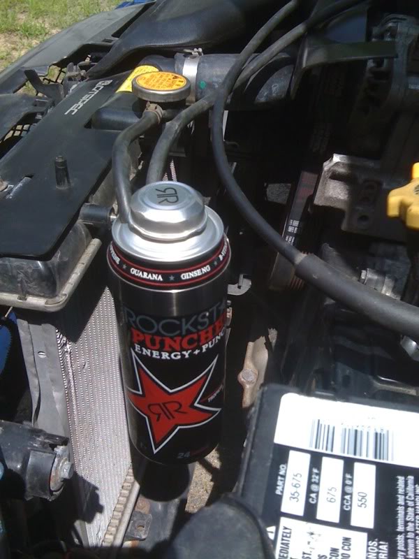

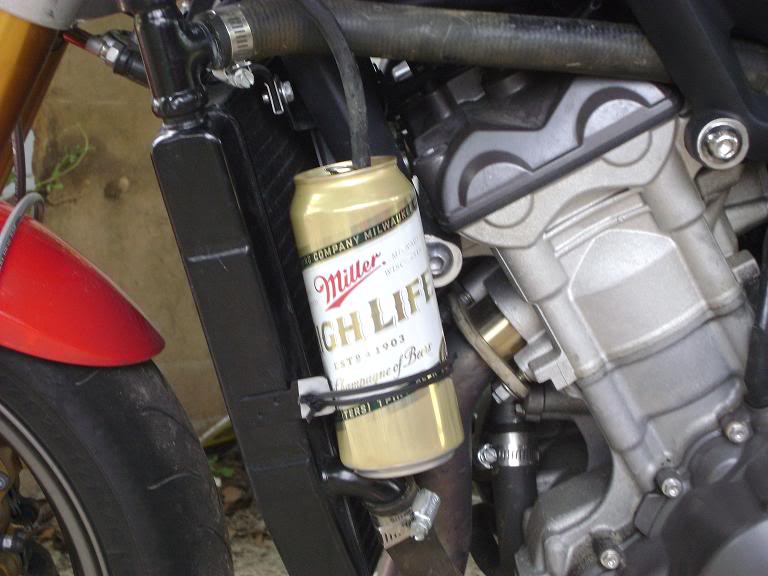

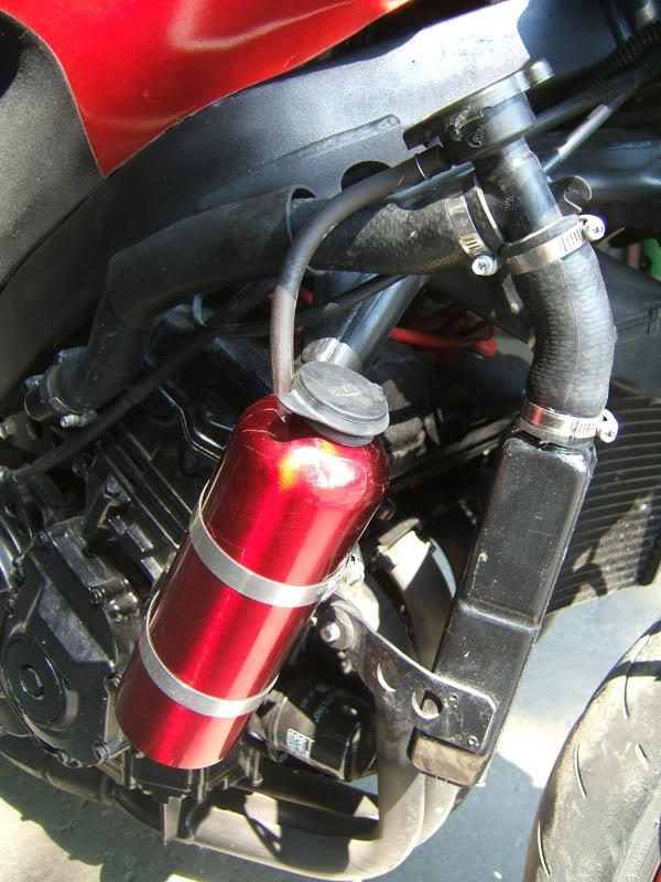

Leadfoot Posted January 23, 2014 Report Posted January 23, 2014 ...Even a plastic peanut butter jar, with a hole for the hose to pass through, and a small hole for venting would work, at least temporarily...or perhaps a ketchup bottle? "It's what cooling systems want, It's got electrolytes" [ATTACH=CONFIG]14950[/ATTACH][ATTACH=CONFIG]14952[/ATTACH][ATTACH=CONFIG]14953[/ATTACH] These guys beat me to it. Being in the offroad world where chopping things, swapping bigger engines, etc many people just use another item for an overflow. There are even some nice looking universal ones on hot rod sites for pretty cheap. Quote
