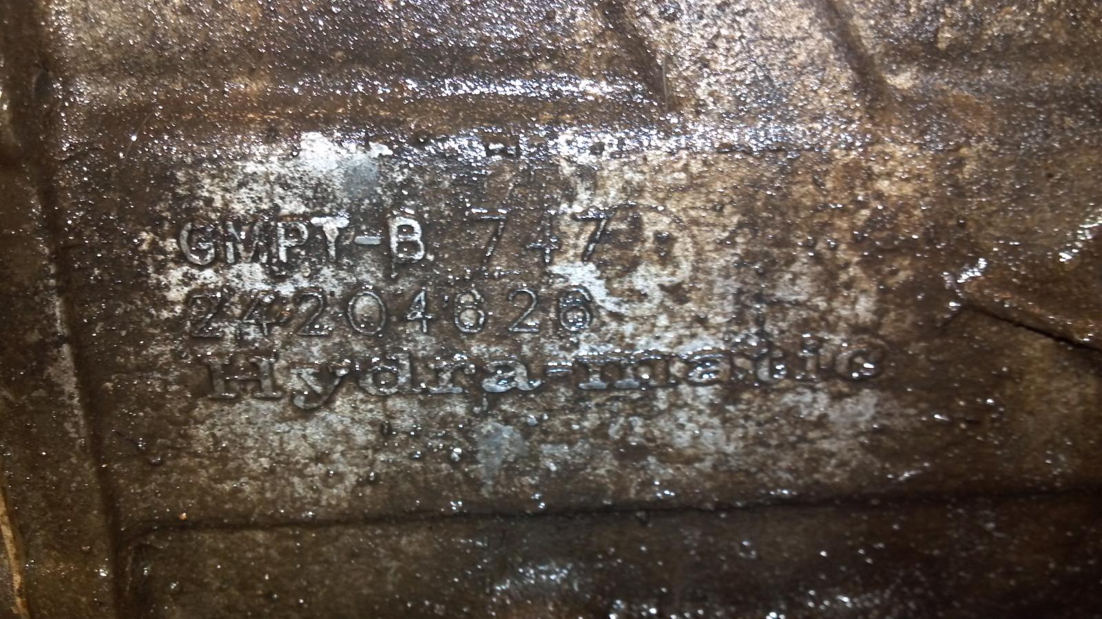

Pitts Posted January 14, 2014 Report Posted January 14, 2014 Tried searching with no luck. Anyone know the difference between the 4T60E's with the bell housing stamped 744 on one and 747 on the other. The reason I'm wondering is because I've got a 95 GP that has 744 stamped on the bell housing located under the throttle body and my parts car as a 747 stamped on the bell housing. I've talked to a few friends and they don't know what the difference is or would be. Quote

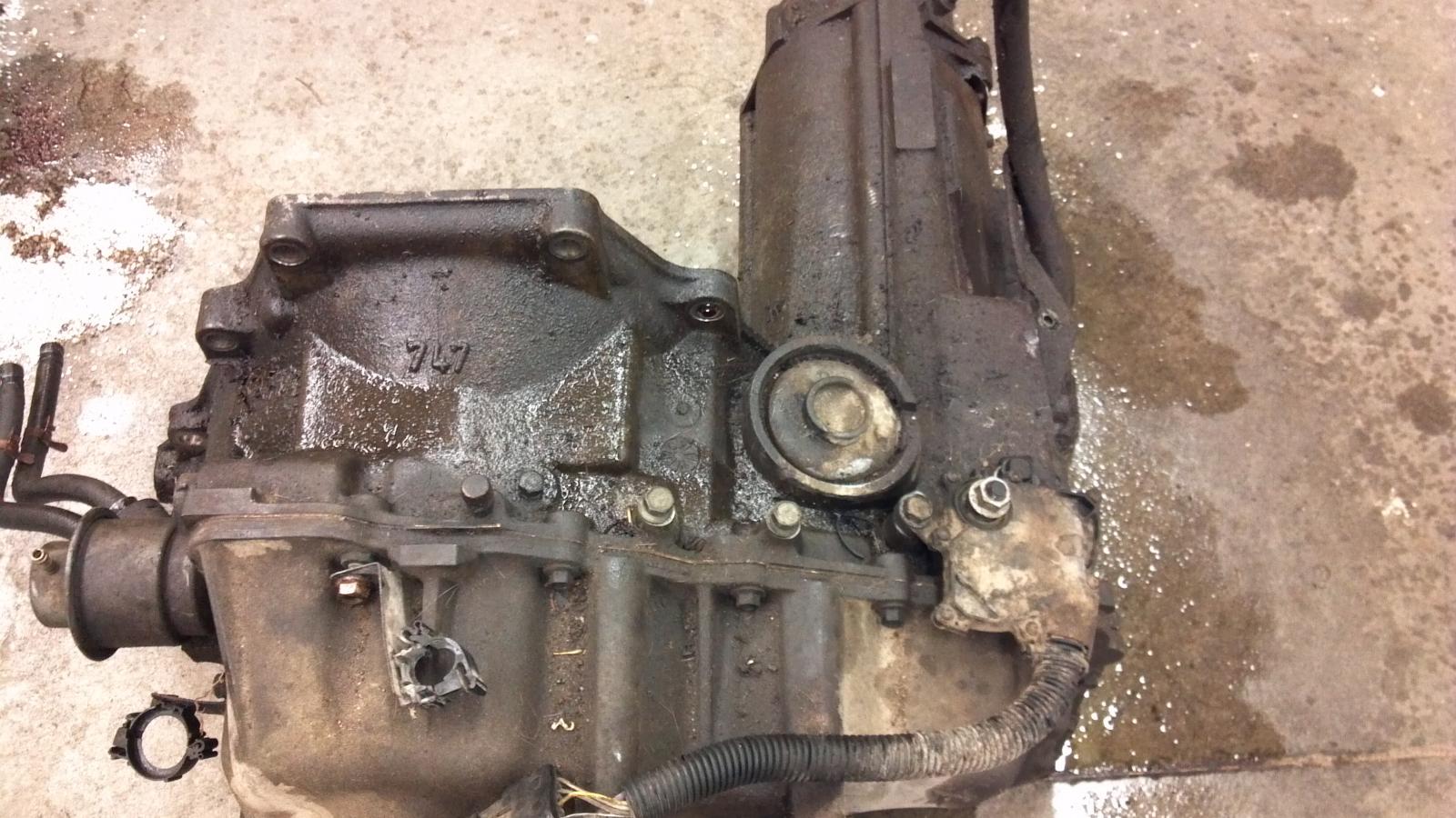

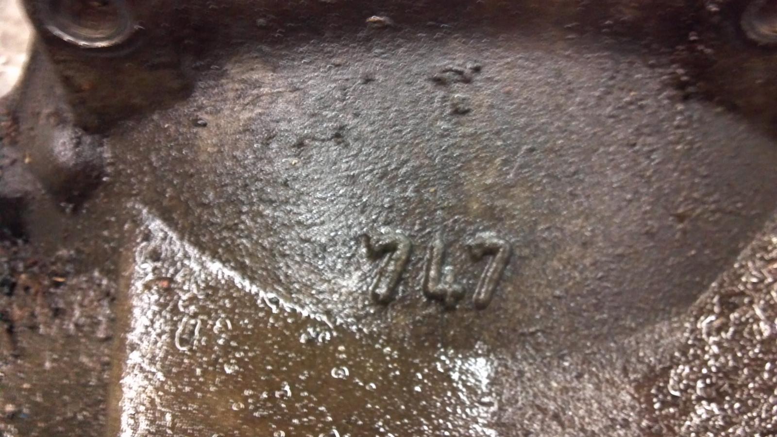

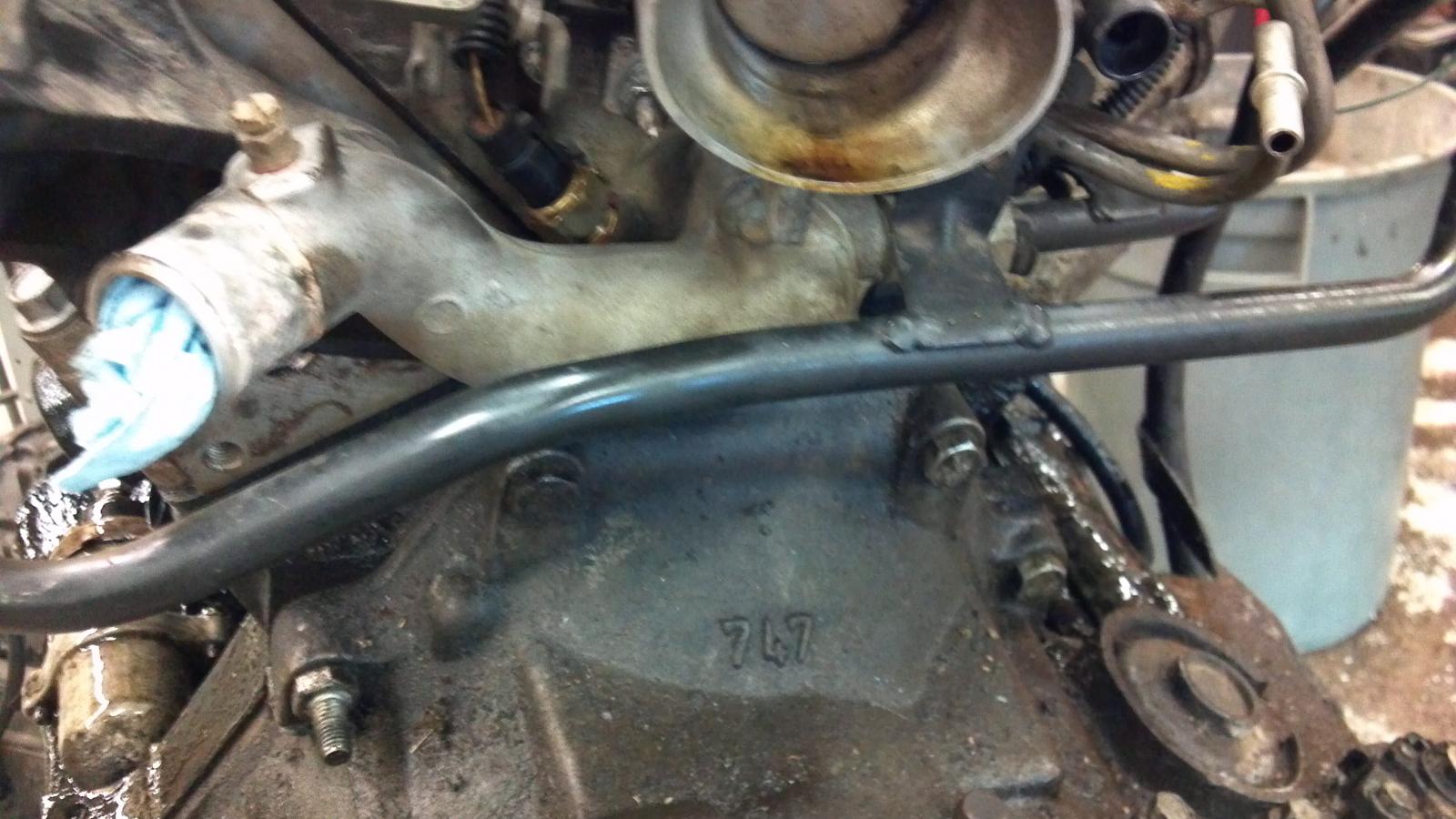

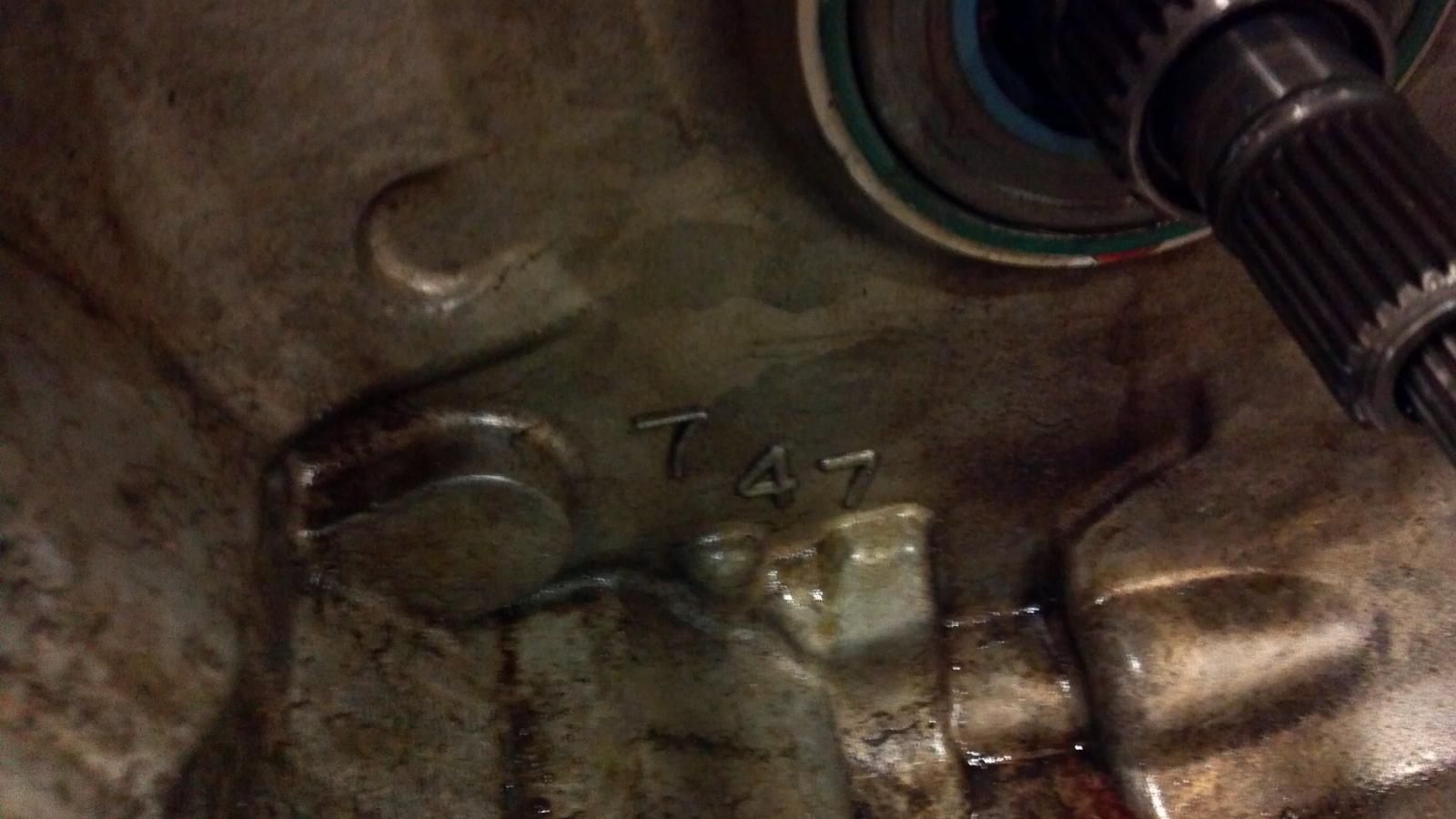

Pitts Posted January 15, 2014 Author Report Posted January 15, 2014 747 [ATTACH=CONFIG]14810[/ATTACH] Quote

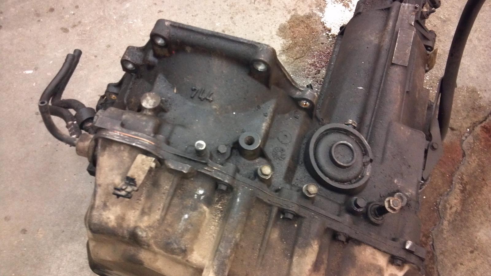

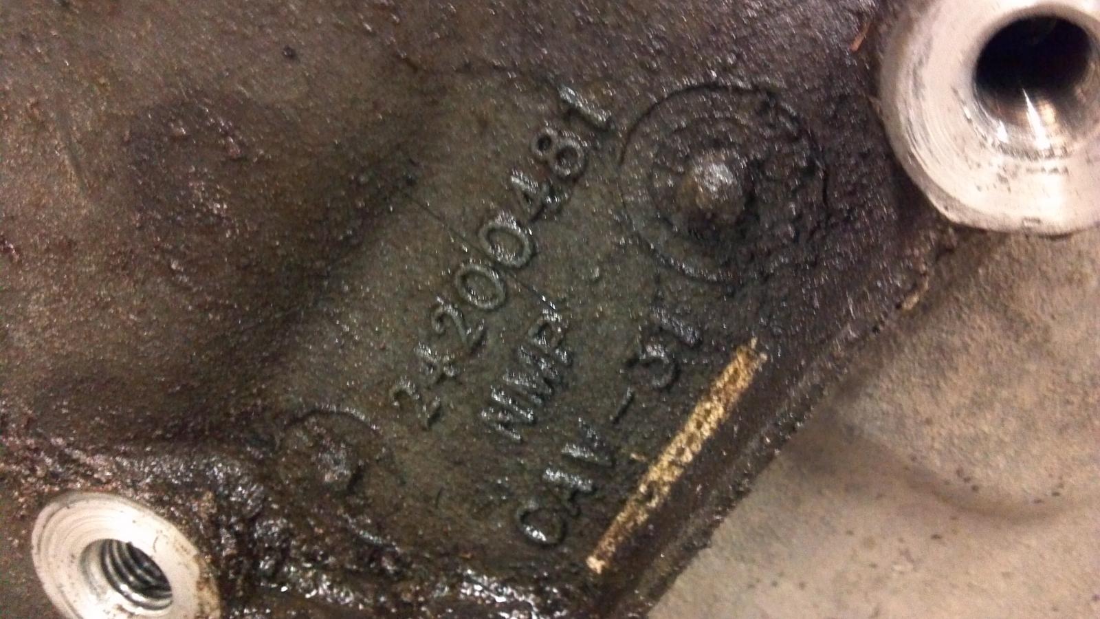

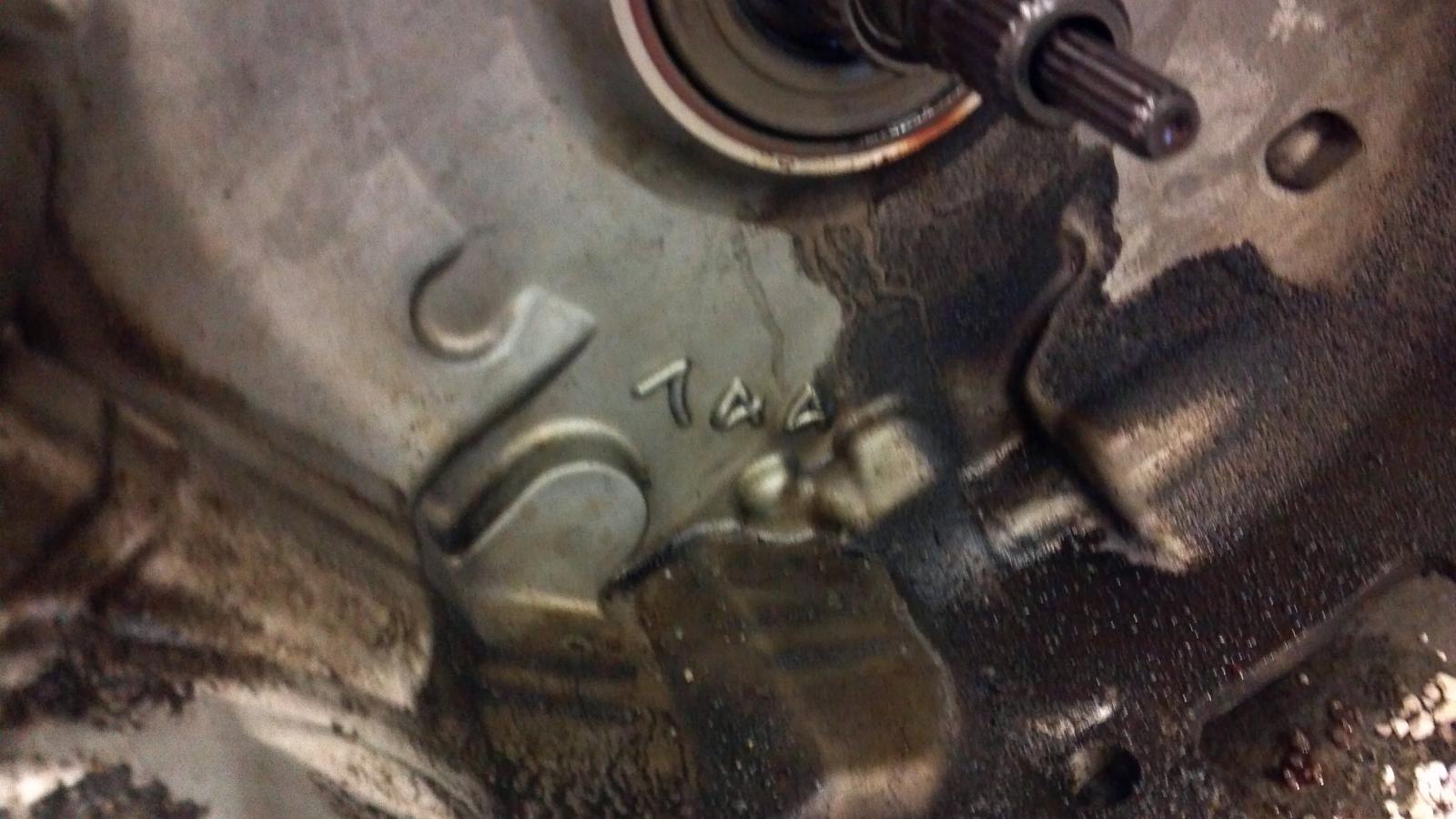

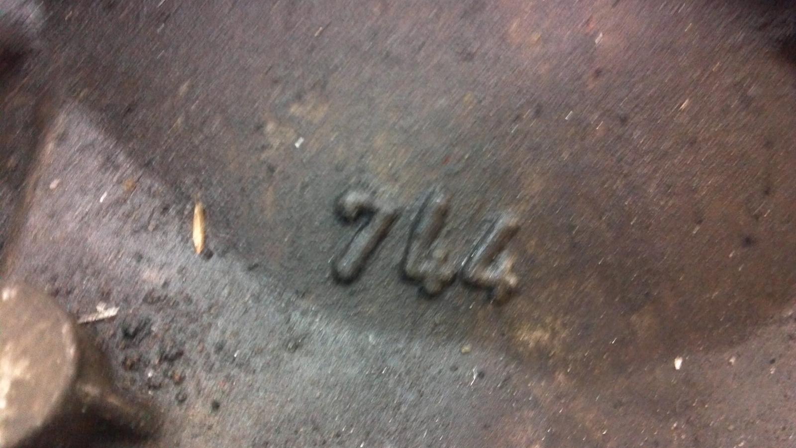

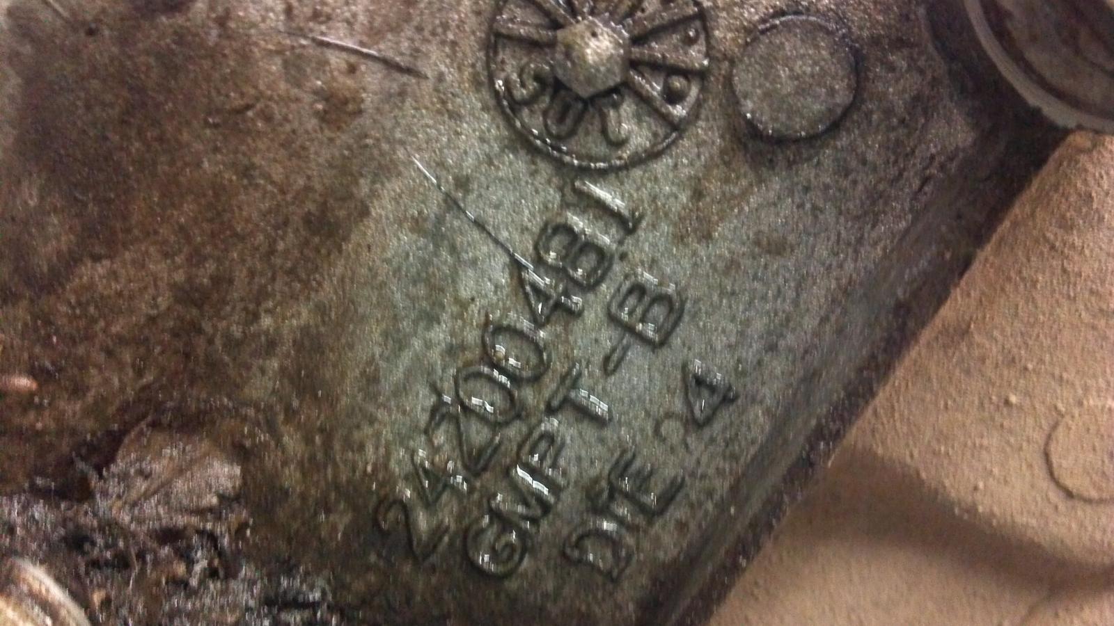

l67ss Posted January 15, 2014 Report Posted January 15, 2014 That thang iz nayasty! 744[ATTACH=CONFIG]14804[/ATTACH][ATTACH=CONFIG]14805[/ATTACH][ATTACH=CONFIG]14806[/ATTACH][ATTACH=CONFIG]14807[/ATTACH][ATTACH=CONFIG]14808[/ATTACH][ATTACH=CONFIG]14809[/ATTACH] Quote
Pitts Posted January 15, 2014 Author Report Posted January 15, 2014 747 bolted right up. Torque converters were the same and had no problems bolting it all right up. Everything is tight and feels great. Quote

Pitts Posted January 15, 2014 Author Report Posted January 15, 2014 Should be the same The stamped number make me curious. I'm wondering if the stamps are different (on the bell housing under the throttle body) maybe because of having a different final drive ratio (went from 95 to 96 trans). Quote

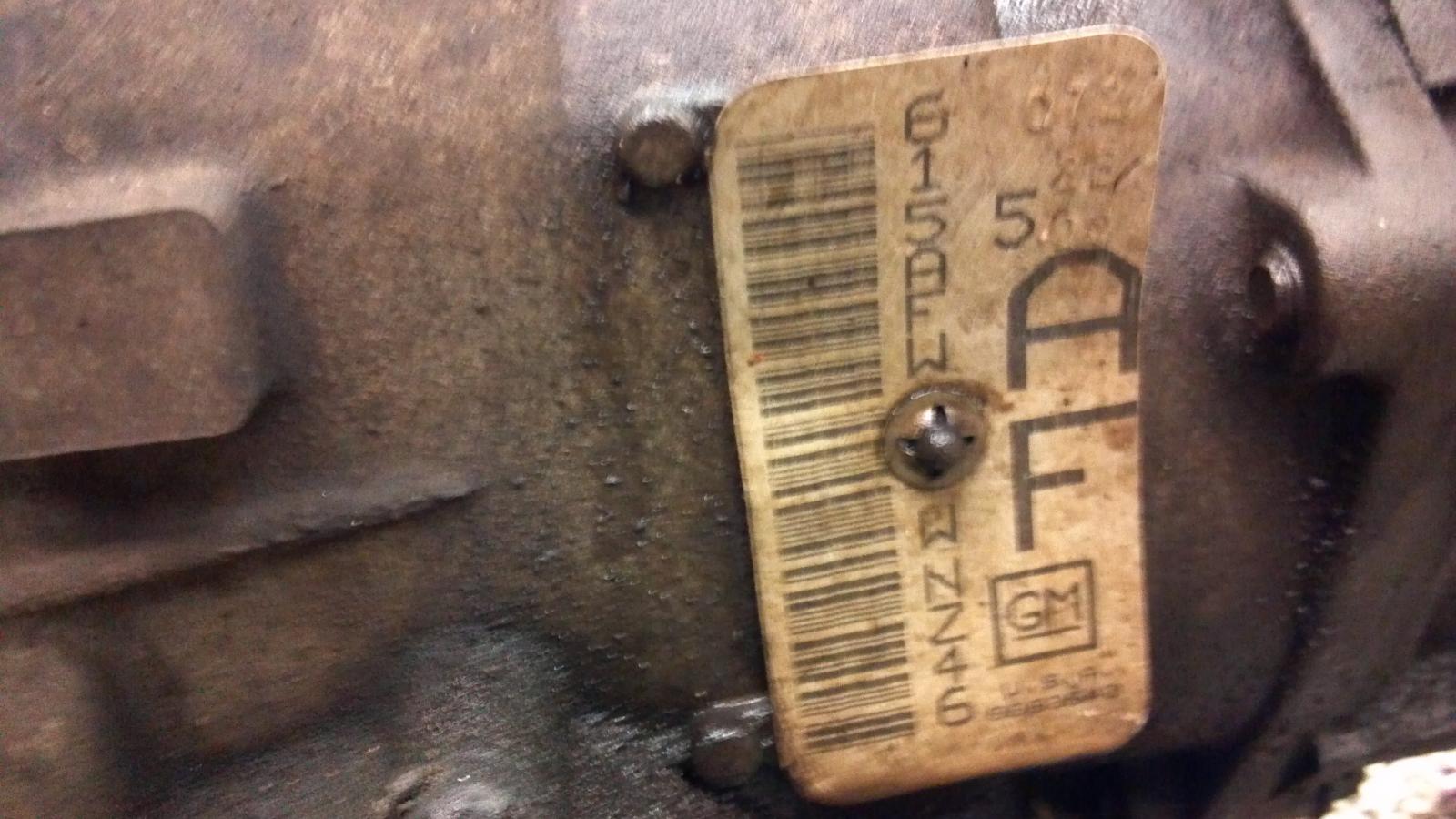

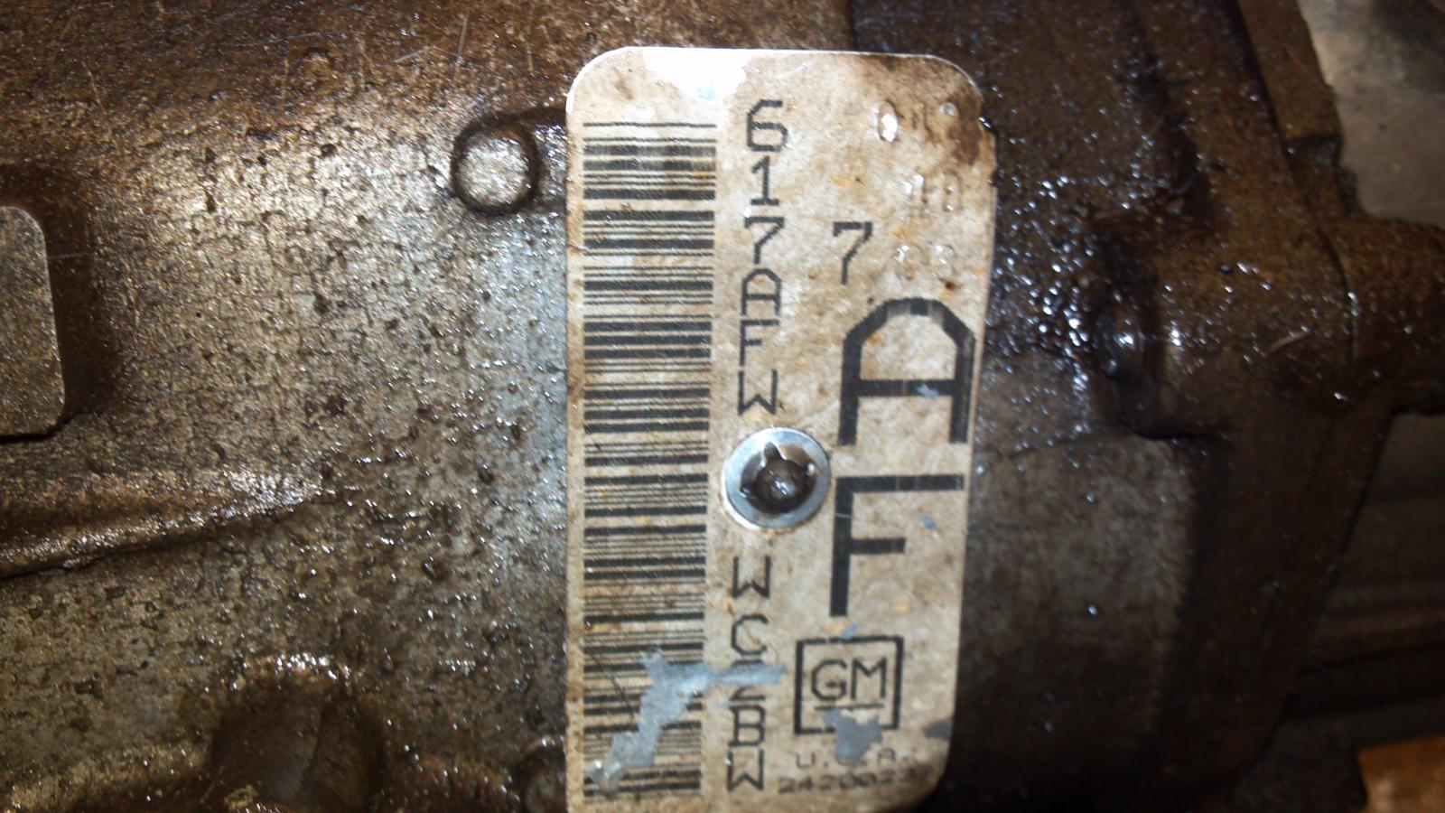

RobertISaar Posted January 15, 2014 Report Posted January 15, 2014 5AFW vs a 7AFW.... essentially identical, other than year produced. torque converter might have slight differences internally(clutch material), but i think that was a 98+ change, not 97. Quote
RobertISaar Posted January 15, 2014 Report Posted January 15, 2014 The stamped number make me curious. I'm wondering if the stamps are different (on the bell housing under the throttle body) maybe because of having a different final drive ratio (went from 95 to 96 trans). that trans has a 97 tag.... but anyways, there were 2 known 97 W-body 3100 4T60E transmissions, 7AFW and 7AHW, AFW is still the 3.33 final drive, AHW is the 3.29 final drive "fine pitch" version that AFAIK interchanges with the 4T65. Quote
Pitts Posted January 16, 2014 Author Report Posted January 16, 2014 that trans has a 97 tag.... but anyways, there were 2 known 97 W-body 3100 4T60E transmissions, 7AFW and 7AHW, AFW is still the 3.33 final drive, AHW is the 3.29 final drive "fine pitch" version that AFAIK interchanges with the 4T65. Interesting. I think I understand how the stamping works due to my GP being made in Aug of 94 (hence the 744). I know the trans was the original one (after 176k miles). I actually know the only 2 previous owners of the vehicle. Quote
Schurkey Posted January 16, 2014 Report Posted January 16, 2014 Those numbers are NOT STAMPED. They're cast-in. A stamping would be pressed-into the metal, the casting is raised. First guess: Different mold numbers. Quote
