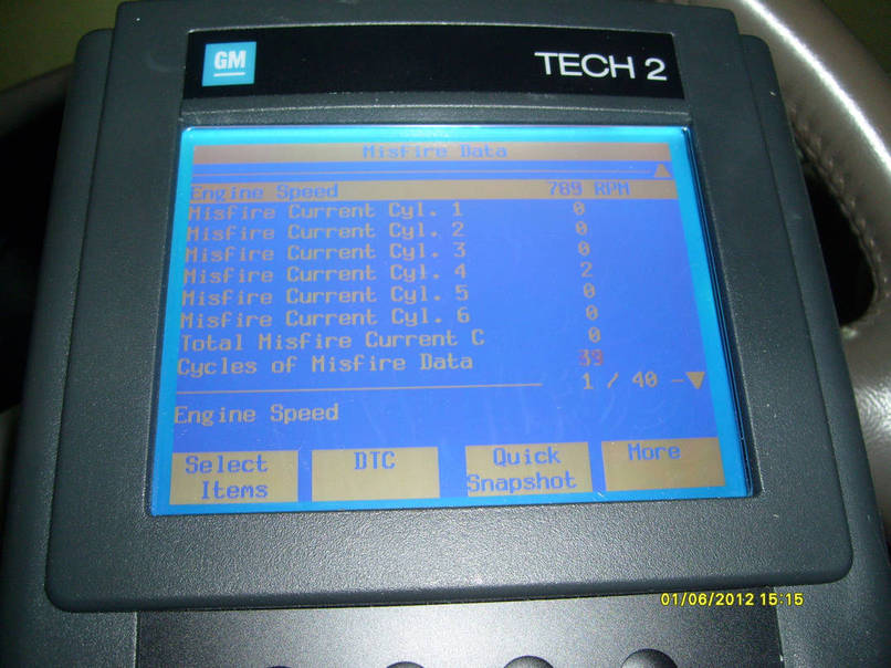

Cutlass350 Posted January 5, 2014 Report Posted January 5, 2014 (edited) BTW, It's ~$500 for the scanner with shipping, they take paypal. Imho, pay ONLY by paypal! Paypal is very unforgiving to sellers that scam people. http://www.uobd2.net/wholesale/new-gm-tech2-scanner.html New GM Tech2 Diagnostic Scanner Working for GM/SAAB/OPEL/SUZUKI/ISUZU/Holden Special Price for New Year Item No. SP23-D History: 82 sold 4.5 stars, 15 reviews. In Stock US$329.00 S&H ~$160 I make no claim to if you'll get anything at all, how well it works, how long it works, if it's legal/proper to use the clone, etc. Other than, mine works, and has worked fine since 2012. I used mine last month on a MAF code on my 2000 Olds. I was able to see the capture data, real-time data, etc. I decided to use the code as a reason to do a "MAF upgrade" to the newer style GM MAF. Note, I buy GM/Delco ONLY for any sensor/etc. Rockauto and Amazon are good places. Good Luck! Edited January 5, 2014 by Cutlass350 Quote
