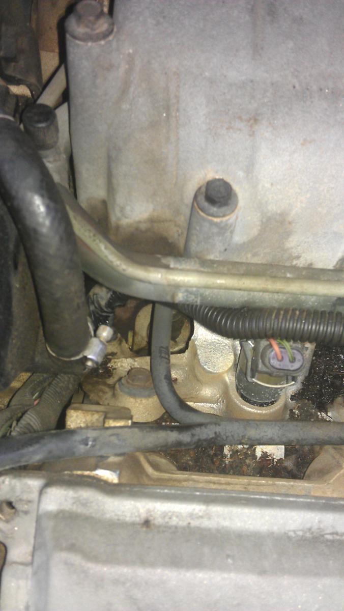

Nas Escobar Posted January 4, 2014 Author Report Posted January 4, 2014 (edited) Well I thought I should update but I swapped out my MAF and I'm not sure whether or not to chant victory. Once I first started it, it made the popping noise then cut off. I let it sit, started it again and I sprayed some carb cleaner around the injectors and tried to get into the LIM. Needless to say the exhaust on the car smelled HORRIBLE. I assume I ended up cleaning the inside of the exhaust ports or something because the exhaust just hit you with the smell of carb cleaner. The good news is that it now idles a bit smoother, and now the car idles at 1000 when in park and neutral and SOMETIMES drops below that when in gear and the temperature at normal (200F). I haven't been able to test drive it since it's cold, there's ice outside, and I don't want road salt to hit the frame or body of this car (there is no rust under this car whatsoever) sooo I'm going to wait until most of the ice is gone and the road salt is washed away until I test drive it. I'm also hoping the engine cut itself off the first time because it had more gas in it than needed. I also sprayed carb cleaner around the injectors and tried to get near the lim and it didnt' affect it much when at 200F opposed to when I first started it. I'll try it again once it's warmer and cleaner outside and see what happens. As of now, I'm thinking it may be a vacuum leak and not the LIM as there is some difference with the new MAF. Not too sure though. Below is also the picture of where I sprayed the carb cleaner while it was warming up. It did affect the RPM'S some but not sure if it had much to do with it. I know the cleaner got in the engine for sure though since the exhaust smelled of it. So far still at a loss, but will try again when it's warmer. That's all I can say for now. Edited January 4, 2014 by Nas Escobar Quote
Nas Escobar Posted January 5, 2014 Author Report Posted January 5, 2014 OK, so here's an update. Turns out the carb cleaner is going through the vacuum line in that hole in the picture above... somewhat interesting. I should also add that I drove the car today and it seems to be more responsive but the RPM's keep fluctuating though not as much. A neutral drop still keeps it in 2000 RPM. I still get the stumbling when heating up to 200F that triggers the SES so with all that being said... vacuum leak or LIM? If it's a vacuum leak, where can I get the hoses? Quote
