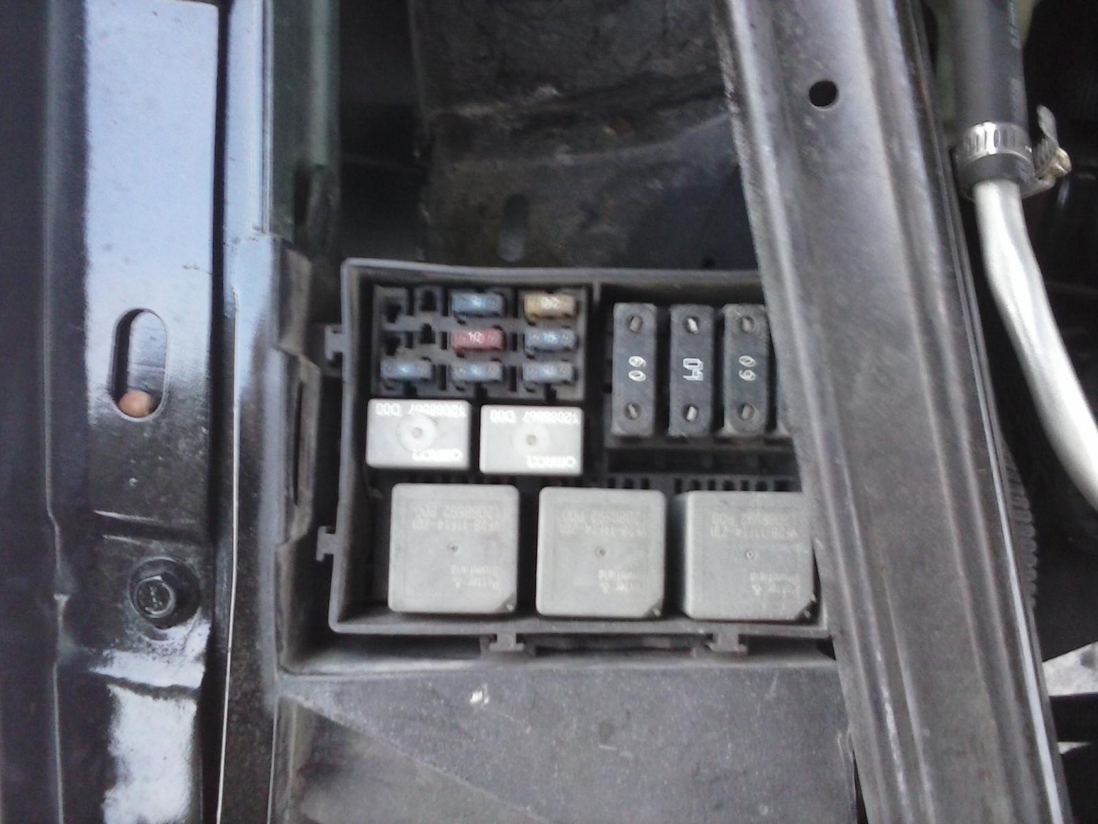

So.. Where's my Fuel Pump Relay?
In my infinate wisdom I removed the cover on my RHS UEC so it wouldn't stop me from getting to the fuses and lost it. Today for the second time the Regal has failed to start when the temp dropped into the teens, there's no fuel at the rail so it's either A) Fuel Pump, B)Fuel Pump Relay, or C)PCM that doesn't like the cold. I'm assuming it's the PCM (First winter with this PCM) so I extracted it and have it on a heater but it'd be nice to know which of these is the relay so I can try swapping it if this doesn't work. It sould be one of the smaller ones but not sure if it's closest or furthest from the fender. Thanks in advance....
You forgot D) fuel pump wire harness including fuel pump fuse(s), E) failed fuel pump, F) frozen or plugged fuel filter, G) failed fuel pressure regulator, and H) plugged fuel pump sock.
