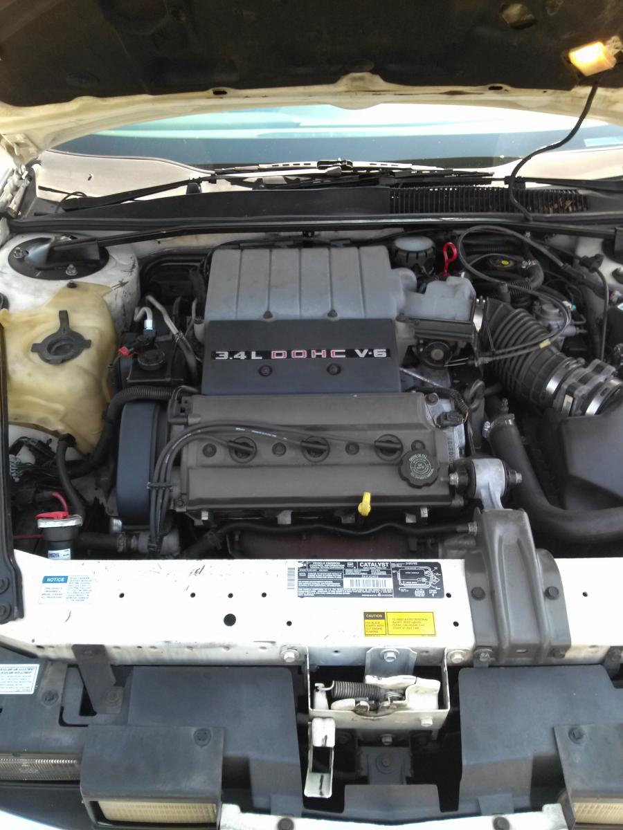

I also did a LIMG job on the engine and while it was apart, I decided to paint the valve covers. It was looking pretty depressing. I forgot to take a "before" picture, but here's a picture that shows the valve cover. This picture was for other purposes, I was testing the feasibility of swapping the inside turn signal and retrofitting a glass bulb there. That's for an upcoming project that was inspired by Miko K.
And here's the obligatory prep pic. I used aircraft stripper to peel the 20 year old paint off. The LQ1 comes with the front valve cover painted but not the back one nor the plenum. That created for a nasty situation when the stuff got gunked on.
Ready to prime
Primed. I took a pic with both valve covers drying
I painted the valve covers and intake plenum with Duplicolor Cast Iron enamel. I didn't like how the aluminum color looked when I used that on the Camaro and the cast iron is close to the gray that was used by the factory in 1994. I was skeptical of the color at first, but once altogether it really look good. Nothing fancy, but I was going for something that would look factory.
The valve cover that gets covered by the plenum but somehow ends up dirty anyways. That was my reason to paint it. i hated seeing grime on it when the manifold came out. Barely visible but it's there.
Intake plenum on but not assembled. I have the car running now. I swapped out a coil on it that was causing a misfire when cold and it's a nice smooth driver. Just need to finish the interior (which is coming up)
