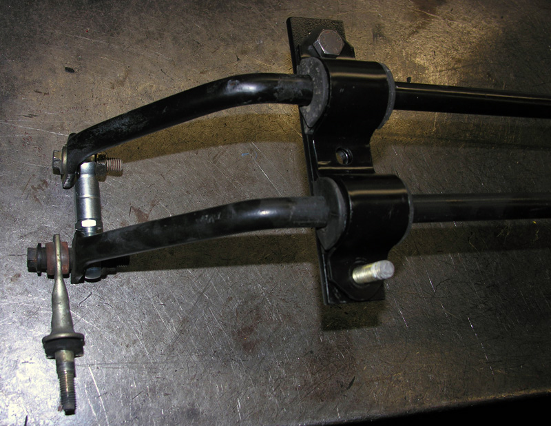

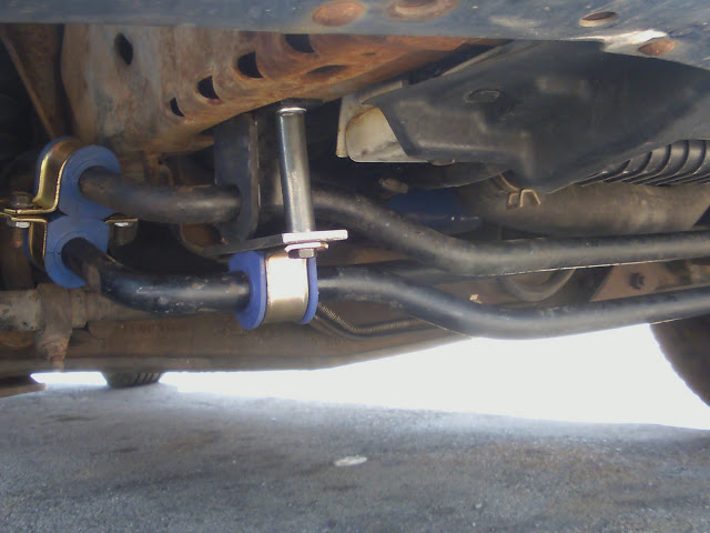

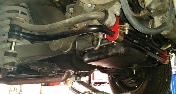

Imp558 Posted January 20, 2018 Report Posted January 20, 2018 Old thread but upon reading it has the most useful information regarding sway bar upgrades so I'm bumping it. Since we have limited sway bar options I wonder if we can cobble a bit like some other platforms do and just run dual setups. First gens have a readily available bracket for up top that could be bent and mounted and then the bottom on each spindle assembly looks like it would some cobbling. Quote
l67ss Posted January 20, 2018 Author Report Posted January 20, 2018 I had planned on modding the Monte to use the dorman solid 33mm bar Quote
Imp558 Posted January 20, 2018 Report Posted January 20, 2018 I'm kind of thinking I already own 2 sets of first gen sway bars ...... Looking at that last picture and the way he (or she to be fair) stacked 2 brackets with the spacers makes me think a machine shop could fab something 1 piece farly cheaply. Quote
l67ss Posted January 22, 2018 Author Report Posted January 22, 2018 Be hell finding room in the front Quote
Imp558 Posted January 22, 2018 Report Posted January 22, 2018 Yeah, that damn tie rod is right there, and in the rear the coat hanger of a sway bar is bent and looped around funny. No harm in looking when I get it all tore apart I suppose. Quote
