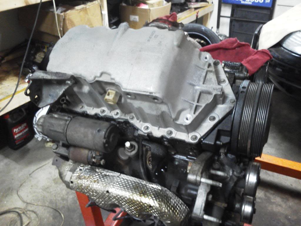

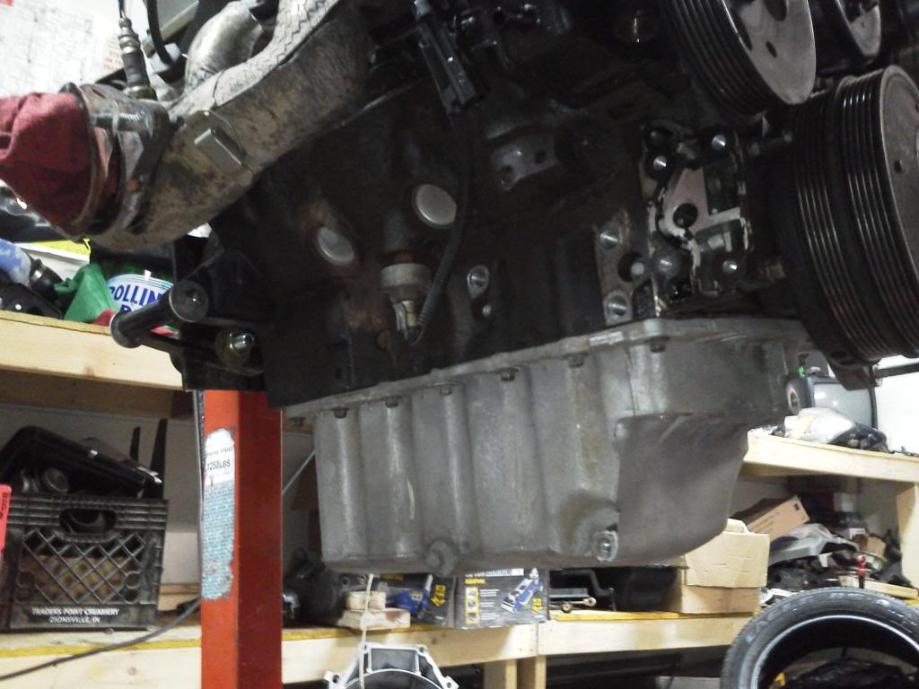

Imp558 Posted December 4, 2013 Report Posted December 4, 2013 HaHa, Android heard "W Fadi you bracket" when I said "W-Body U-Bracket", oops. I can't find those pics they must be on my work computer so I'll look tomorrow. I thought I posted them a while back...? Anyway there are a couple good shots in an album in my profile of just the oil pan. Essentially all I did was grind a little clearance off of the U-Bracket that reaches from one side of the block to the other and has the front mount on it. It needed ground a little in 2 spots on either side and I thought a spot in the middle was a bit close so I took a little off there too. It's really worth saying that you need to put the front engine mount onto the bracket before you install the bracket onto the block, there isn't clearance to get a wrench on the nuts with the S3 oil pan. Quote

Imp558 Posted December 5, 2013 Report Posted December 5, 2013 I think this requires the series 3 pick up tube as well, My series 2 one was bent But I think it would have been a little shorter anyway. The level on the dipstick still looks the same So I could be wrong Quote
