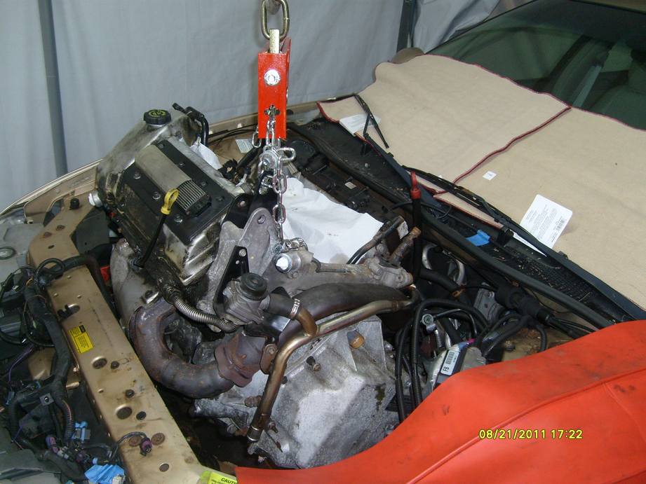

Cutlass350 Posted November 28, 2013 Report Posted November 28, 2013 (edited) FYI, with a 2000 Olds Intrigue - engine R&R, I yanked both. Edited November 28, 2013 by Cutlass350 Quote
