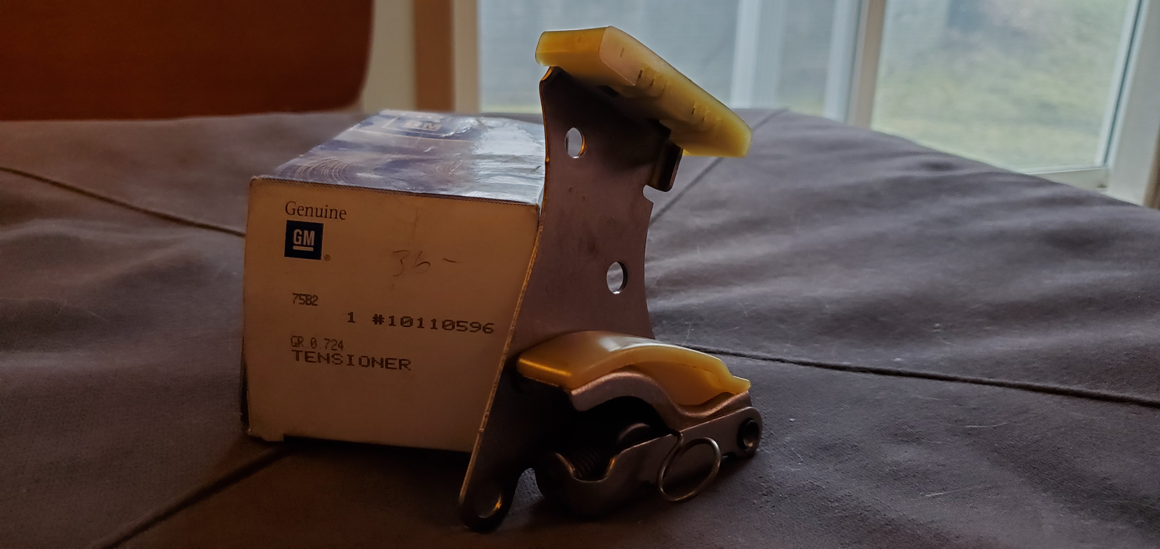

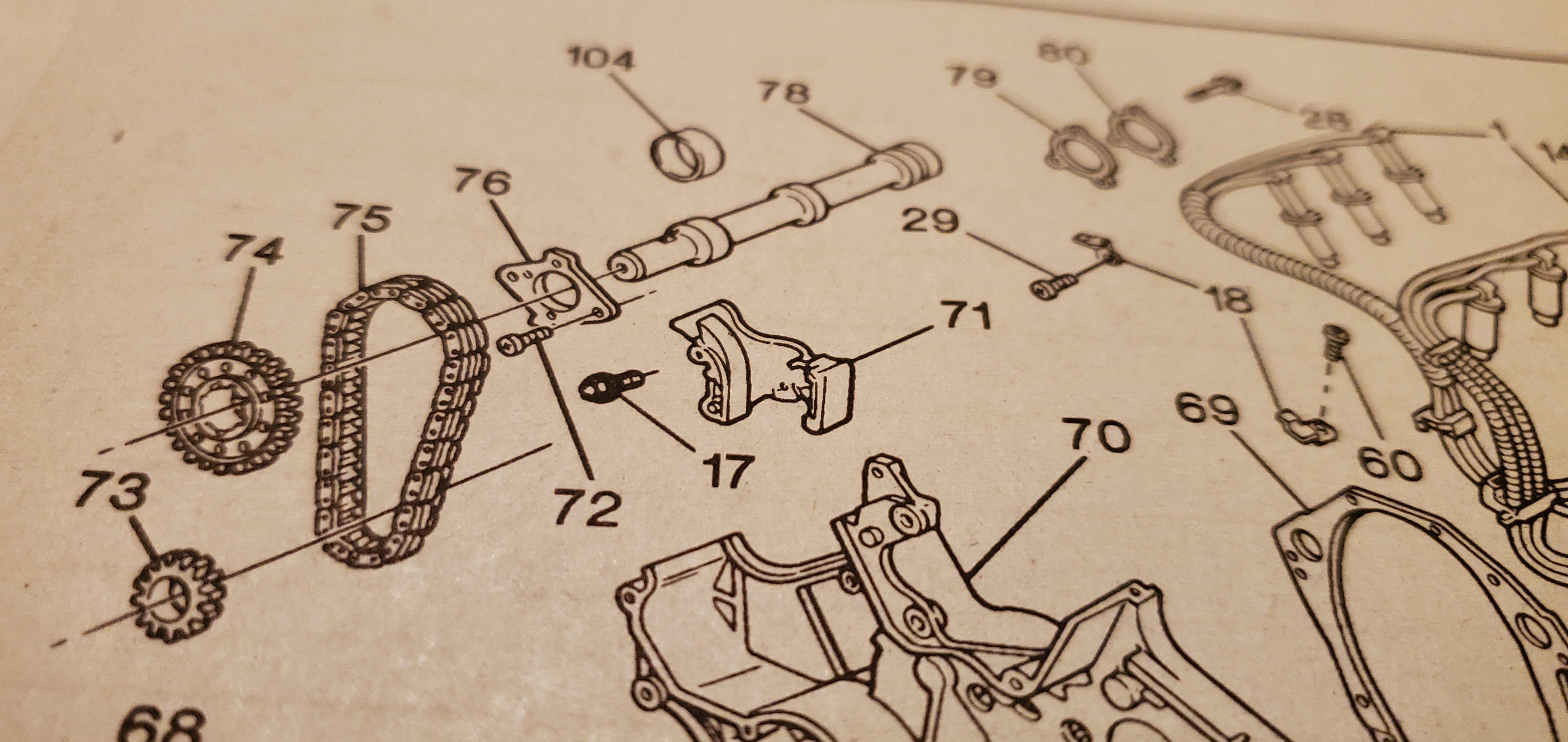

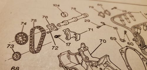

55trucker Posted March 23, 2021 Report Posted March 23, 2021 57 minutes ago, jiggity76 said: These are still available. Part #10110596. Hope this helps. Greg: that is the chain tensioner jiggity76 1 Quote
96 Pontiac gtp Posted March 23, 2021 Report Posted March 23, 2021 1 minute ago, 55trucker said: Well son, don't believe everything one reads with regards to a third party aftermarket ad, the tensioner is indeed mechanical. Well that's good to know. Can it be rebuilt so it don't fail? Quote
jiggity76 Posted March 23, 2021 Report Posted March 23, 2021 (edited) 24 minutes ago, 55trucker said: Greg: that is the chain tensioner Yes sir. #71 in the diagram. Also, about 52:10 into the video. Edited March 23, 2021 by jiggity76 Quote

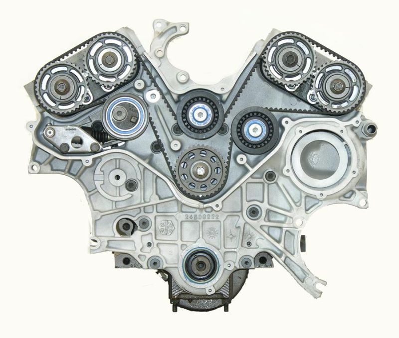

55trucker Posted March 23, 2021 Report Posted March 23, 2021 (edited) There are no independent replacement parts for them, so as for *rebuilding* one all one can do is to disassemble the item to inspect the spring the ratchet mechanism & the pre-load safety. A new one is shipped pre-loaded dry, one fills the inside with oil to permanently lube it, the oil cannot get out as there is the rubber boot at the pintle end & a small rubber cap the at the top end. When installing the piece there is a safety pin keeping the spring loaded ratchet from releasing. After all the idlers & the belt are in place one pulls the pin to engage the tensioner to the tensioner pulley. Edited March 23, 2021 by 55trucker Quote
96 Pontiac gtp Posted March 23, 2021 Report Posted March 23, 2021 6 minutes ago, 55trucker said: There are no independent replacement parts for them, so as for *rebuilding* one all one can do is to disassemble the item to inspect the spring the ratchet mechanism & the pre-load safety. A new one is shipped pre-loaded dry, one fills the inside with oil to permanently lube it, the oil cannot get out as there is the rubber boot at the pintle end & a small rubber cap the at the top end. When installing the piece there is a safety pin keeping the spring loaded ratchet from releasing. After all the idlers & the belt are in place one pulls the pin to engage the tensioner to the tensioner pulley. Really wish that I could find a new one. Would feel better about it. Seeing that I have never taken one a part. lol Quote
55trucker Posted March 23, 2021 Report Posted March 23, 2021 Do you have an engine that has seen the tensioner fail? Quote
96 Pontiac gtp Posted March 23, 2021 Report Posted March 23, 2021 38 minutes ago, 55trucker said: Do you have an engine that has seen the tensioner fail? Not yet, but with being an interference motor I really don't want to take that chance. I had a Mitsubishi that the hydraulic tensioner went out and was not pretty. Waked all intake valves and it hurt the wallet. Not looking forward to that again cause the car will see the scrapyard then. Quote
55trucker Posted March 23, 2021 Report Posted March 23, 2021 Well with the 96-97 engines vigilance is a wise approach to take, don't forsake the timing belt maintenance routine. If the engine has gone past 60,000 miles & the belt hasn't been replaced keep an eye on the belts condition on a regular basis. Pull off the front access cover & have a good look at the belts condition. Look for debris under the belt, small black particles can be expected, anything on the large scale is a *red flag* to pull off the belt cover to get a look at whats lying in wait. Generally the belt will fail before the tensioner does, but the tensioner cannot keep the belt under *proper* tension if the belt has stretched too much, that's why there is a maintenance schedule on the belt. jiggity76 1 Quote
