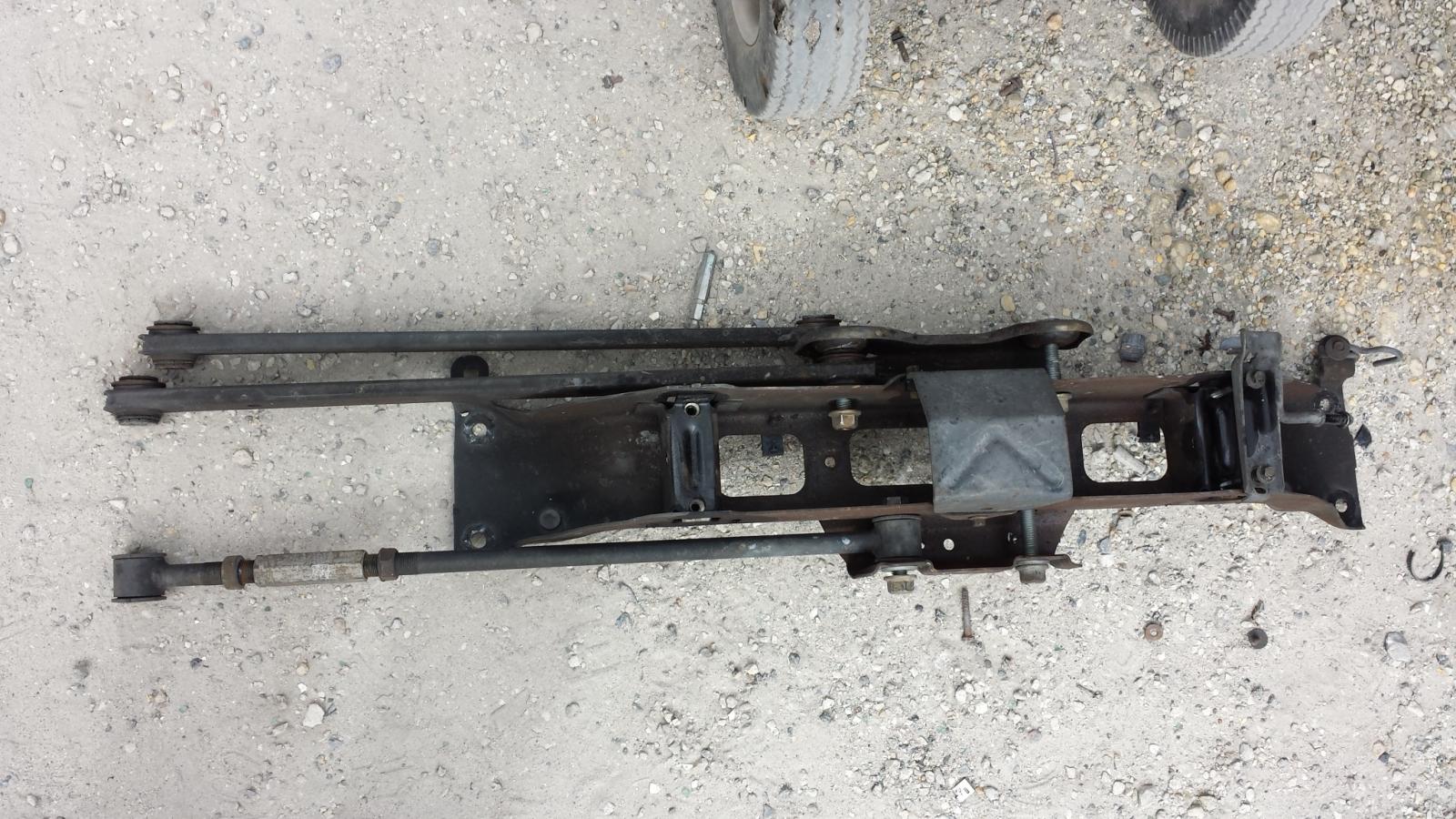

Miko K Posted November 18, 2013 Report Posted November 18, 2013 You can get a set of adjustable lateral links from gen2+ w body and stick the entire rear suspension out by placing the rear (longer) lateral link in the front of your rear suspension and putting the adjustable lateral links on the rear of the rear suspension. The adjustable links can accommodate the extra width with no problem. From top to bottom- gen1 front link, gen1 rear link, gen2 adjustable link. Quote
l67ss Posted November 18, 2013 Report Posted November 18, 2013 Not to mention gen 2 links are FAR superior to gen 1s You can get a set of adjustable lateral links from gen2+ w body and stick the entire rear suspension out by placing the rear (longer) lateral link in the front of your rear suspension and putting the adjustable lateral links on the rear of the rear suspension. The adjustable links can accommodate the extra width with no problem. From top to bottom- gen1 front link, gen1 rear link, gen2 adjustable link. [ATTACH=CONFIG]14354[/ATTACH] Quote
Galaxie500XL Posted November 20, 2013 Report Posted November 20, 2013 This may be a noob type question, but wouldn't doing so adversely affect the alignment of the rear wheels? You can get a set of adjustable lateral links from gen2+ w body and stick the entire rear suspension out by placing the rear (longer) lateral link in the front of your rear suspension and putting the adjustable lateral links on the rear of the rear suspension. The adjustable links can accommodate the extra width with no problem. From top to bottom- gen1 front link, gen1 rear link, gen2 adjustable link. [ATTACH=CONFIG]14354[/ATTACH] Quote

Miko K Posted November 21, 2013 Report Posted November 21, 2013 (edited) To answer Galaxie500XL's question- they are adjustable, as long as you can adjust your camber (elongate the bottom holes on your struts or just get aftermarket ones that come with elongated holes), the rest will be a breeze when you bring your car to the shop for alignment. Edited November 21, 2013 by Miko K Quote
