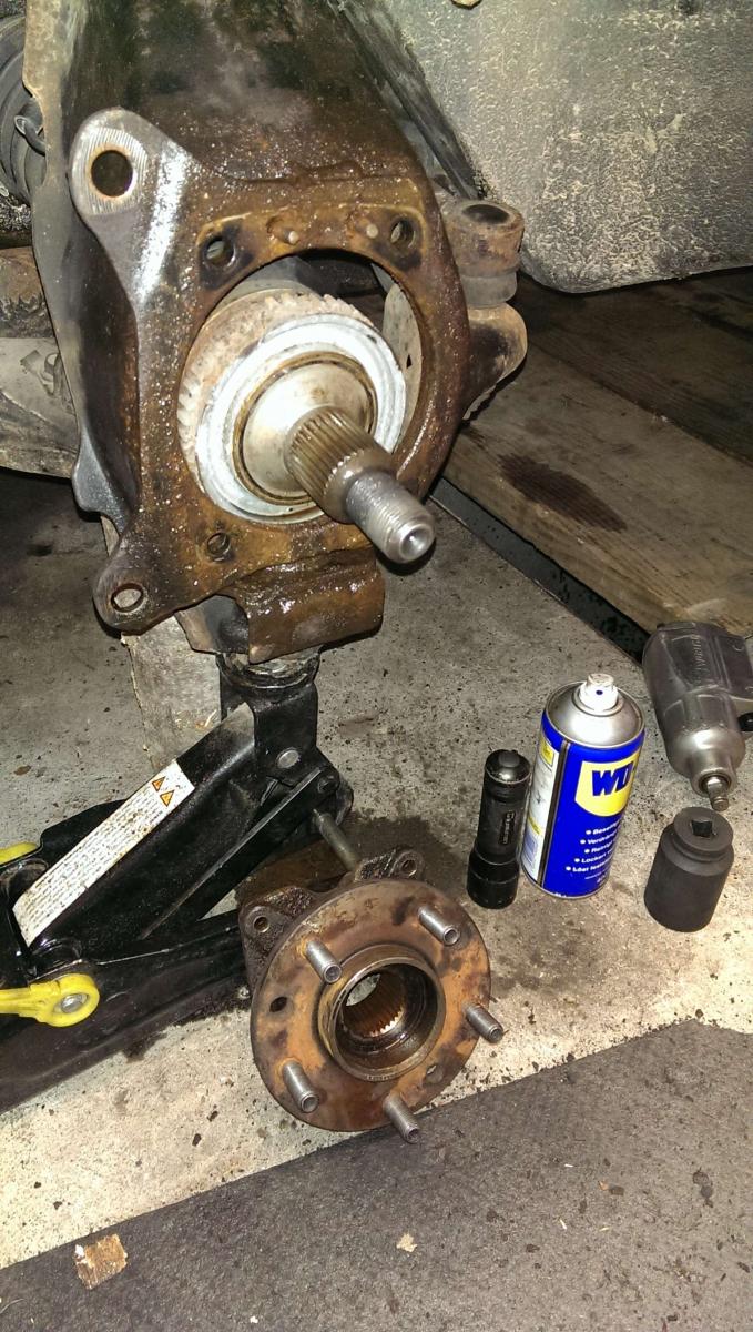

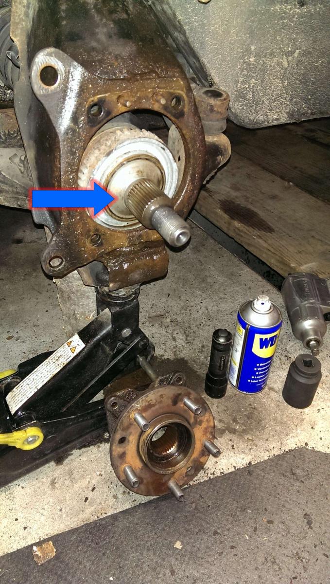

HEMI-V8 Posted April 16, 2014 Author Report Posted April 16, 2014 Currently Im on the wheel bearings. So I got 2 questions: - Should I renew both sides ? - I need the size of the brake caliper torx screw. Can anybody tell me what size I need ? Thx HEMI Quote
dodgethis Posted April 16, 2014 Report Posted April 16, 2014 (edited) Currently Im on the wheel bearings. So I got 2 questions: - Should I renew both sides ? - I need the size of the brake caliper torx screw. Can anybody tell me what size I need ? Thx HEMI They can't be T-60, someone confirm this? My 2 cents Edited April 16, 2014 by dodgethis Quote
Galaxie500XL Posted April 16, 2014 Report Posted April 16, 2014 I'm thinking T50, but I'm going by memory. Quote
Imp558 Posted April 17, 2014 Report Posted April 17, 2014 First time I did hub assemblies I broke one of those Torx bolts and one of the 4 hub assembly bolts and had to ride the GT across town to get new. Now I keep a couple spares around. Dealership was the only game in town for the hub assembly bolts but the parts store had the caliper bracket bolts. Those caliper bracket bolts are hard as hell and it took many drill bits to overcome one, had to ride the bike to get bits too. Quote

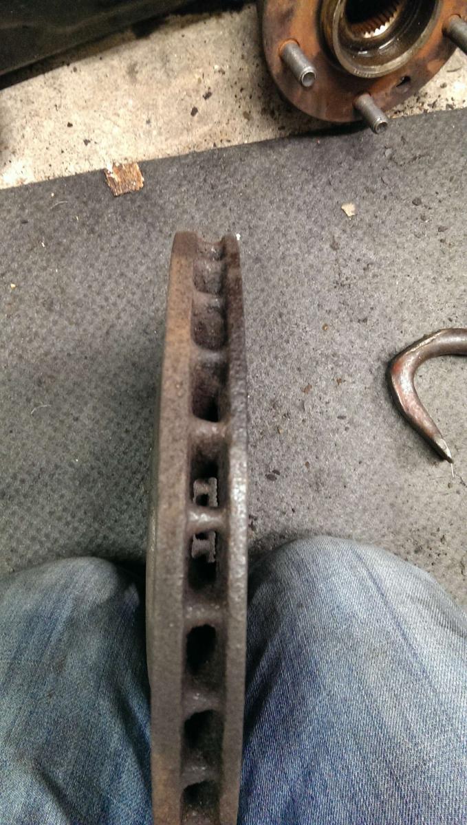

HEMI-V8 Posted April 17, 2014 Author Report Posted April 17, 2014 Thank you guys ! I got it. WD40 and a little gentle power made it. Now Im just waiting for the new one from rockauto. But the brakedisc looks very weird: Quote
Galaxie500XL Posted April 17, 2014 Report Posted April 17, 2014 Sticking caliper? Thank you guys ! I got it. WD40 and a little gentle power made it. Now Im just waiting for the new one from rockauto. [ATTACH=CONFIG]15904[/ATTACH] But the brakedisc looks very weird: [ATTACH=CONFIG]15905[/ATTACH] Quote
HEMI-V8 Posted April 17, 2014 Author Report Posted April 17, 2014 The brake caliper runs free and easy. Quote
Imp558 Posted April 19, 2014 Report Posted April 19, 2014 I wonder if that was a factory weight for balance? Seriously, it's worth a phone call to the dealer to find out how expensive those 6 bolts are. My last Rockauto hub assembly lasted 2 years, I just replaced it again. Do you need torque specs Bro? Quote

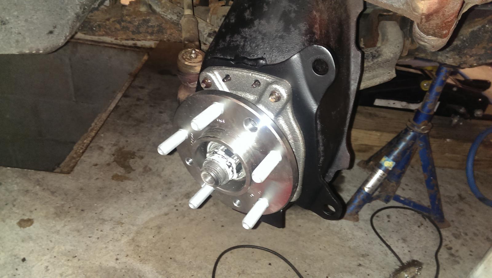

HEMI-V8 Posted April 19, 2014 Author Report Posted April 19, 2014 Im ordered yesterday 2 hub assemlies @ rockauto from Timken. The shipping and duty costs are more expensive than the worth of the parts. I forgot the discount code by my order. However it´s still cheaper than the stuff from my local parts dealer in germany. Do you need torque specs Bro? Oh yes that would by awesome ! My haynes book ist there not really helpful. Regards HEMI Quote

HEMI-V8 Posted April 23, 2014 Author Report Posted April 23, 2014 So thank guys - the job is done and the bad noise is gone ! Quote
