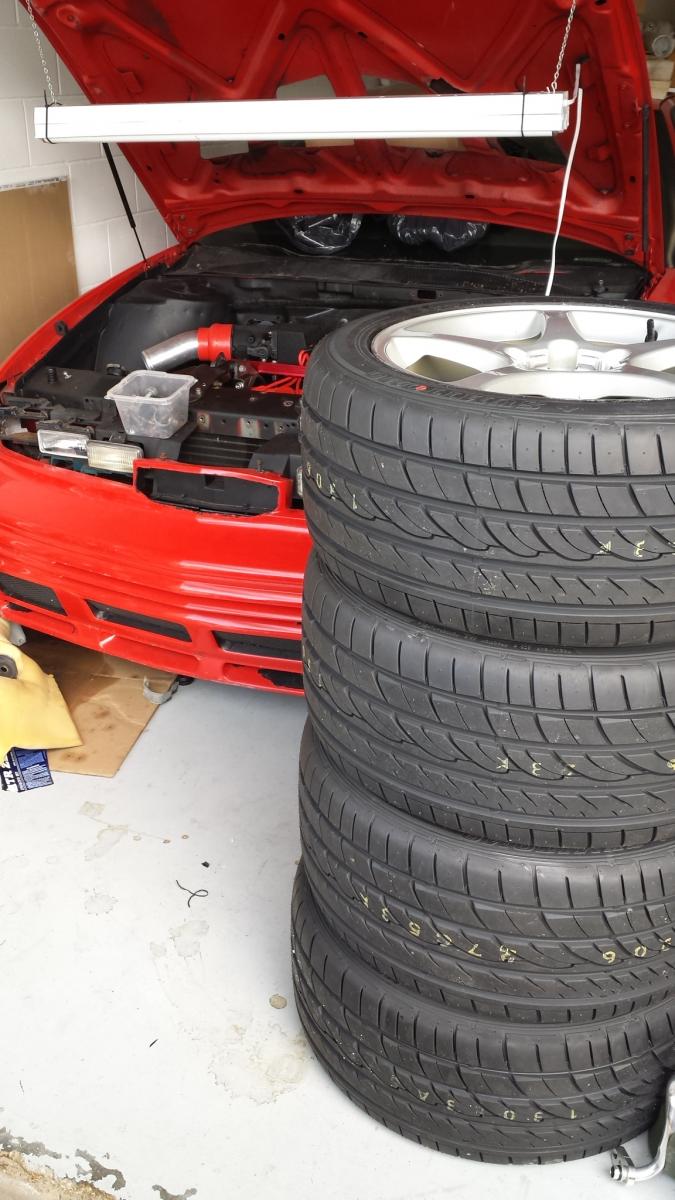

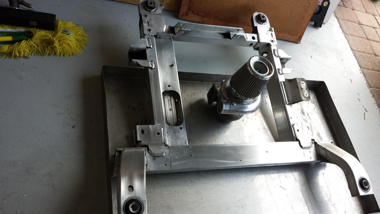

Here is some promised candy:
A semi-polished aluminum subframe, a giant turbo with a 4" SS filter on it and a tall stack of sticky sticky rubber ready to burn!

Thanks for the info George, I couldn't find any info on the stock spring rate. My front end was crazy stiff when the car was loaded with the previous setup (intercoolers, supercharger, automatic transmission), lots of steel parts that are now going aluminum. I was using chopped stock CS springs and they are VERY stiff. I think I might be lighter now than stock with the 3100 and the automatic- the heads on the 3800 are heavier but the aluminum subframe should compensate and the turbo weight (along with piping and intercooler) should be offset by the manual transmission. The only weight that hurts my setup will be the C6 Z06 brakes: the rotors weigh 27lbs each and the calipers (loaded with 6 freakin' brake pads per caliper)are around 15 each, then you add 4lbs for the wheel adapters. My tire/wheel combo is at 47lbs which is good for a 275 40 18 setup but still heavier than stock and that is unsprung weight, does not affect the springs but does make for a bumpy ride. I think I'm going to go coilovers because it's easier to tune the spring rates than choosing between just 2 lowering springs of 280 or 450lbs. Seems like I would be doing good around 350-375 but I need to do more research.
