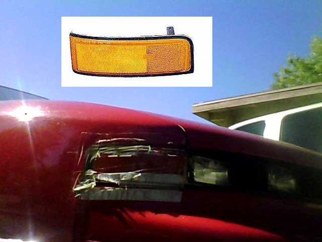

TheLazyRocket Posted November 2, 2013 Report Posted November 2, 2013 How difficult would it be to replace my blinker lens on my own, or should I seek help? I got it like it is and I would like to fix it. Quote
GOT2B GM Posted November 2, 2013 Report Posted November 2, 2013 Its one screw accessible from the top when the hood is open Quote
GOT2B GM Posted November 2, 2013 Report Posted November 2, 2013 Do you need a replacement lense? Quote
rich_e777 Posted November 2, 2013 Report Posted November 2, 2013 (edited) You do need a very special tool to change them. An 8mm socket wrench and at least one hand with a thumb and at least another finger. Its honestly very simple and easy. The actual orange translucent part doesn't come out, you need to get the entire piece or assembly. Pop your hood and remove the black plastic surround that's held down by 3 pin like things that are also plastic, no idea what these are called but you can get replacements at any autozone. 8mm the little bolt out and twist the light bulb out of its catch. Should fall right out and ready to go. My record is a minute and 12 seconds. Edited November 2, 2013 by rich_e777 Quote
Crazy K Posted November 2, 2013 Report Posted November 2, 2013 You guys make it sound too simple. You need a socket, an extension, and a ratchet. Opposable thumbs are optional. Quote
TheLazyRocket Posted November 2, 2013 Author Report Posted November 2, 2013 Do you need a replacement lense? YES I do. Quote
TheLazyRocket Posted November 2, 2013 Author Report Posted November 2, 2013 Cool I might give it a go next time I have some time for my Cutlass. Thx Quote
rockfangd Posted November 3, 2013 Report Posted November 3, 2013 lol. one of the easiest lights to change. I had to do one on my olds, My Seville has similair lights but no screw, just a clip that locks them in. Welcome To the W-Body forum Quote
94 olds vert Posted November 3, 2013 Report Posted November 3, 2013 Should take 1 minute tops to swap in a new one. Quote
Imp558 Posted November 4, 2013 Report Posted November 4, 2013 It'll take longer to clean that adhesive from the tape off the body. Quote
