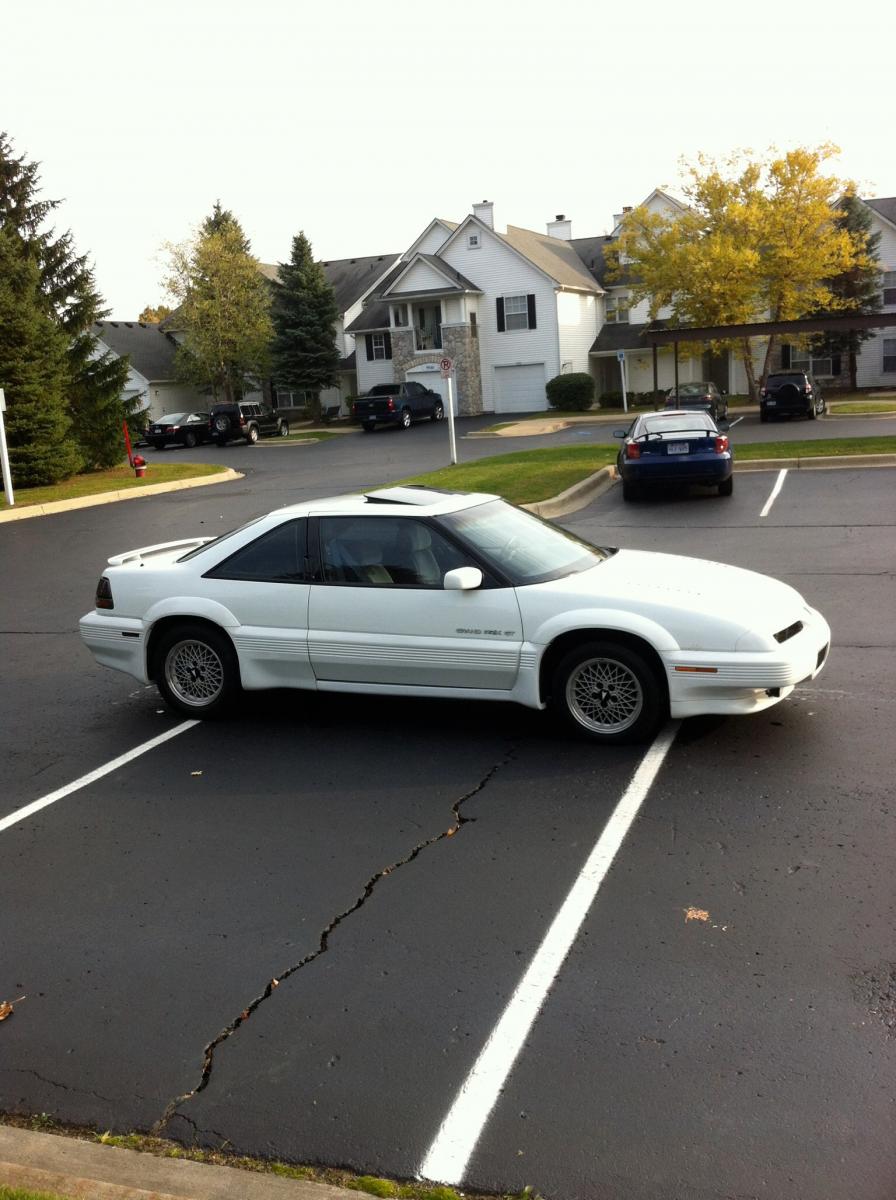

Markchristel80 Posted November 1, 2013 Report Posted November 1, 2013 So I bought another Grand Prix. I've loved these cars since my aunt bought her white 90 Se brand new when I was 10. I've owned an 88 Se, 90 Se, 97 Gt, 95 Se, 05 Gt, and now this 91 Gt. I was going to sell it because it has a lot if underbody rust but I've changed my mind. It's not going to be used as a daily driver so I can fix a little at a time. The main thing I have to get fixed is the drivers side trailing arm. The mount has rusted off and it's just sitting there. Taking it to the body shop who welded my shock mount on my fiero and hoping they can do something about this. While it's there I'm gonna have them check the front cradle. It's been replaced but not sitting right as the dog ones aren't straight and the motor looks to be sitting down more on the drivers side. Wish me luck with this huge project I'm undertaking. I can't see this car going to a junkyard! Quote

Markchristel80 Posted November 1, 2013 Author Report Posted November 1, 2013 Yeah it's a nice car. Can't help living in Michigan with all the salt. This car was obviously driven year round by the rust underneath it. The cradle has me puzzled. When both wheels are straight the drivers side tire sticks out a little more than the passenger side one? Doesn't look like an alignment issue. That's second on the list. Quote
