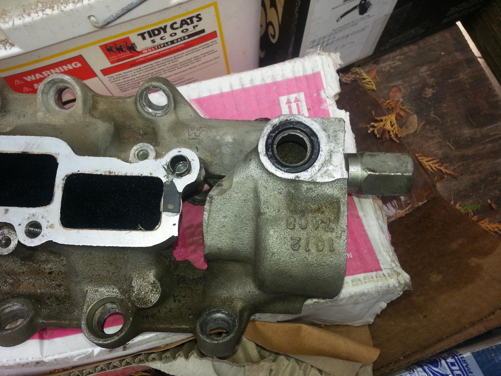

attached is a picture from the old intake(it was cracked so i replaced it) when i removed it there was nothing in the hole above the thermostat, the one i got from the junkyard looks the same. is there supposed to be something there? sorry if thats a really noob question, but im at my wits end with this thing, and would just like to to run.

O ring seal goes there, between the lower and upper intake. IIRC, the temp gauge has it's own sensor. On the 3100's, it's in the rear left side of the head. Single green wire to it. Can't remember where it's located on the 3.4. Been too many years since I've worked on one.

The hole above the t-stat is part of the throttle body heater. If you need a new ring only, I've bought them at a typical hardware store before.

ok so does anything else go there or is it just an o-ring? and where would be a good place to look for a replacement? what specs am i looking for, size-wise?
