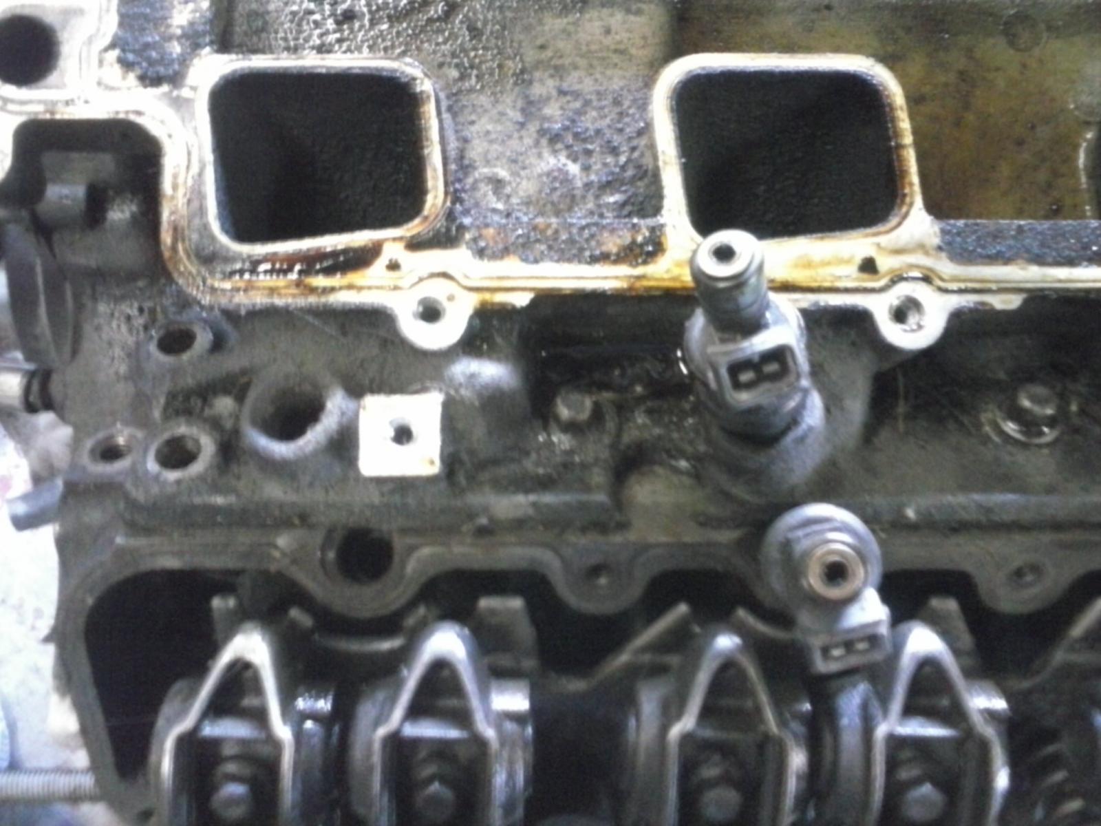

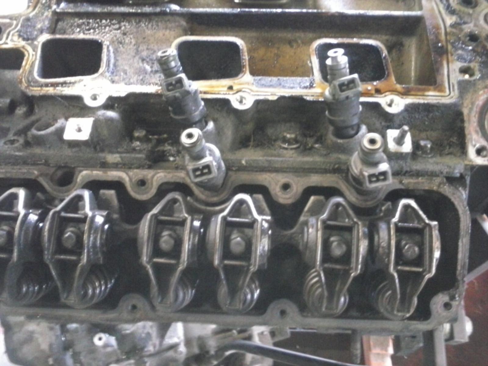

Imp558 Posted October 17, 2013 Report Posted October 17, 2013 Okay, so I was tearing down my L36 for recycling and was curious about some interchangability and found something I thought was pretty neat. Had thought before it may be possible to put L67 heads on and L36 and end up with 2 injectors per cylinder like an LT5. The intake manifold could use some clearancing around the injector ports in the heads but this would mechanically bolt up and line up well. If I remember correctly there used to be an adapter plate to put a SC on a l36 LIM, that could be the makings of a bitchin' boosted/wet nitrous setup. Quote

Imp558 Posted October 17, 2013 Author Report Posted October 17, 2013 It fits, I had bolts in it. I suppose the second set of injectors could be run off a PWM circuit that turns on with the nitrous. Quote
