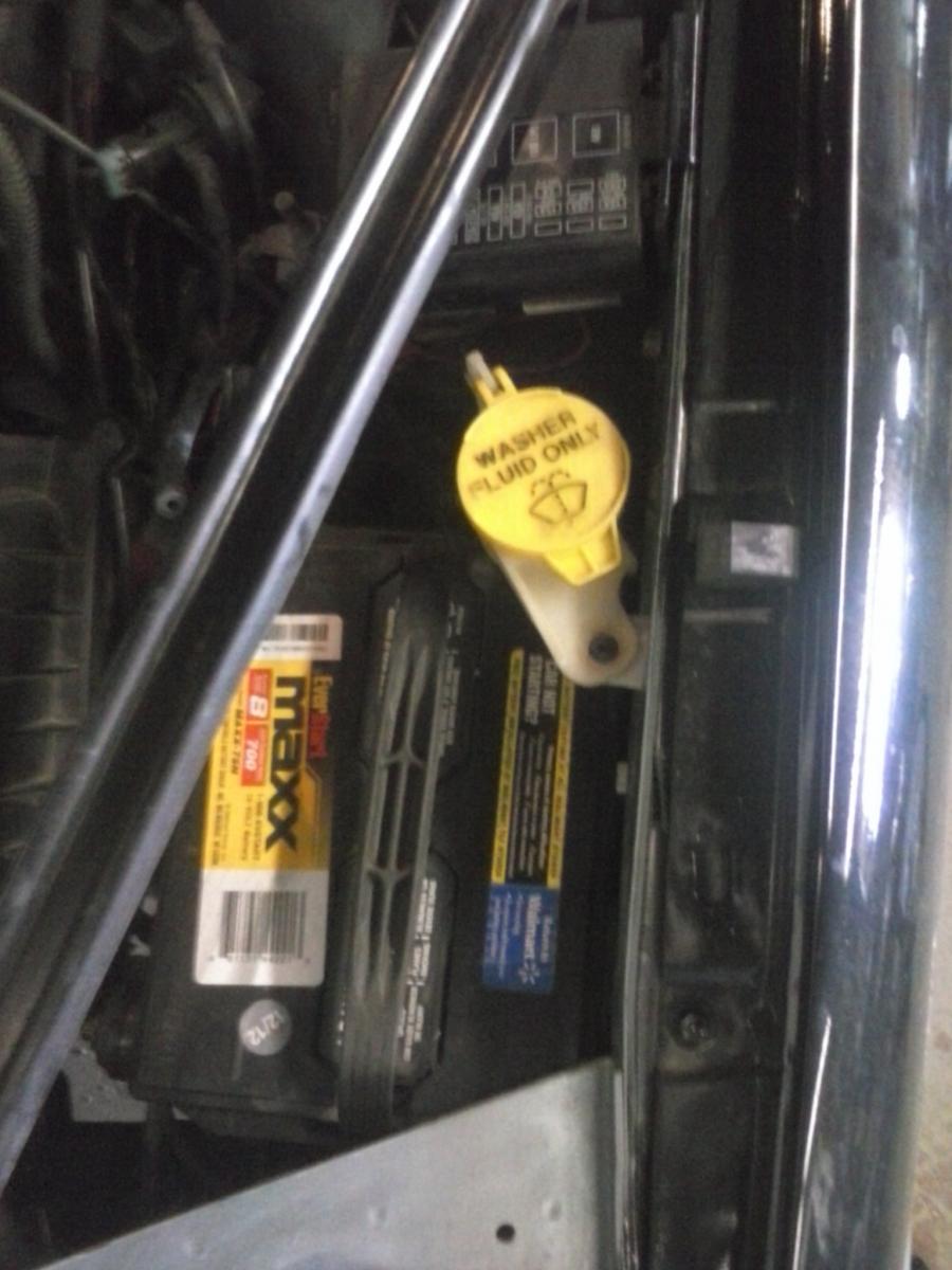

Imp558 Posted November 19, 2013 Author Report Posted November 19, 2013 I'll post some pics tomorrow but found a Chrysler washer bottle and mounted it in the left fender today, has a hose that comes to a nice little fillerdoodle by the battery. Didn't make out so well on the coolant bottle, got a really long necked one but it'd put the hose like 10" lower than where the factory one was. Does anybody know for certain this is bad? The hose won't be much longer and it's kind of cool that the bottle has a dipstick. Quote
Imp558 Posted November 21, 2013 Author Report Posted November 21, 2013 This came out of a Chrysler Sebring or something, that trip to Pull-A-Part is kind of a hectic blur. Quote

Imp558 Posted November 22, 2013 Author Report Posted November 22, 2013 ^^^ Thats why I took mine out completely. Besides, I never drive it in the rain or on damp roads so its kinda useless in there. It's different up north, we get salt and crap on the windshield all winter, I wish I didn't need one. There was a little cutting, had to remove the sheetmetal that goes down to the vaccuum ball and relocate the ball. The brackets were easy, a 5" piece of 1" aluminium angle and a 12" hunk of strap metal. The coolant bottle isn't going to work the more I think about it it should be the high point to trap air bubbles. Probably back to fabricating an aluminium one. I hate that factory coolant bottle so bad I'd trade it for a wart on my big toe in a heartbeat. Quote

vladbuick Posted November 22, 2013 Report Posted November 22, 2013 I remember that my 2001 Chrysler neon ( I guess other dodge and Chrysler cars have the same) had the washer bottle in the fender/front bumper on the passenger side like like in the picture posted by Imp558 also, just as a suggestion if you can weld aluminum like you planned at first why not make a good looking one that you can display in your engine bay ? Quote
