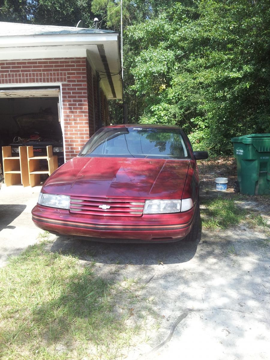

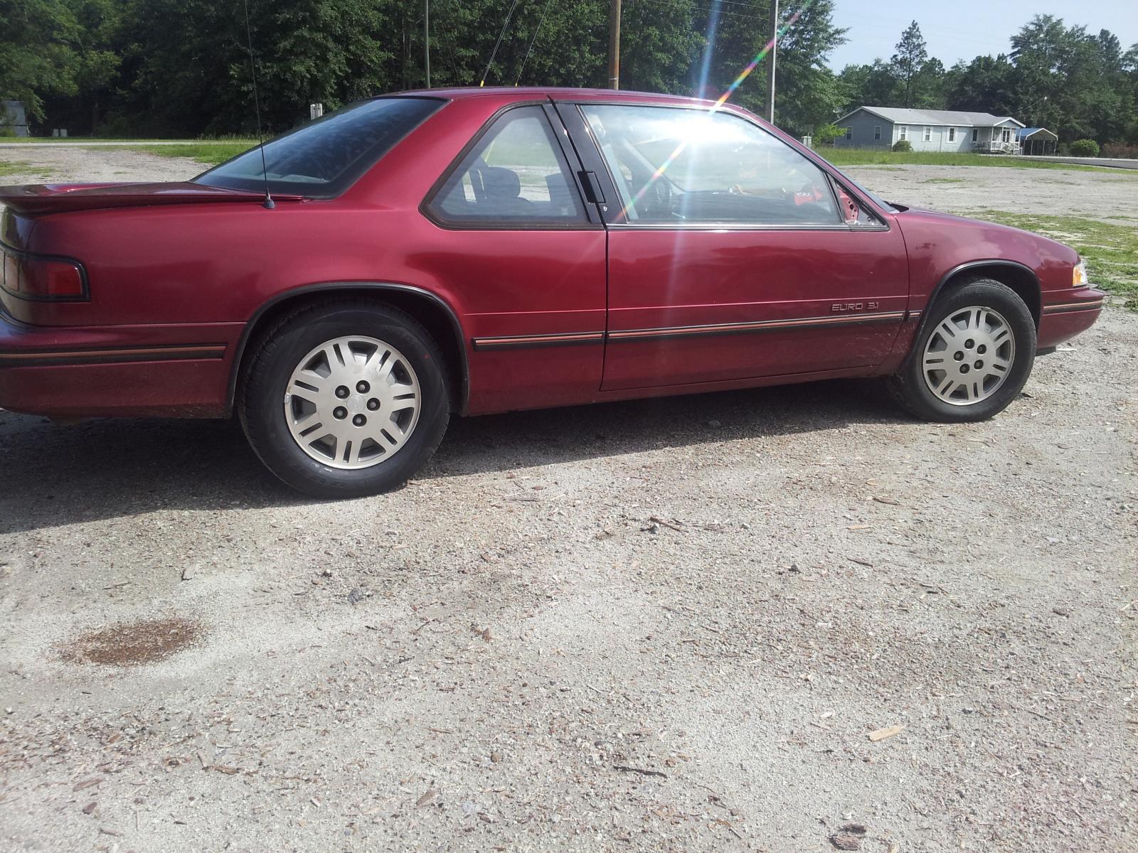

juggalette717 Posted October 8, 2013 Report Posted October 8, 2013 Hey guys I'm Jenifer. I joined up cuz im trying to get some advice on my car so i can get it running again. I have a 1991 Chevy Lumina Euro 3.1 Quote
Galaxie500XL Posted October 8, 2013 Report Posted October 8, 2013 Welcome to W-Body Jennifer! Nice car! My brother-in-law had a Lumina Euro he drove well past 360,000 miles, so you've got a solid foundation to build on. Quote

juggalette717 Posted October 8, 2013 Author Report Posted October 8, 2013 We've done replaced the coil packs, ignition control module, spark plugs and wires, fuel injectors, crank sensor, and the computer. It will spin over, but will not fire at all. I believe it's something simple, but we just cant figure it out. Any advice would be helpful =/ Quote
