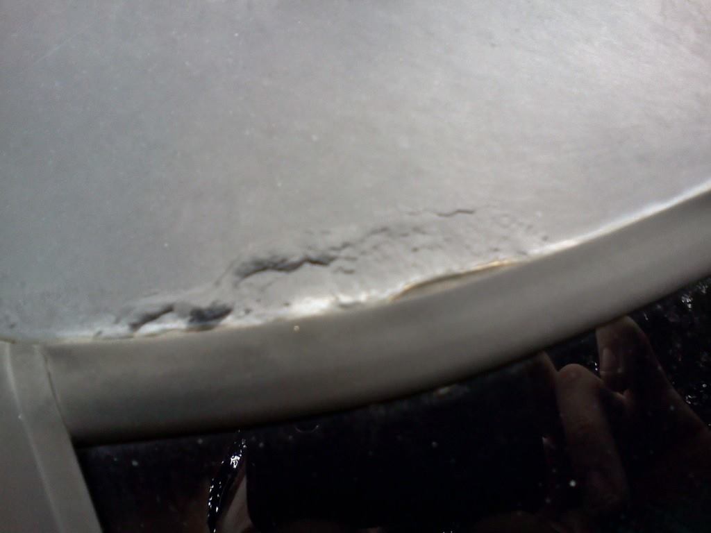

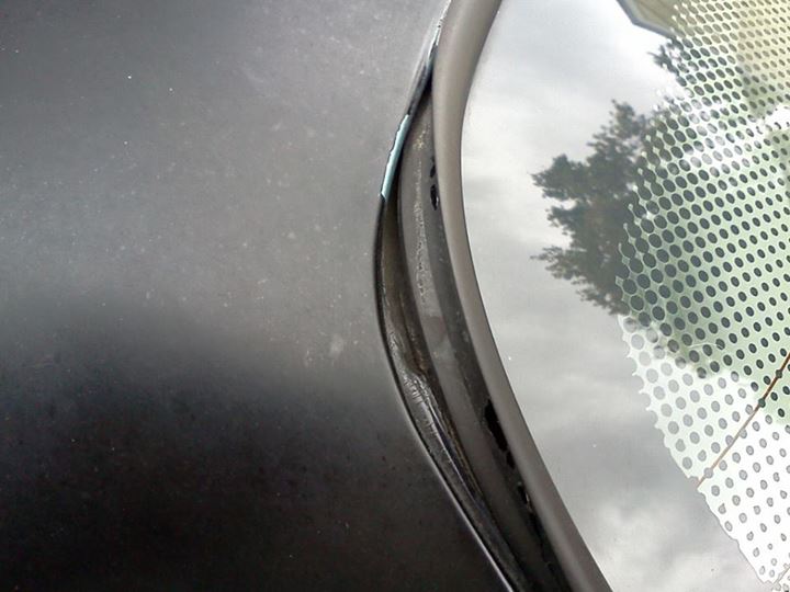

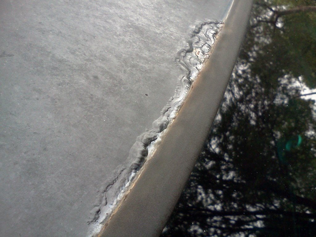

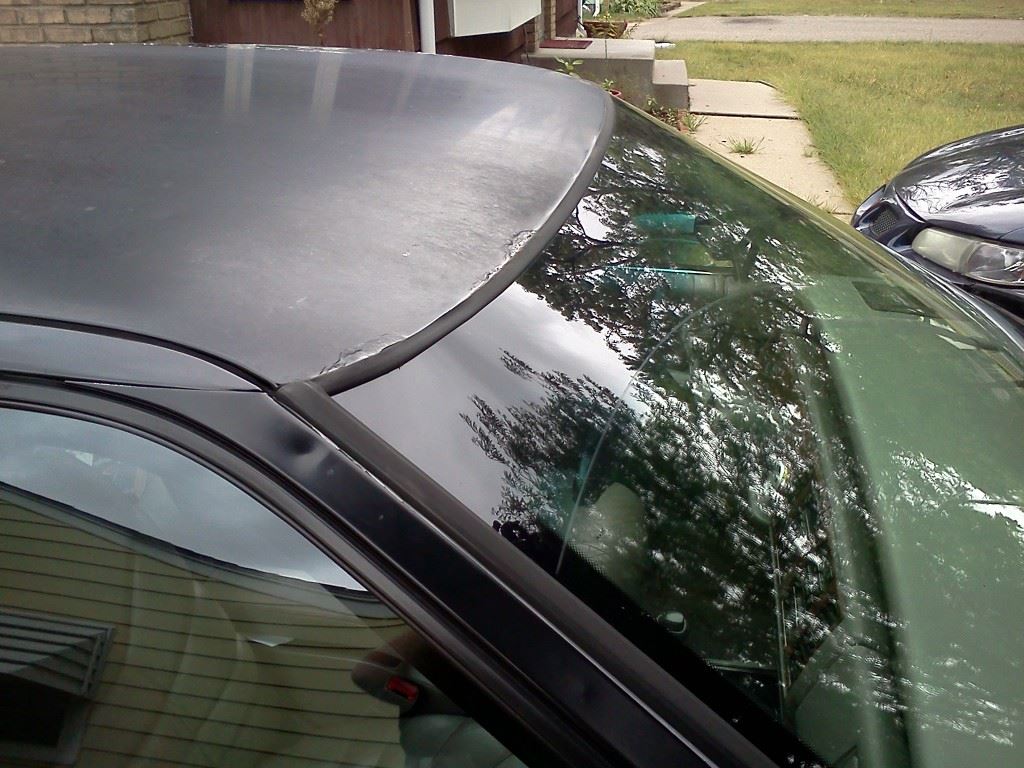

9RegalGS2 Posted October 3, 2013 Report Posted October 3, 2013 i have some water that comes in.car does need a windshield badly but i have rust that needs to be addressed.is it something i can do on my own after the windshield is out?whats involved?any advice would be appreciated.. also in the rear window the molding is coming up what can be done to remedy that? Quote
l67ss Posted October 3, 2013 Report Posted October 3, 2013 Cut out the rust replace new metal 9RegalGS2 said: i have some water that comes in.car does need a windshield badly but i have rust that needs to be addressed.is it something i can do on my own after the windshield is out?whats involved?any advice would be appreciated..also in the rear window the molding is coming up what can be done to remedy that?[ATTACH=CONFIG]14048[/ATTACH][ATTACH=CONFIG]14049[/ATTACH][ATTACH=CONFIG]14050[/ATTACH][ATTACH=CONFIG]14051[/ATTACH] Quote
Euro Posted October 3, 2013 Report Posted October 3, 2013 (edited) Gah, my Lumina had that in one of the corners. It drove me insane, but never spread in the time I owned it. I say if it needs a new windshield, pull it and try to see how bad it actually is? I'm sure a good sanding, prepping, and painting would deter it somewhat at least. Edited October 3, 2013 by Euro Quote
BrianG Posted October 3, 2013 Report Posted October 3, 2013 (edited) My TGP has this too. Doesn't appear to be spreading at any rapid rate however, but it's an eyesore and a worry. I would imagine that after the windshield is out, standard rust removal and treatment to the metal would be in order to repair it properly. Get rid of the rust, seal the bare metal, put the windshield back in. There should be some good rust deterring rattle cans of paint at any good auto parts store. For the rear window molding, I would have the old stuff ripped out and new stuff installed. When a glass replacement shop puts in a new back window, they have generic stuff that matches pretty well that they install, so I would think that any glass repair place should be able to replace that. Edited October 3, 2013 by BrianG Quote
rich_e777 Posted October 3, 2013 Report Posted October 3, 2013 Wire brush attachment on a drill or some elbow grease first to see how far it has set in. Pulling a windshield out your self isn't really that hard, setting one back in is even easier. On my CS it has guide clips so it can only go in one way. Clear silicone for household window applications and bam there you go. The weather stripping might need replacing but I believe you can get away with removing it carefully and you might be able to re-use it. A suction cup handle will make re-installation a breeze but if you do not have one set the bottom first and then lean the top in, and wear rubber padded gloves to grip the windshield better so you don't drop the first one and have to go back for a second. Quote
intern8tion9l Posted October 4, 2013 Report Posted October 4, 2013 Hit it with an 80 grit sanding disk on an angle grinder when the windshield is out. That should get it down to good metal that you can prime and paint Quote

GnatGoSplat Posted April 4, 2014 Report Posted April 4, 2014 Whatever you do, don't use silicone! [video=youtube;SLTtkS23S64] If you're going to DIY, at least buy the proper urethane adhesive and primer! It's not that hard to find, you can buy it at any paint shop that sells automotive paint and supplies. I bought some before to glue the back window back into place on my convertible. Urethane windshield adhesive has a tensile strength of 1200psi and can stretch 7.5x its original strength before breaking. Adhesive silicone, tensile strength 218psi and can stretch only 3.5x. Silicone is a really BAD idea. On the rust, I'd probably grind off as much as possible, treat with phosphoric acid like Naval Jelly, then prime with a rust-preventive primer like POR-15. Then a skim coat of filler, sand smooth, prime, and paint. Quote
9RegalGS2 Posted April 4, 2014 Author Report Posted April 4, 2014 im having trouble finding the time ,and im apprehensive about trying to take the glass out (never pulled glass) dont wanna mess up the channel or anything.....any good tips for removing?and if i use filler ive heard you should fiberglass sheet over it when done to keep moisture out? Quote
GnatGoSplat Posted April 4, 2014 Report Posted April 4, 2014 Can't say I've ever heard of anyone putting fiberglass over filler. Usually it's the other-way around. I was just thinking your rusty spot probably was mostly just pitted with maybe tiny pinholes at the worst. Hard to say without taking the bubbled paint off, but I was just assuming for pitting and/or pinholes, a very light skim coat of filler, like less than 1mm thick would all you'd need to bring the pitted area back to the level of the good metal. A rust-preventive sealing primer should be all you need to keep moisture out. Fiberglass is more for larger repairs than light surface stuff. It's also a major bitch to sand smooth, which is why when people use fiberglass for a repair, they usually use filler on top of that for finish work and smoothing. Now, if you remove that rust and find a large hole, then it would be best to have some new metal welded in there. Quote
