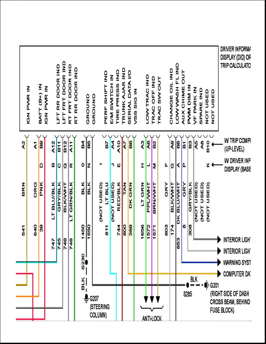

Imp558 Posted August 27, 2014 Report Posted August 27, 2014 I pulled one out of a 97, and Alldata has it wrong, does anybody have a pinout for this guy? This DIC is going to suck making it fit in the dash, if anybody has a smaller one for another car and would rather have this one I would be totally down with trading. Quote
Imp558 Posted August 28, 2014 Report Posted August 28, 2014 (edited) I found it: Now for a stupid-er than usual question. How do I get it to stop jumping automatically to the "Oil Life" reading and saying "LOW"? Edited August 28, 2014 by Imp558 Quote
