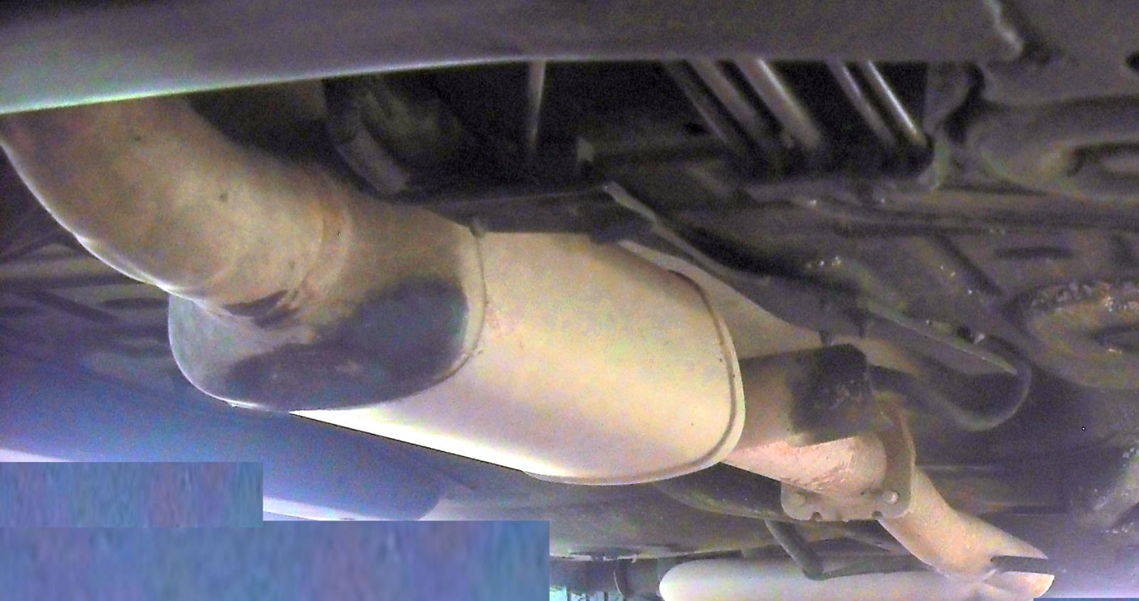

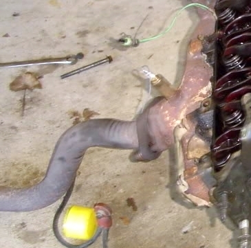

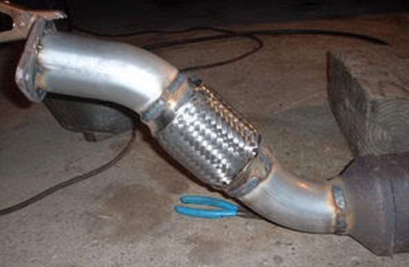

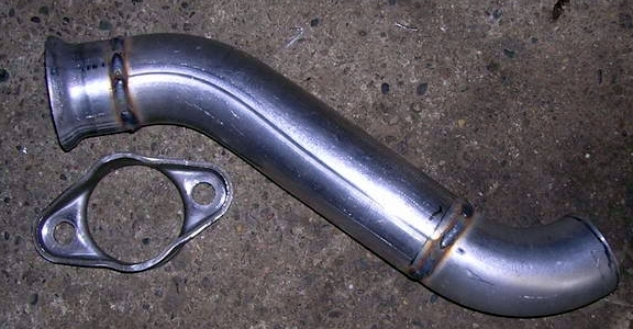

ive added some pic's ive had and found.
pic #5 is what id like to have done and welded up

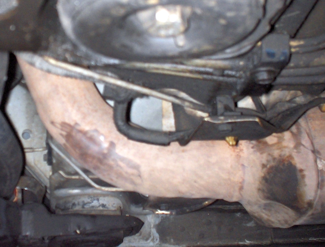

This is mine thats currently on the car, until I get headers
