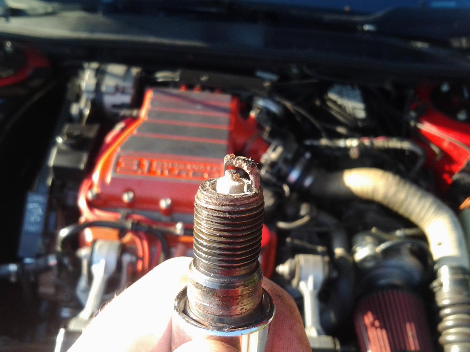

redgrandprix Posted October 2, 2013 Author Report Posted October 2, 2013 so i checked the front 3 plugs and HOLY BALLS! far right plug (drivers side closet to turbo) was the worst looking spark plug i have ever seen short of total failure it had so much buildup on it, picked up new ones that will be put in tomorrow hopefully that will fix it. Quote
RobertISaar Posted October 2, 2013 Report Posted October 2, 2013 the rear is the same, the side closest to the driver always has the worst looking plug, even with no mechanical problems. Quote
redgrandprix Posted October 2, 2013 Author Report Posted October 2, 2013 i don't understand though how they got so bad so fast i just changed them this summer Quote
RobertISaar Posted October 2, 2013 Report Posted October 2, 2013 pics of them? can usually determine why from a visual inspection. Quote

redgrandprix Posted October 3, 2013 Author Report Posted October 3, 2013 this is the worst one, all were whitish with what im assuming is carbon build up from burning oil, Quote
