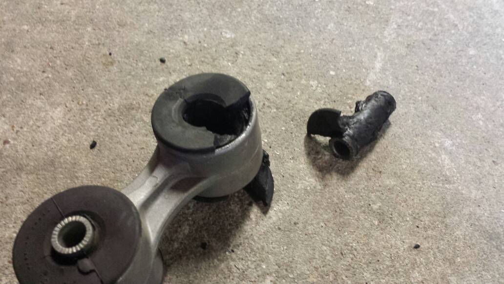

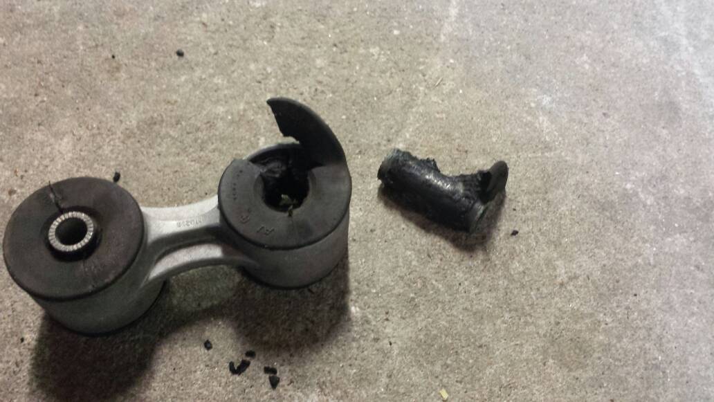

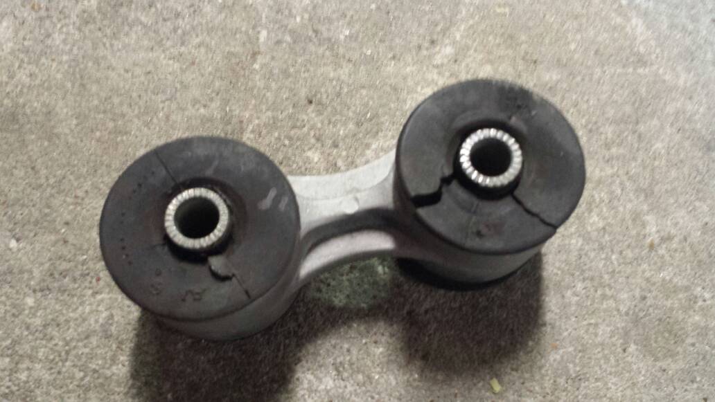

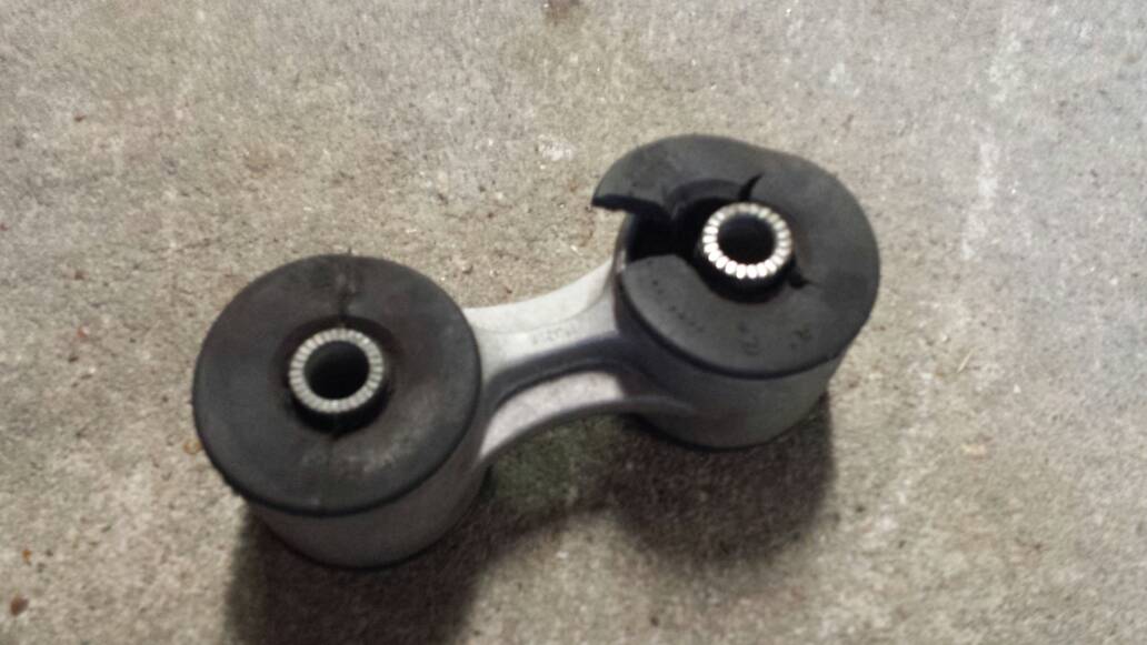

ThumpInTheTrunk Posted September 13, 2013 Author Report Posted September 13, 2013 Replaced the dog bone today. The old one was waaay past due lol. Look at this thing: Sent from my SAMSUNG-SGH-I337 using Xparent Red Tapatalk 2 Quote
