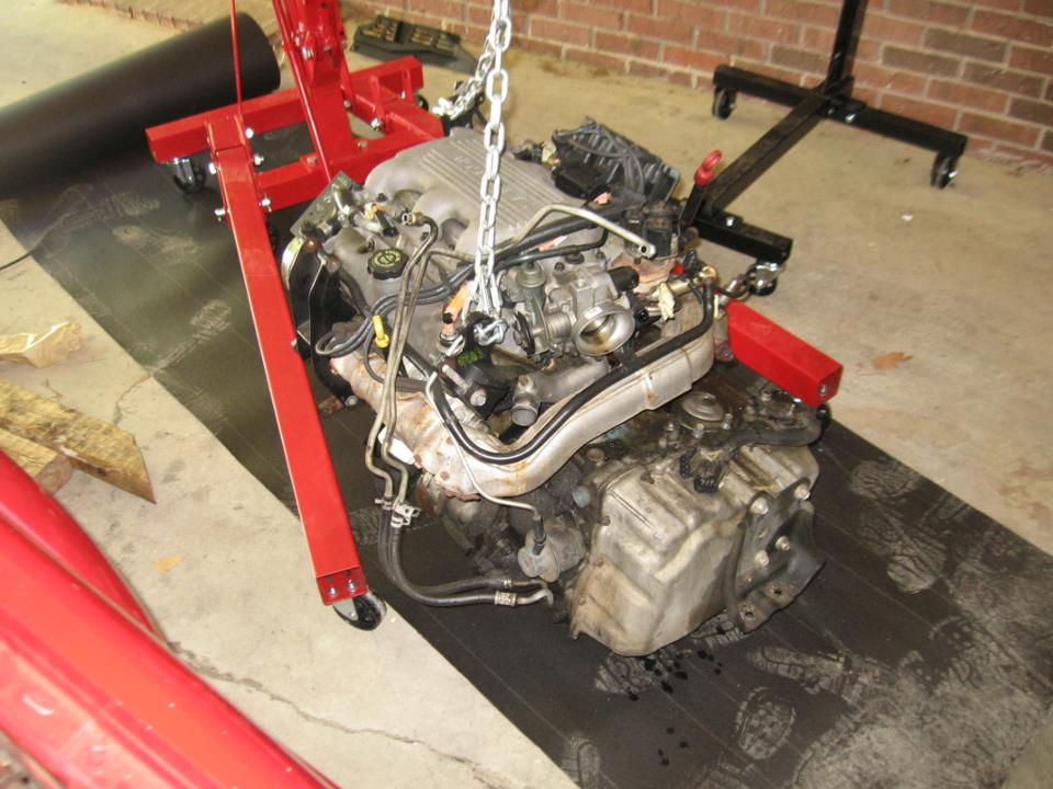

EMNCFI Posted October 26, 2013 Author Report Posted October 26, 2013 So if I were to give pulling the engine a try, is it easier to pull it with the tranny or leave the tranny in? Quote
EMNCFI Posted October 28, 2013 Author Report Posted October 28, 2013 Ok, so this will become a new thread, I thought about a new thread, but I think I will modify this one to: My TGP restoration. The plan is that at the end of this, which will take a couple of years, I will have a totally restored show quality TGP. The project consists of the following: Engine rebuild, turbo rebuild, A/C swap to R134a and get it working, front seat refinish, wheel refinish, complete repaint, and then some small things like a new turbo blanket, getting the vacuum system leaks fixed. Step one has started, the turbo is out and sent off for rebuild, and while its out, I am doing the R134a swap. Quote
john koehler Posted October 29, 2013 Report Posted October 29, 2013 Every time I pull engines on these (my personal ones too) I ALWAYS pull the tranny with the engine. Likewise, I pull the engine when I need to service the tranny. If you are working without a lift, I find it easiest. I jack it up high, undo the exhaust manifold to downpipe bolts first, then drop it down to a workable height for engine pull. Everything else gets accessed from topside or wheelwells. Gotta remove the master cyl though, but if I am pulling the power package, might as well take care of a few other things... good luck!! Its easier than you think!! Quote
