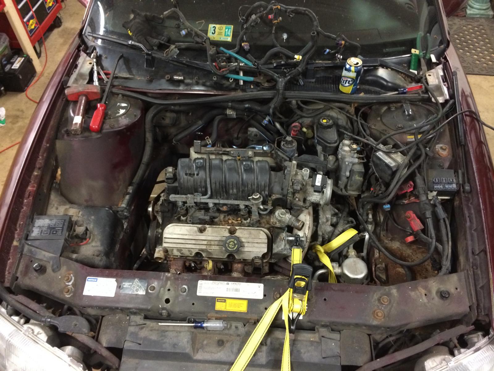

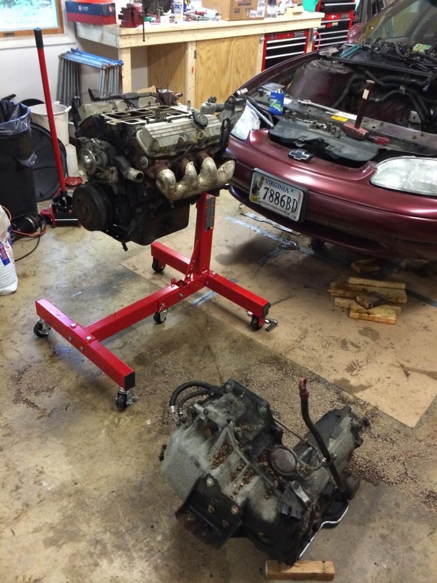

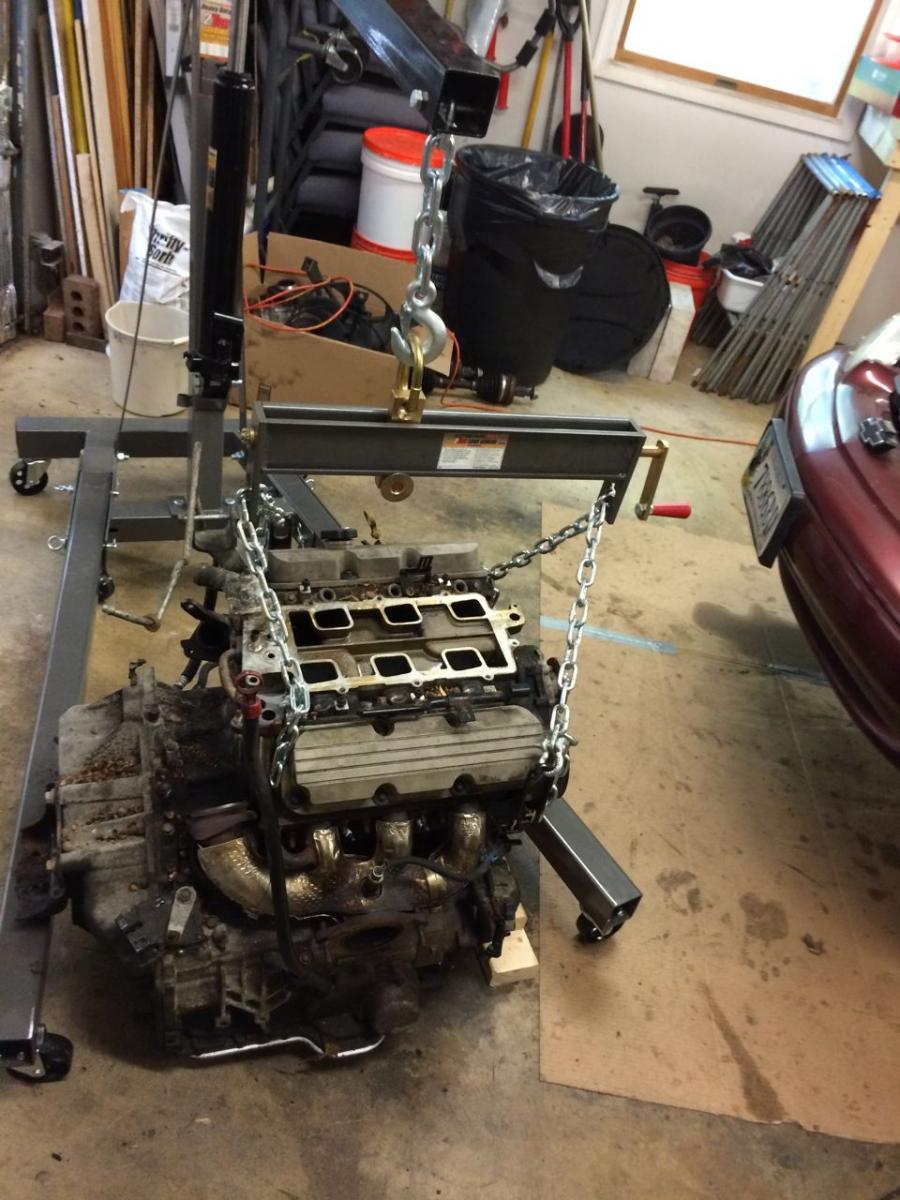

LumiLTZ Posted May 13, 2014 Author Report Posted May 13, 2014 Engine/trans is out. Need to finish pulling apart the bad engine and then go obtain another one. Quote
LumiLTZ Posted May 13, 2014 Author Report Posted May 13, 2014 Couple of pics from today's activity... Quote
Night Fury Posted May 13, 2014 Report Posted May 13, 2014 Sweet!!! Gotta love the engine bay shot- its the official rewarding halfway point! Quote
LumiLTZ Posted May 13, 2014 Author Report Posted May 13, 2014 Sweet!!! Gotta love the engine bay shot- its the official rewarding halfway point! It is indeed... I also have rewarded myself with a 12 pack thus far. Quote

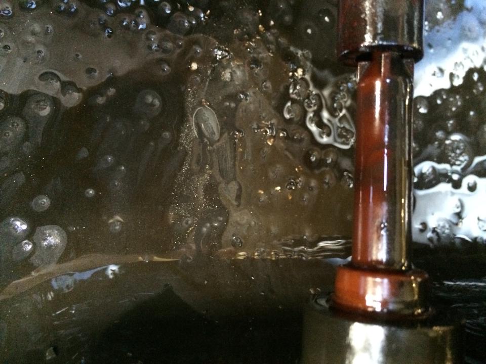

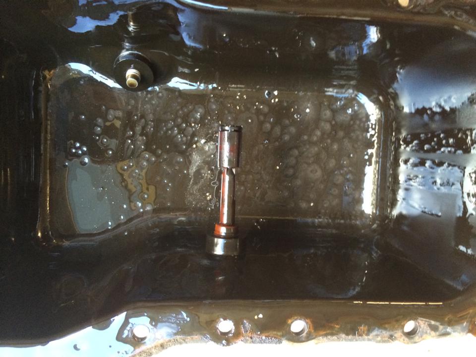

LumiLTZ Posted May 14, 2014 Author Report Posted May 14, 2014 I guess it's since you live on the VA side of the DC metro area and you need a salary of 150k to live decent out there lol Yea, it's expensive for sure around these parts... I think of all the cool cars I could have if I lived somewhere cheap (like NW Ohio where I grew up). Anyhow, I tore into the engine some more... pulled the LIM, valve covers, oil pan, and other various brackets I didn't pull yet. It doesn't look pretty... lots of 'gold' in the oil pan... Quote
Nas Escobar Posted May 14, 2014 Report Posted May 14, 2014 That's not good at all. Sent from my HTC using Tapatalk. Quote
LumiLTZ Posted May 14, 2014 Author Report Posted May 14, 2014 Yea not good indeed. LIM gaskets looked sketchy and I'm thinking their failure might've done this engine in. The wife had taken it in for LIM gaskets around 145k shortly after she bought the car as it was using coolant, so it's plausible some damage had been done then too. Quote

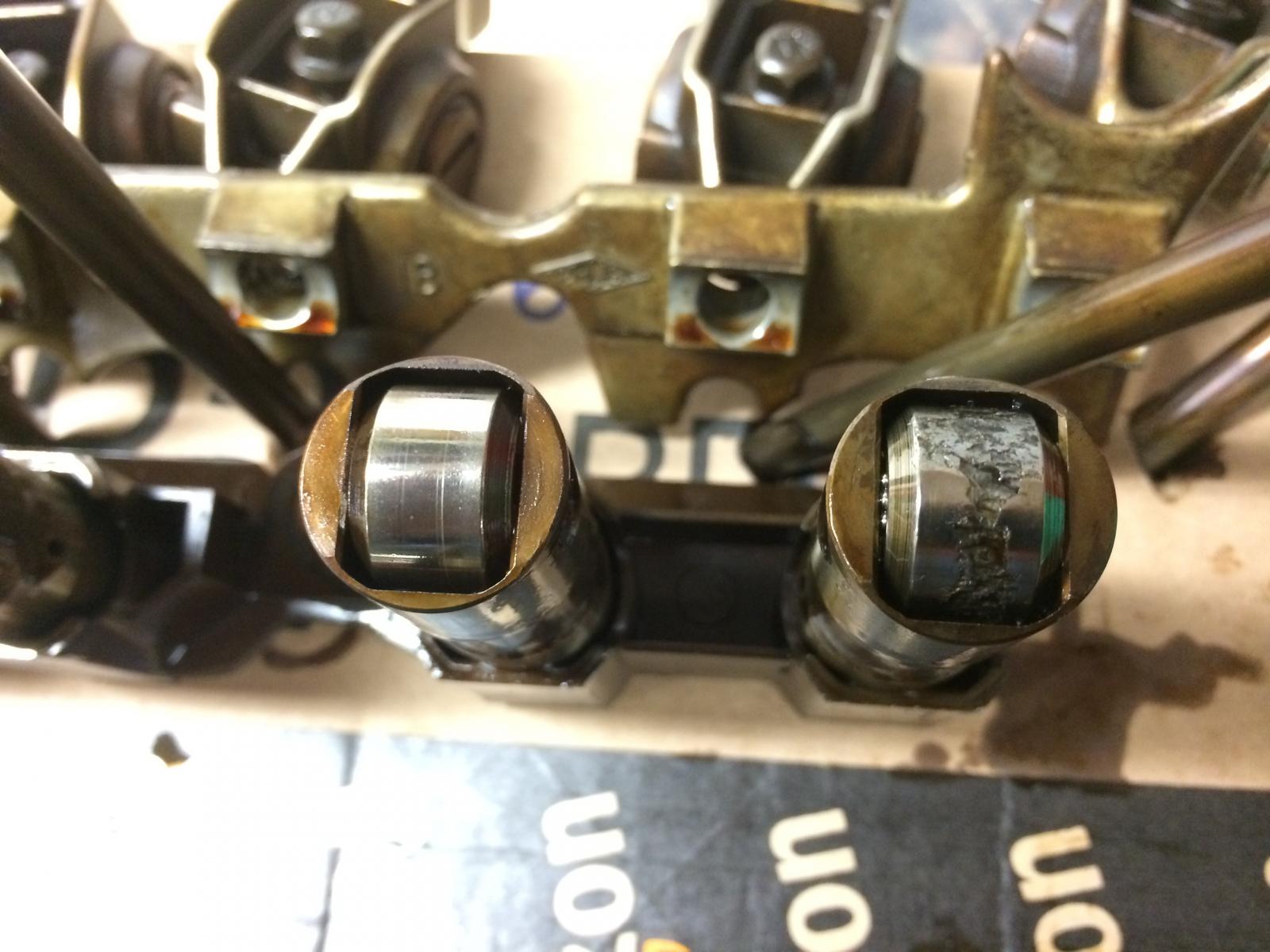

LumiLTZ Posted May 14, 2014 Author Report Posted May 14, 2014 Well, wasn't anything in the bottom end, I spent a little time this evening on it and pulled the rocker arms/pushrods/lifters... And found lifter carnage on cylinder #6. Quote
