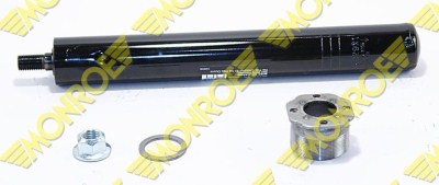

So, in tracking down the clunking in my TGP's front end I want to make sure I've checked EVERYTHING. The front strut inserts, I have Monroe sensatracks in it. They include a big washer.... where does that go? on top of the cart or in the tube on the bottom???
On top.
