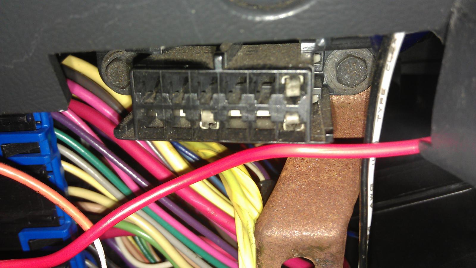

Nas Escobar Posted August 21, 2013 Author Report Posted August 21, 2013 I found it, but it has.... 3 wires... Idk what to do now Quote
RobertISaar Posted August 21, 2013 Report Posted August 21, 2013 3 can be correct, depending on the vehicle. all you really need are the A and M pin, everything else is vehicle specific. Quote
Nas Escobar Posted August 21, 2013 Author Report Posted August 21, 2013 Well here is the ODB1 plug on my car. 3 plugs so idk which ones to jump. I tried the top and bottom and it wouldn't blink. Then I tried the 2 on the bottom and same result. The 1994 Cutlass Supreme Convertible wasn't ODB1.5 was it? Quote
RobertISaar Posted August 21, 2013 Report Posted August 21, 2013 no W-body was ever 1.5. it may have been refered to that in the past, but it was incorrect. the 94-95 3.4 don't blinkout codes on the SES like some earlier cars did. Quote
Nas Escobar Posted August 21, 2013 Author Report Posted August 21, 2013 no W-body was ever 1.5. it may have been refered to that in the past, but it was incorrect. the 94-95 3.4 don't blinkout codes on the SES like some earlier cars did. So in this situation..... how do I find out what triggers the "SES" light the next time I cold start it and I let it boggle the way it usually does? Because once this car gets to 200F the car drives smoothly with no issues at all. Cuz it also disappears after a while, it's not a light that stays on like the ODB2. It clears itself. Quote
RobertISaar Posted August 21, 2013 Report Posted August 21, 2013 scanner or ALDL cable. the light shuts off when the error condition is no longer present. it will still be stored as a history error code though. Quote
