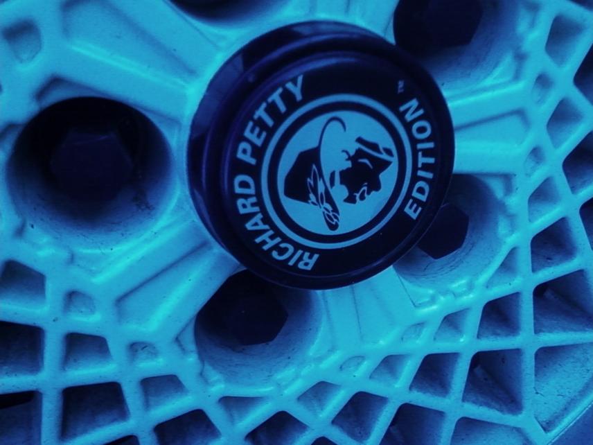

What rims would fit my 92 grand prix RPE? I have been looking at 5 lug bmw rims would those work? Any opinions or advice for me? post-8333-14368913507_thumb.jpg
