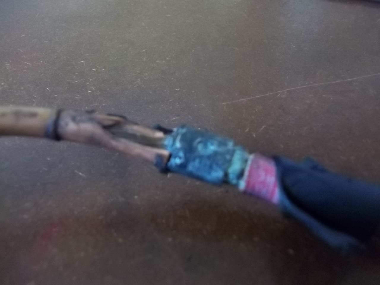

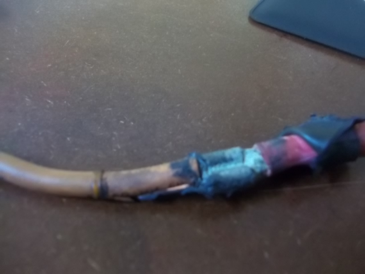

There is an in-line fuse between the battery and the alternator, does anyone no the location ? Its driving me nuts trying to find it.
there should be two fusible links IIRC.... where the alternator charge wire runs to the starter terminal and where the battery wire meets in the same location.

not green! :lol:
I would clip it off completely back to the red wire of bigger diameter. strip off clean copper and crimp a brand new fusible link from the parts store. also I bet your block's ground strap is going to look the same.
