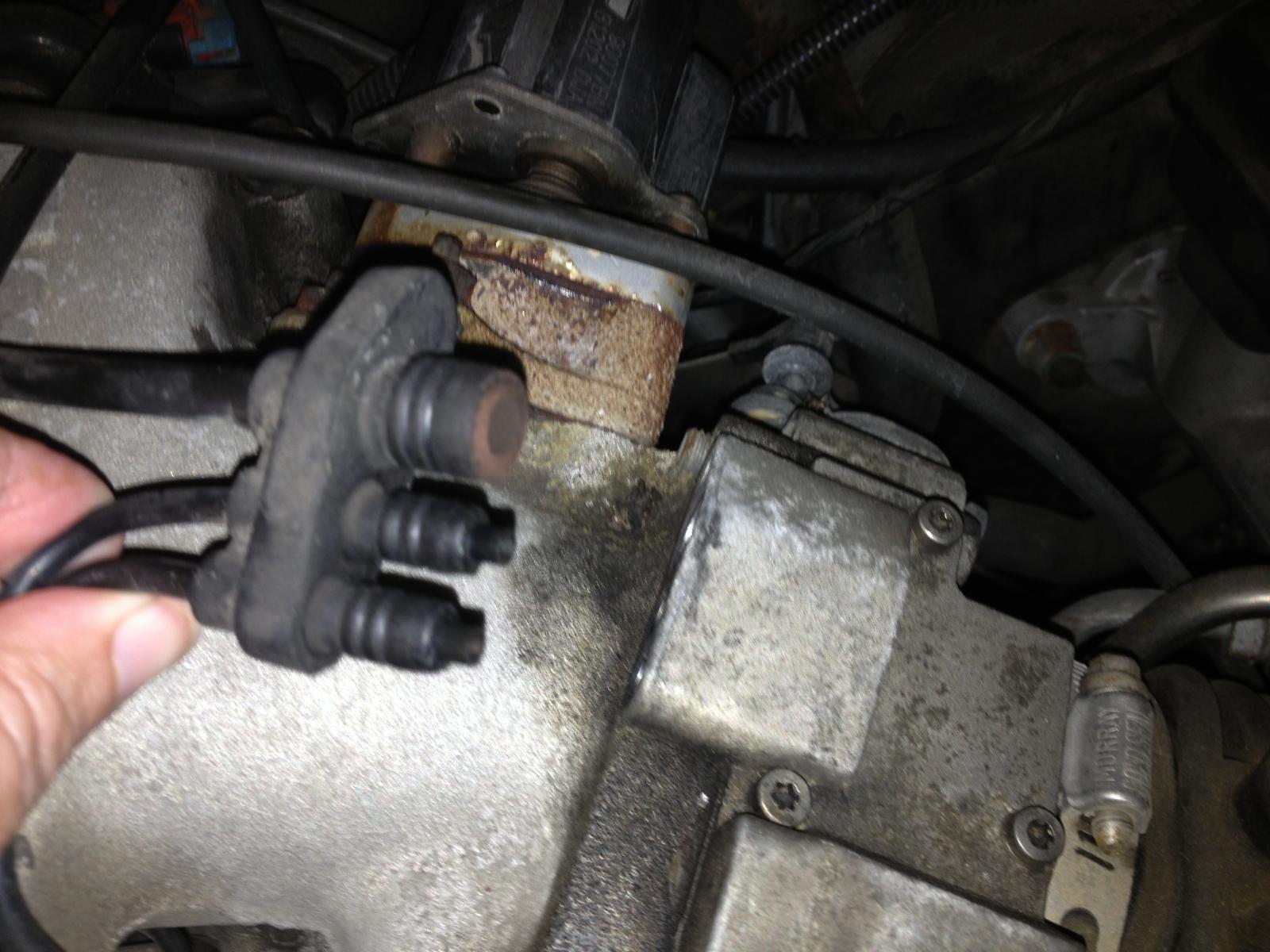

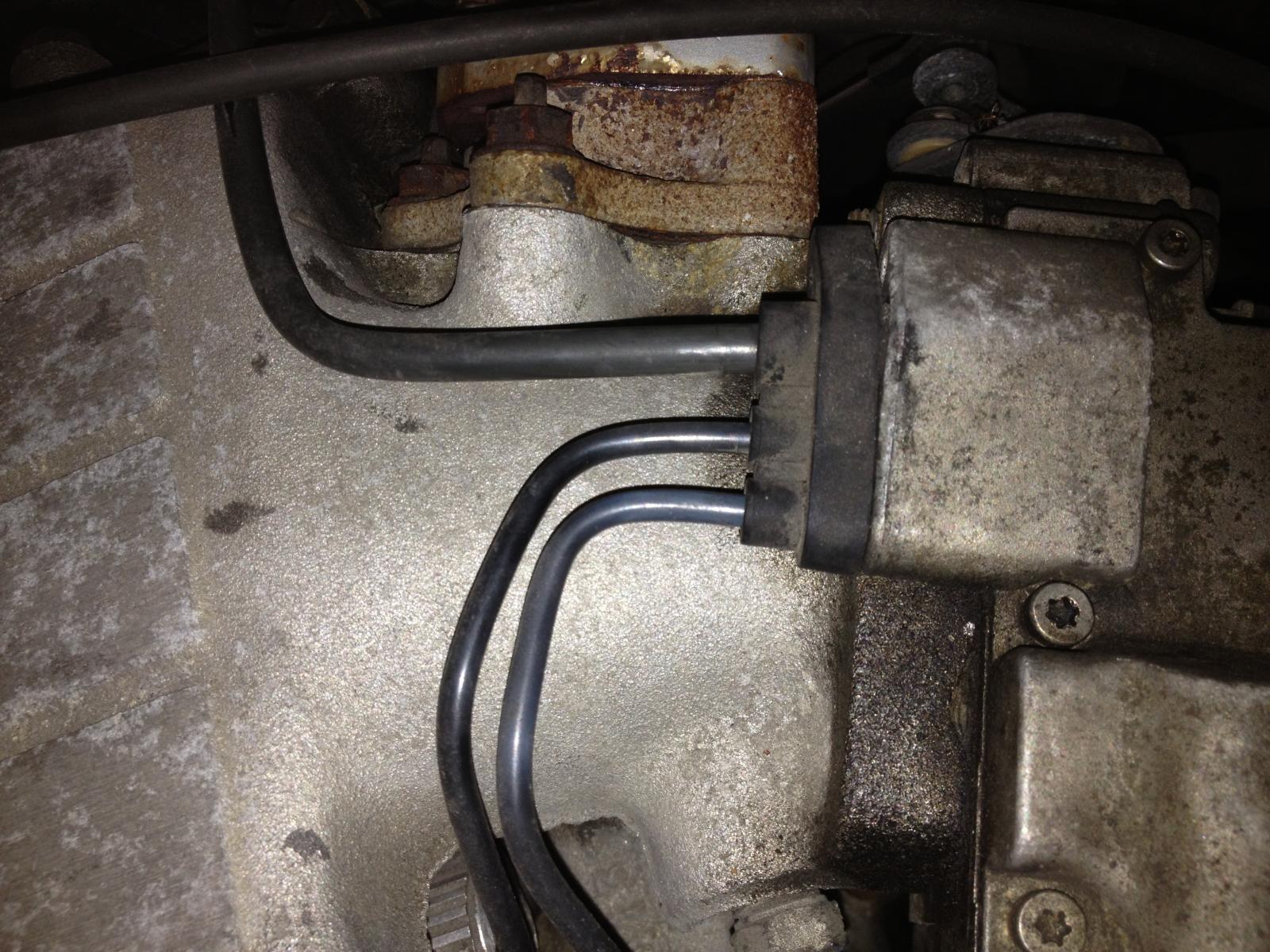

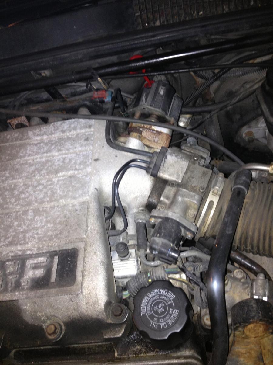

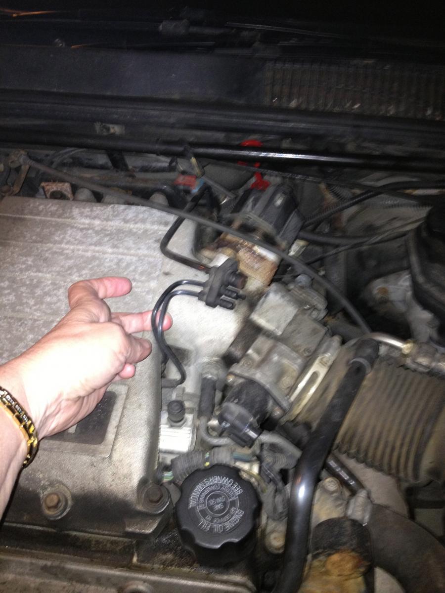

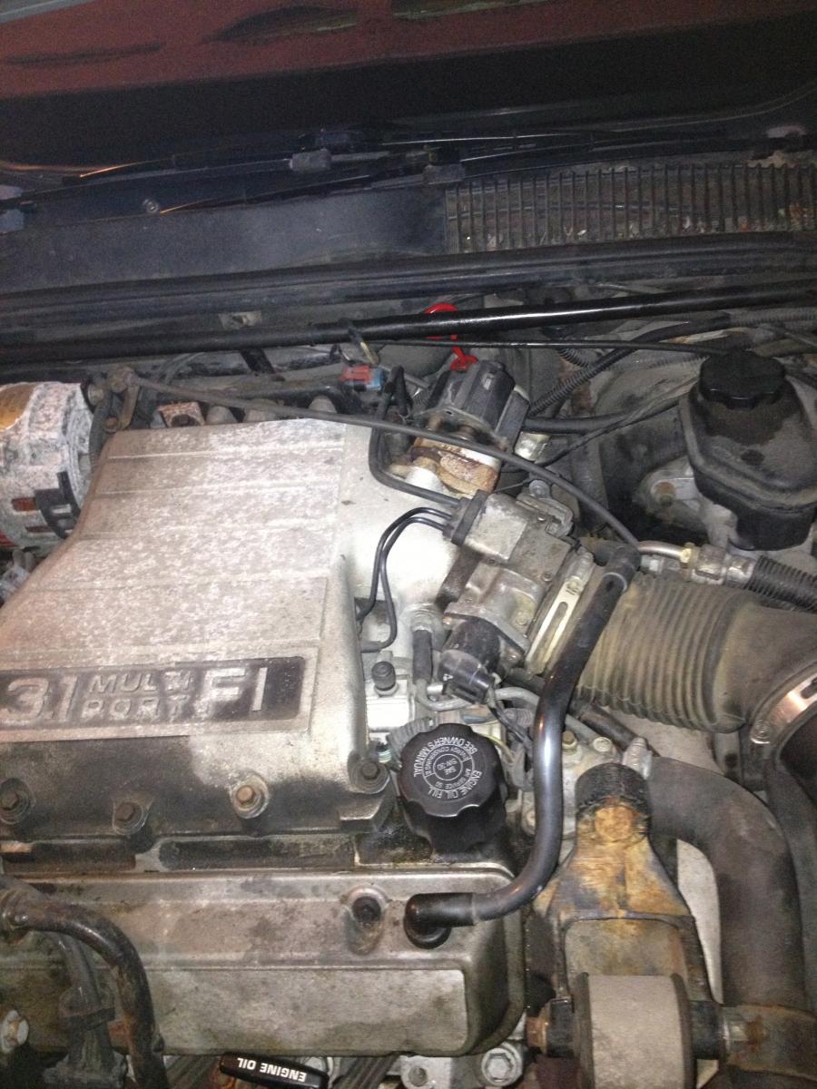

KarenL2888 Posted July 2, 2013 Report Posted July 2, 2013 It was unplugged....causing the check engine light. But it ran great. Now the oil change guy plugged it in....and she stalls when at red lights. Quote
GP1138 Posted July 2, 2013 Report Posted July 2, 2013 A vacuum junction block?? Those are various and sundry vacuum lines.. Also, moving this to Powertrain as this is not CSC specific... Quote
RobertISaar Posted July 2, 2013 Report Posted July 2, 2013 yeah, that's the main vacuum point for a LH0... engine should run horribly with it unplugged, it's a huge vacuum leak. after a few(usually failed) starts, the ECM quits looking at the MAP sensor signal and goes into a weird fueling mode that pretty much throws gas in, hoping that the O2 sensor can correct for it. if it's stalling now with it plugged in, i'd considering doing an ECM reset to have it relearn the necessary IAC values, since it is probably still used to the gigantic vacuum leak that was there before. it will be commanding an abnormally low amount of airflow, causing a stall. if it still runs bad after an IAC relearn, i'd look at the MAP sensor or it's hardline as being bad. possibly the CCP solenoid stuck wide open too. Quote

Go4DaMo Posted July 9, 2013 Report Posted July 9, 2013 Those'll pop out if you don't crank the engine long enough to start it. Have seen them ziptied on before. Quote
GnatGoSplat Posted July 9, 2013 Report Posted July 9, 2013 I've seen some 3.1Ls have a plastic cover over them to keep them plugged in. Idle relearn as Saar mentioned is probably what it needs to run right. IAC could also be sticking, I've had that happen before and was able to fix a sticking IAC by cleaning the threads and lubing with motor oil. Unplugging it was probably somebody's idea of a fudge-fix. Quote

Night Fury Posted July 11, 2013 Report Posted July 11, 2013 Yeah you need that. Mine popped off a couple weeks ago and it ran so bad it nearly left me stranded. Popped hood, slipped those bad boys back in, Voila! I'm sure it just needs a relearn. If you just keep driving it, it should 'learn' that way also and stop stalling after a few days. As others have said Quote
MonzaRacer Posted July 14, 2013 Report Posted July 14, 2013 That sends vacuum to all sorts of things including some versions fuel pressure regulator, accessories, EGR, pcv. Try disconnecting negative from battery for few minutes then restart and drive for bit so it can relearn. Basically it was a huge vacuum leak and defaulted some other stuff thats vacuum operated Quote
