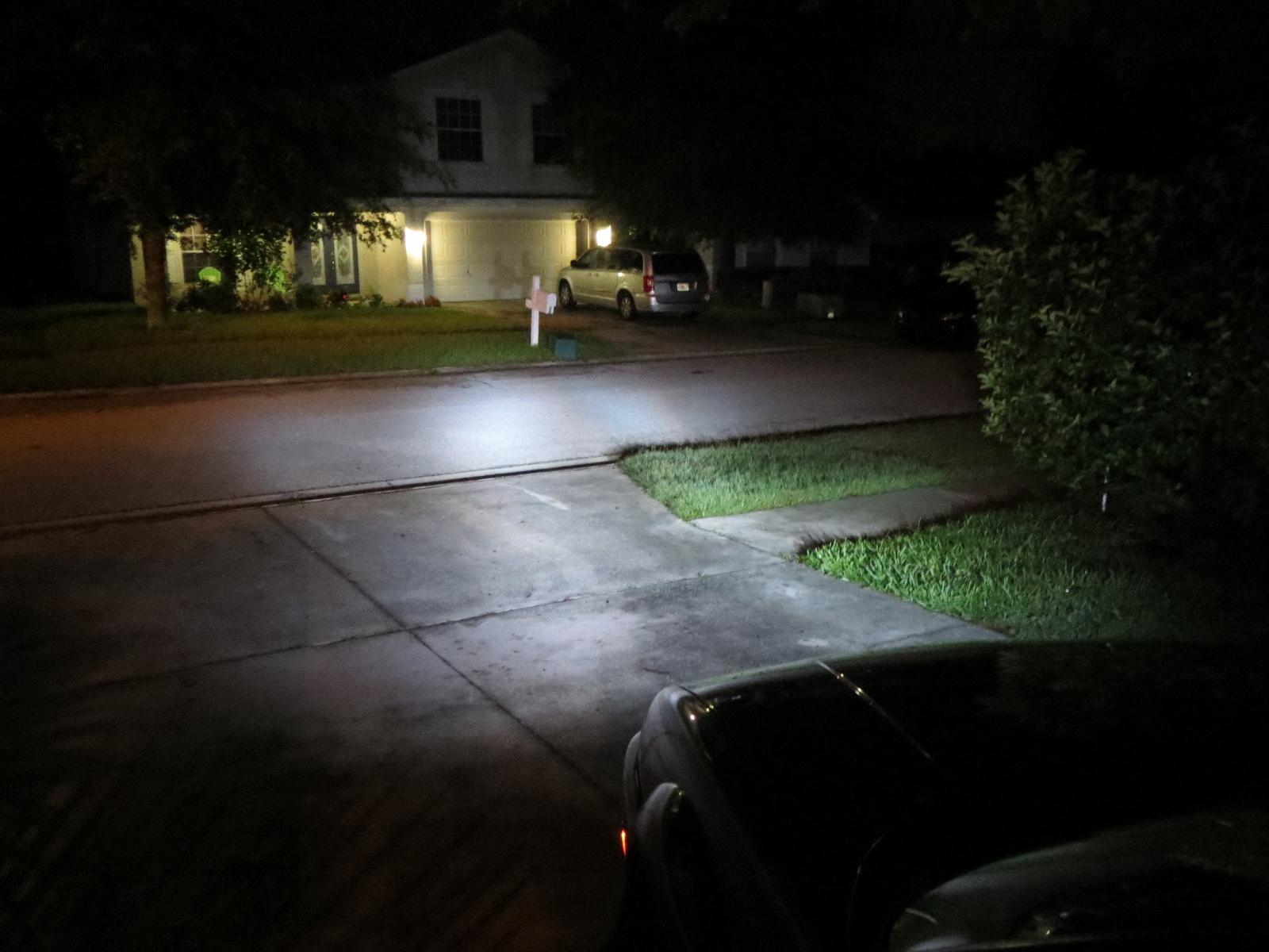

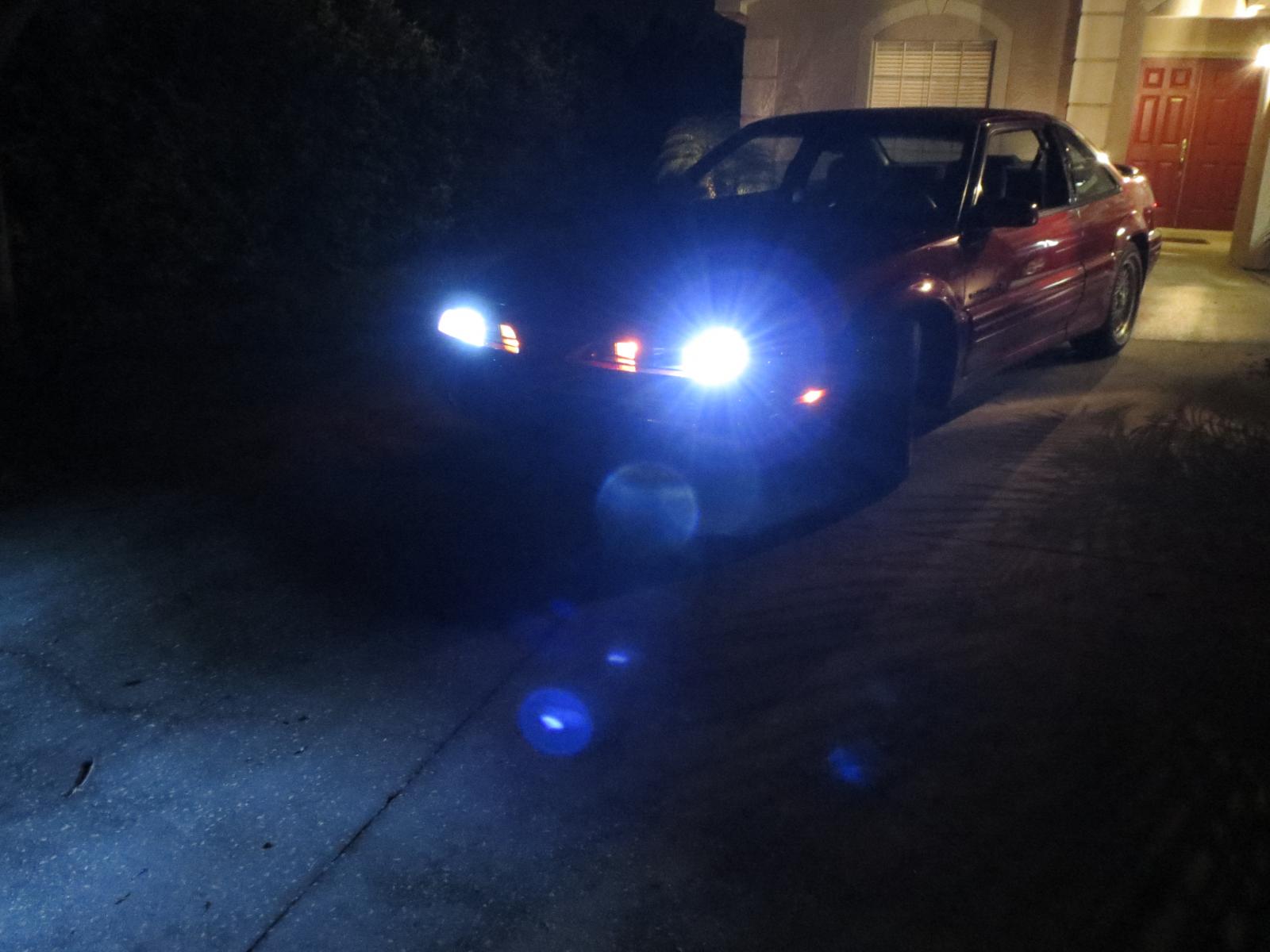

GnatGoSplat Posted July 9, 2013 Report Posted July 9, 2013 Miniquads have always been shit for lighting, even when they came out. Most are made of glass (mine all were) so yellowing plastic is not the problem. They are just way too small for reflector housings. I put cheap-ass Chinese HIDs in mine. Big improvement, and the lights are too small to blind anybody. Quote
