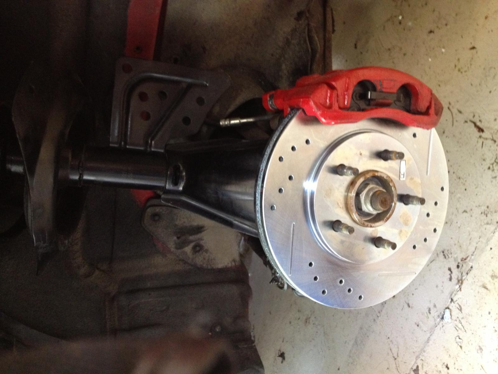

Reride Posted June 29, 2013 Report Posted June 29, 2013 Since I plan on painting the calipers and using braided lines. When I got my '96 front brake set up I took everything from the bearing pad to the caliper to the brake line as a unit. That way I can have everything prepped and ready before they are installed including bushings, ball joints, & rod ends. Quote
