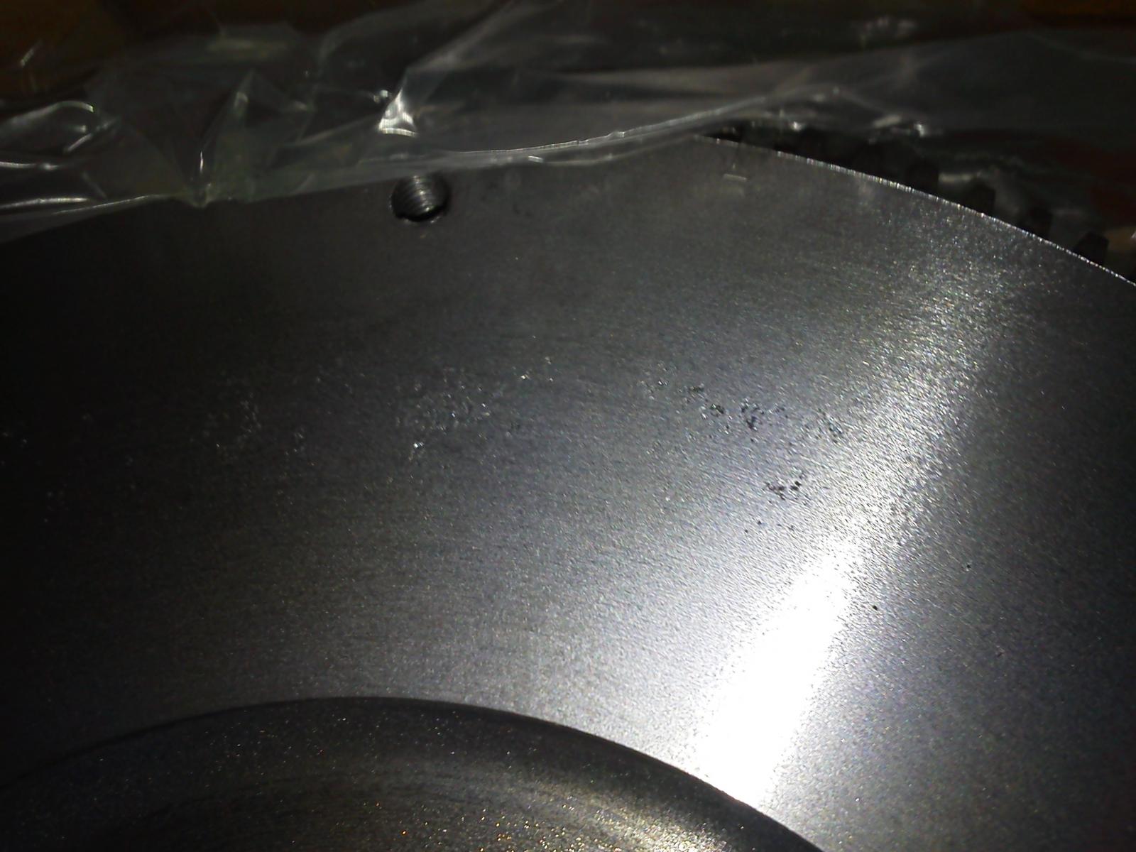

carkhz316 Posted June 23, 2013 Report Posted June 23, 2013 I've machined down 2 RhinoPac brand flywheels in a row now and both have a couple dime sized spots with tiny champagne bubble sized air bubbles in the clutch face of the casting. Will this hurt my stupid expensive Spec clutch? I can't see it being much different functionally than a drilled and slotted brake rotor. What are your thoughts? Is it safe to run or should I return it as a defect as I did with the first one? Quote
19Cutlass94 Posted June 23, 2013 Report Posted June 23, 2013 I wouldnt use it. Also, how far down are you machining these? If they are brand new, you dont have to surface them. Quote
carkhz316 Posted June 23, 2013 Author Report Posted June 23, 2013 I'm finishing up (trying to) my 284 swap into my Monte and yes they are new, but have to be machined down to .84". This takes just over 1/4" inch of material off the original thickness. Both have been brand new (1st from Rock Auto, 2nd from Amazon). I'm thinking I'm going to cave and just buy the AC Delco one on RA this time. Quote
RobertISaar Posted June 23, 2013 Report Posted June 23, 2013 ahh, casting porosity.... this has made me a lot of money since the age of 19, i sorted a lot of parts to certify them as good/scrap, if i had to guess i'd say Rhino went through the same process and called them good enough. it doesn't look that bad and i doubt you would have trouble with them. that being said, i wouldn't be too happy about receiving two of them that looked that way. Quote
19Cutlass94 Posted June 23, 2013 Report Posted June 23, 2013 (edited) If you take 1/4" off a 284 flywheel, and shift it at 6K rpm, I promise itll fly apart. These flywheels are not that thick to begin with. Get a new one, make sure its flat ( do no surface the flywheel ) clean it up, then put it on. No need to machine it, especially 1/4" of machining. I didnt even think you could take 1/4" off these flywheels.. Edited June 23, 2013 by 19Cutlass94 Quote

carkhz316 Posted June 23, 2013 Author Report Posted June 23, 2013 If you take 1/4" off a 284 flywheel, and shift it at 6K rpm, I promise itll fly apart. These flywheels are not that thick to begin with. Get a new one, make sure its flat ( do no surface the flywheel ) clean it up, then put it on. No need to machine it, especially 1/4" of machining. I didnt even think you could take 1/4" off these flywheels.. I should have clarified that this a stock F-body 3.8 flywheel. It's original thinkness is somewhere around 1.10". In order to bolt a 284 up to a 3.8, it has to be machined down to .84" At this thickness, there is still plenty of flywheel left. Quote
carkhz316 Posted June 23, 2013 Author Report Posted June 23, 2013 Shouldnt matter really. Only flywheel that'll work is a 282/284 flywheel, since a 3800 ( w-body ) never came with a 5spd. So you should be able to bolt it on and go. Ive got a brand new spare sitting in the trunk of my car, and its nowhere near .84". Trust me, this will work. It is how it is done as there are dozens, if not hundreds of Fiero, Grand Prix, and other car guys that have successfully bolted a 282/ 284 to a 3800. My concern is the porosity in the flywheel face an issue in any application? Quote
19Cutlass94 Posted June 23, 2013 Report Posted June 23, 2013 (edited) ok ya, makes sense now. In that case, yeah Id get another flywheel. You want your surface of the flywheel to be completely smooth/flat. Youll ruin a clutch disc quickly if its not. I think I was just confused on what engine you were using. Edited June 23, 2013 by 19Cutlass94 Quote
