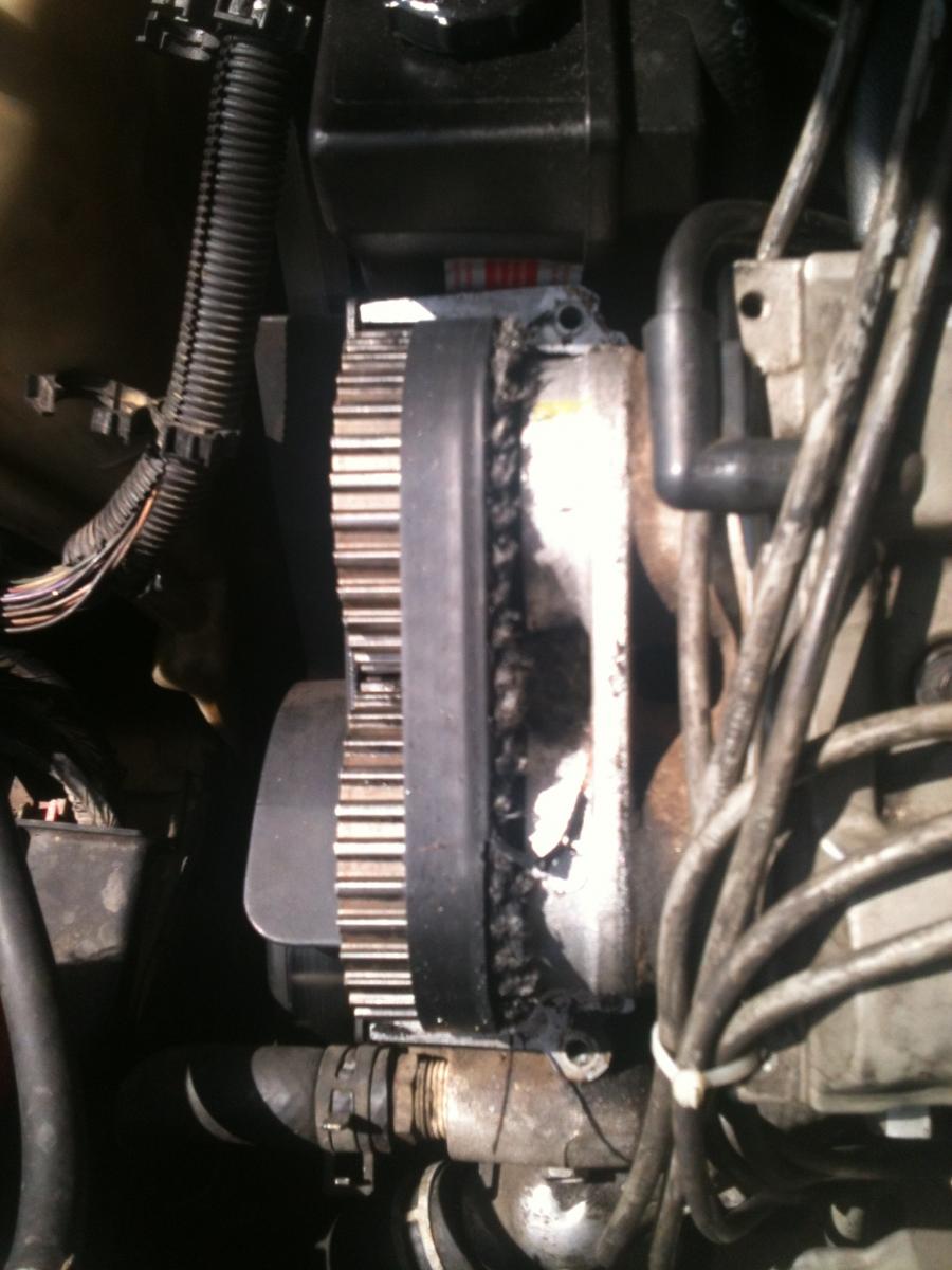

J.r. Patton Posted June 14, 2013 Report Posted June 14, 2013 Is a 95 LQ1 an interference engine? I had the timing belt redone and it died about 3 weeks later I took the timing belt cover off and the inside of the belt is gone. only about half the width of the belt is left. Quote
Galaxie500XL Posted June 14, 2013 Report Posted June 14, 2013 '95 and earlier are NOT interference engines. '96-'97 ARE. However, I'd say if you recently had the belt redone, and half is missing, either the idlers and tensioner weren't replaced, and are bad, or something is severely misaligned. When my hydraulic actuator failed at 35,000 miles, the timing belt looked almost as good as it did when I installed it. Is a 95 LQ1 an interference engine? I had the timing belt redone and it died about 3 weeks later I took the timing belt cover off and the inside of the belt is gone. only about half the width of the belt is left. Quote
J.r. Patton Posted June 14, 2013 Author Report Posted June 14, 2013 well thats great news! Well I had bought the \timing kit. which came with new idlers and tensioners. And they were installed. I saw it myself. But im still pissed about this! Quote
Galaxie500XL Posted June 14, 2013 Report Posted June 14, 2013 If I was a betting man, I bet the metal bushing that goes in the through-hole in the tensioner was installed on the wrong side of the tensioner, which would have done two things: The tensioner would bind on the timing cover, creating insufficient tension...and, the tensioner itself would then be misaligned. The flanged side of the bushing goes between the tensioner and the timing cover--but it's easy, especially if you're unfamiliar/careless to assemble it backwards. Easy to tell, just look at the tensioner. If you see the flanged side of the bushing before you take things apart, under the retaining bolt, it's been installed backwards. Quote

Galaxie500XL Posted June 14, 2013 Report Posted June 14, 2013 I did think of one other possibility...how much tension is on what's left of your belt? Are you sure the hydraulic actuator is good? Quote
J.r. Patton Posted June 14, 2013 Author Report Posted June 14, 2013 its still have STRONG tension on it. im thinking/hoping the idlers/tensioners were put on wrong Quote
Galaxie500XL Posted June 14, 2013 Report Posted June 14, 2013 Hopefully, the description I gave for the tensioner makes some sense. Are you able to take it apart yourself, or are you taking it back to the mechanic that did the original work? its still have STRONG tension on it. im thinking/hoping the idlers/tensioners were put on wrong Quote
