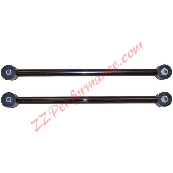

Imp558 Posted April 10, 2014 Report Posted April 10, 2014 Anybody run the ZZP ones? http://shop.zzperformance.com/store/p/617-ZZP-Chromoly-Trailing-Arms.aspx Quote
jman093 Posted April 10, 2014 Report Posted April 10, 2014 Is Dorman still the popular vote? WBS has a boxed arms they sell for $49.99, The current price on Dorman is $12.13 at Rockauto. I'll flip the extra for the WBS arms if they're an improvement. Also, did anybody ever post alignment specs for the Gen II lat link upgrade? http://www.w-body.com/showthread.php/52415-where-to-buy-obtain-gen1-lateral-links Yeah. I'd just get the Dorman. The WBS are probably marked up Dorman's anyway. I wouldn't bother paying for the zzp and I don't know why you'd want a poly bushing on the trailing arm anyway. The reason for gen 2 lateral links is to get 4 rear adjustables and have Matt get 2 of them shortened to the length as the front nonadjustables. Then alignment is whatever you want since camber and toe are both fully and easily adjustable. Quote
