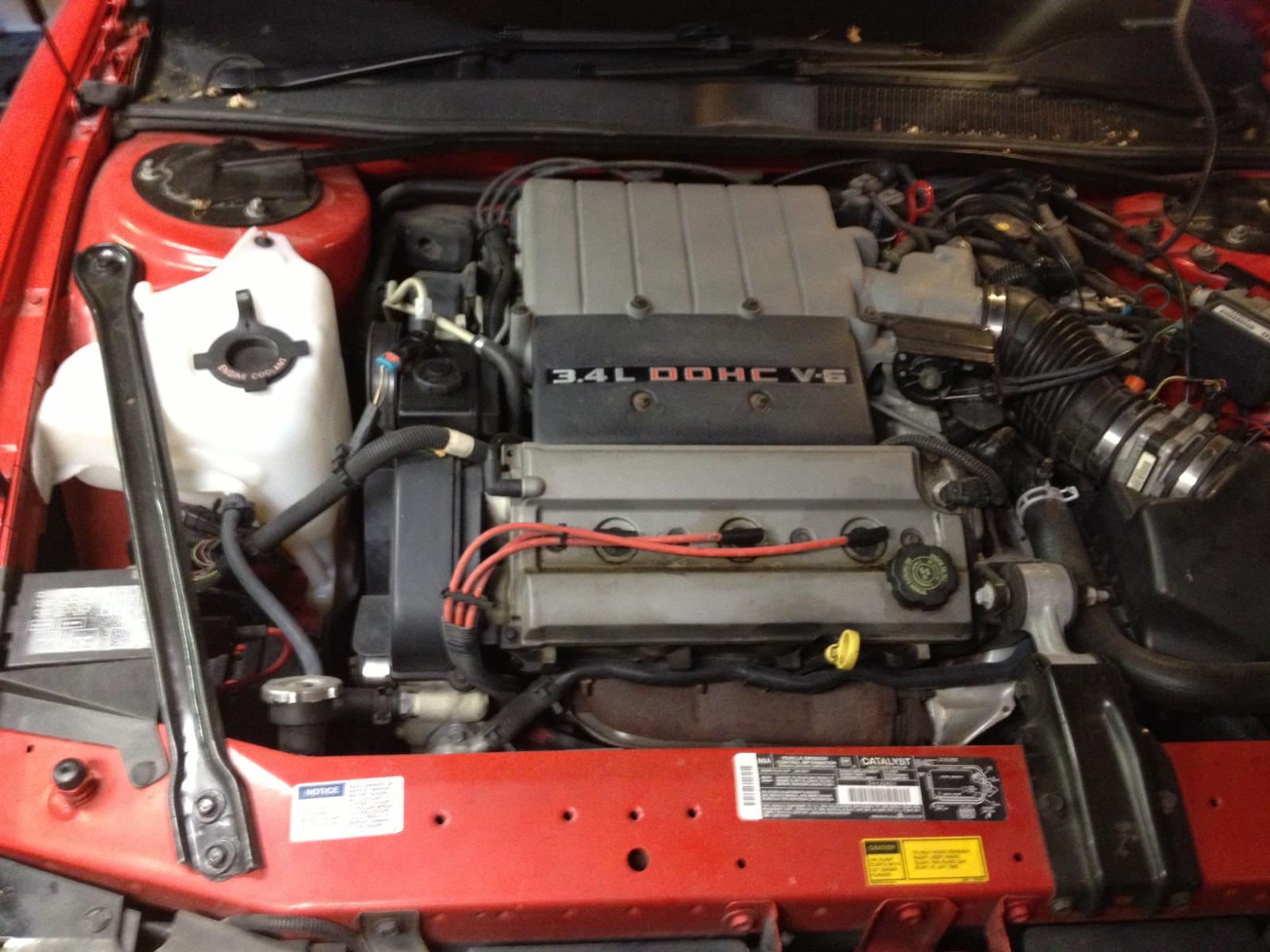

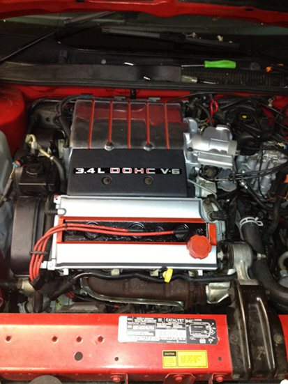

pshojo Posted May 29, 2013 Author Report Posted May 29, 2013 WELL HERE IT IS. Before and after. I need to change the oil, yet just to make sure i didn't get any crap in the engine. before after Quote
pshojo Posted May 29, 2013 Author Report Posted May 29, 2013 wish i wouldn't have cut anything, i'm so nervous about ending up getting any metal shavings in engine. After shaving the end I noticed I didn't have the distributor plug bolt in. I really hope nothing got in there. Might be looking at engine rebuild in 4 months Quote
