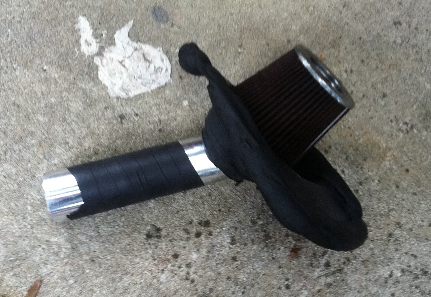

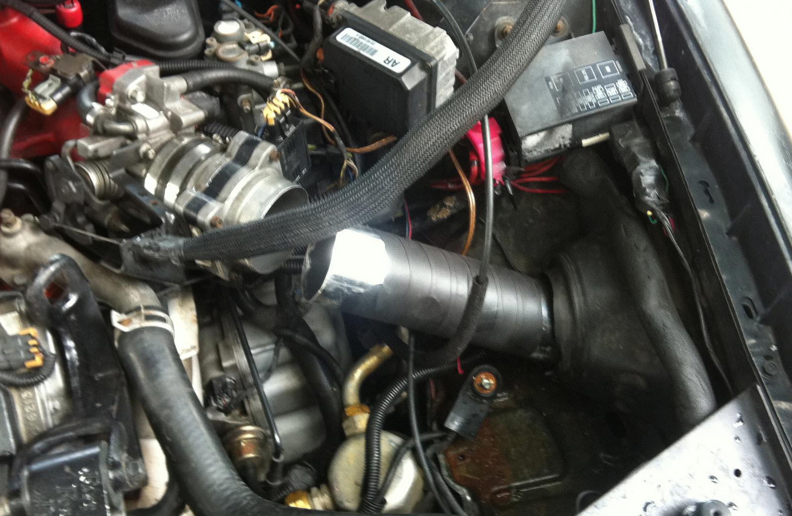

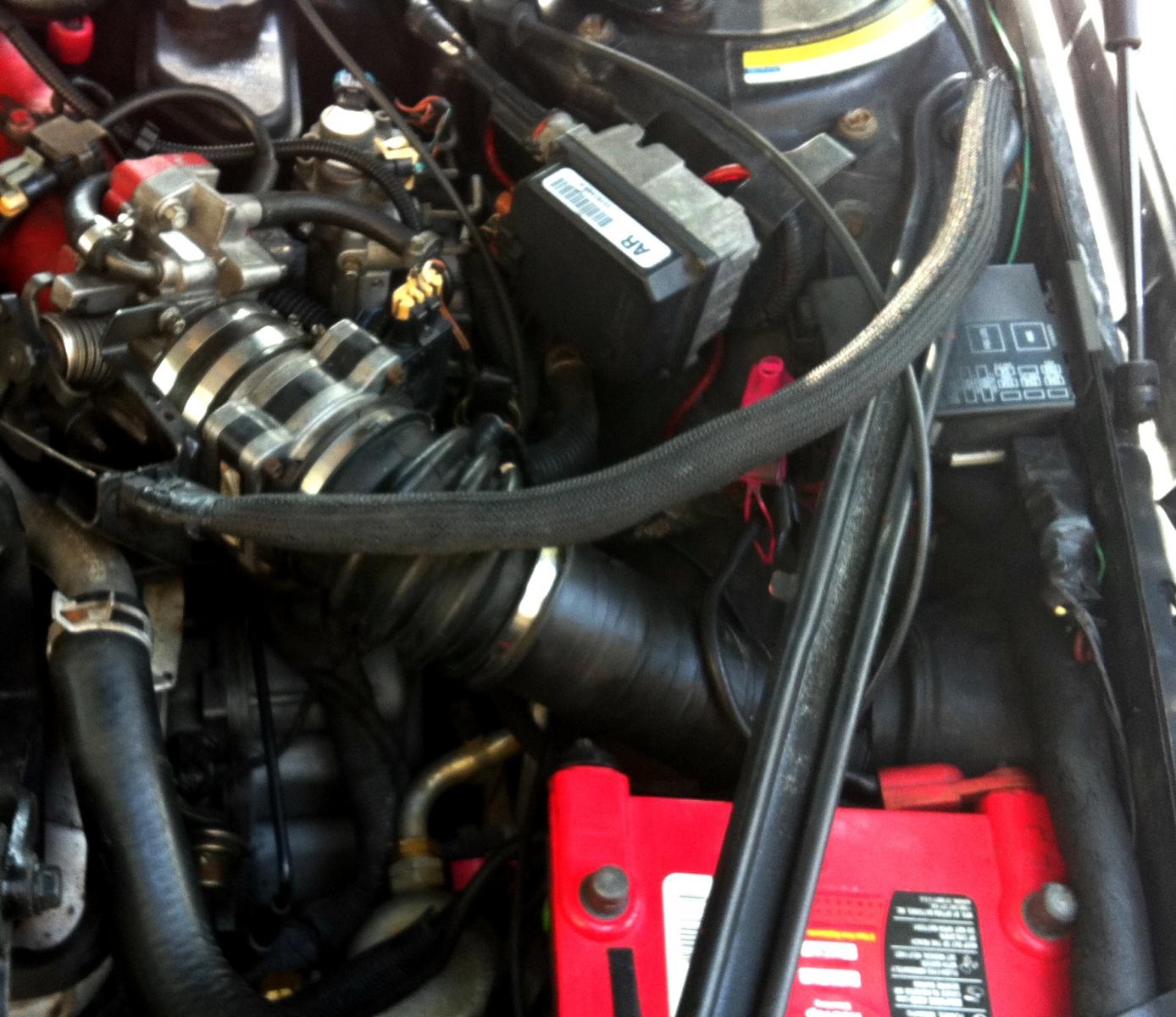

jake91 Posted May 14, 2013 Report Posted May 14, 2013 Move the battery over and get a aftermarket tie down then route the piping around the battery. This pipe I have here I bought one strait, and one ubend it was cheapo turbo piping on eBay, and I made 2 intakes out of it of $40. I saw no mpg change and a bit better throttle response, but it sounded awesome Quote
3800_LTZ Posted May 14, 2013 Report Posted May 14, 2013 (edited) @Jake91: Quick question, where is your washer fluid reservoir? my 1999 Lumina has a similar layout, I am in the process of a Top swap and need to figure out how to get a FWI. but both the battery and the washer fluid tank are in the way. Edited May 14, 2013 by 3800_LTZ Quote
Psych0matt Posted May 14, 2013 Report Posted May 14, 2013 Hey Jake, also, the horns are there, did you relocate them? Quote

jake91 Posted May 14, 2013 Report Posted May 14, 2013 3800 I took the washer fluid take out it leaked and the pump was burn out Matt I didn't run it deep in the fender it pretty much sat right in behind the battery above the horns Sent from my iPhone using Tapatalk Quote
jman093 Posted May 14, 2013 Report Posted May 14, 2013 @Jake91: Quick question, where is your washer fluid reservoir? my 1999 Lumina has a similar layout, I am in the process of a Top swap and need to figure out how to get a FWI. but both the battery and the washer fluid tank are in the way. Mine had a washer reservoir from a 4th gen F-body installed which goes behind the bumper in the center of the car, and the horns were also relocated down around the foglights somewhere, IIRC. Unlike Jake's, mine fit fine without any battery relocation/modifcation. My CAI was installed by Paul (pwmin) before I bought the car. Quote

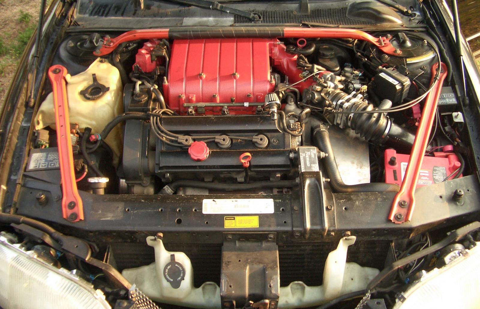

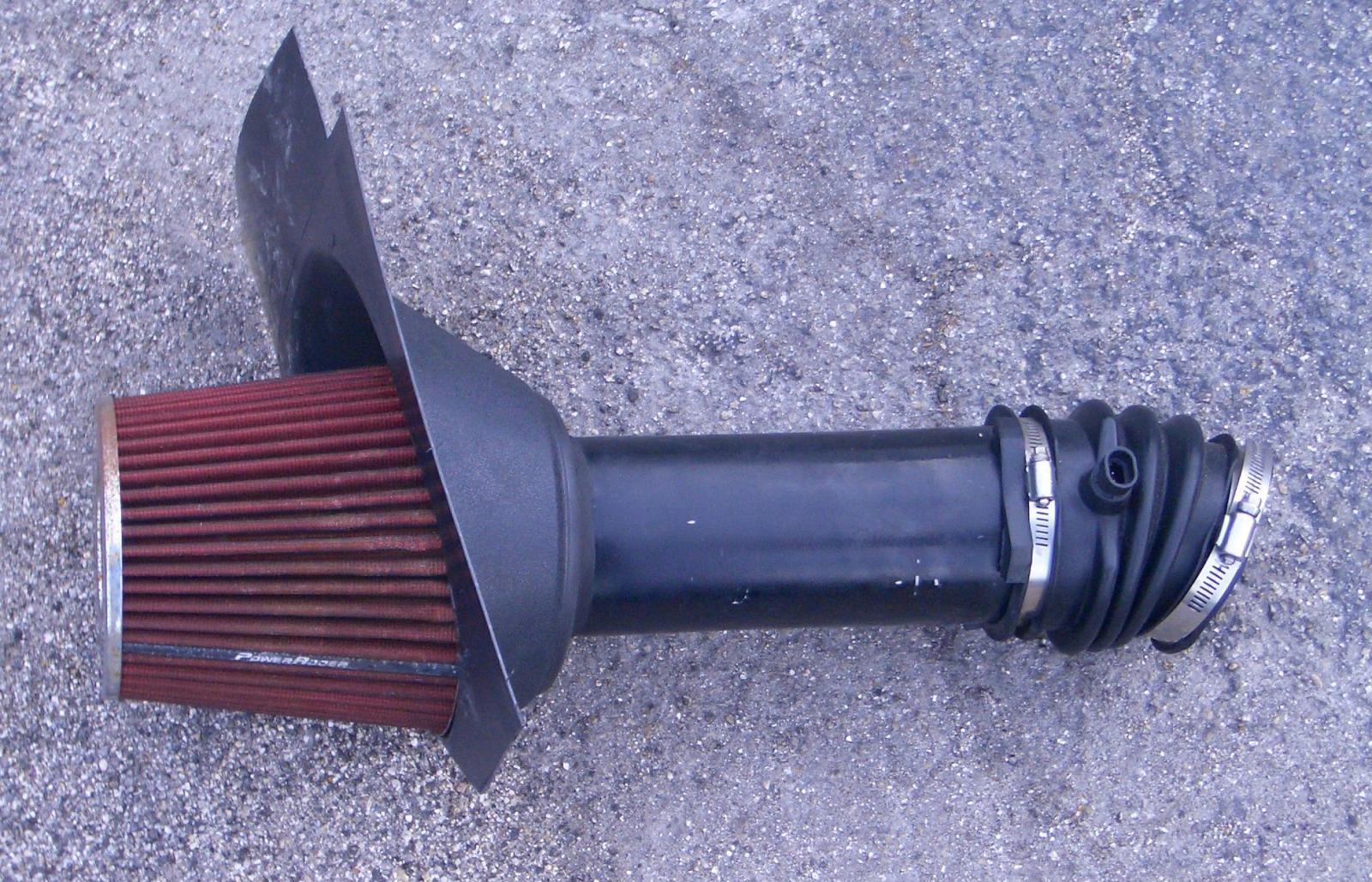

z34Phoenix Posted May 14, 2013 Report Posted May 14, 2013 Here is what i did with my 96 Z when i had my DOHC. same intake also works now with my 3800. just need a 1.5 foot section of 3" pipe/pvc, air filter and rubber adapter. the heat shield was from home depot and was a roof seal. Quote

z34Phoenix Posted May 15, 2013 Report Posted May 15, 2013 Thank you! I started years ago with a HAI w/ heat shield and think I actually lost power. Next I tried one made out of dryer tube with te filter low in te fender. Ba idea as I almost hydro locked the engine on a bad rainy fl day. Then came this design. I got the heat shield idea from the GrandPrix crowd. Quote
