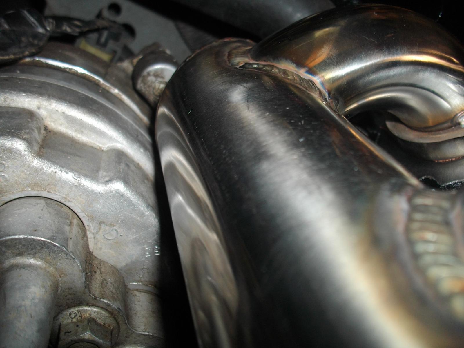

3800_LTZ Posted May 9, 2013 Report Posted May 9, 2013 Hello I am in the process od a top swap on my 1999 Lumina LTZ 3800. (I'll post lots of details and pics on this later! ) I have finished the front head and have installed it. I purchased a ZZP front power log. When installing it, I ran into a problem with the A/C compressor being in the way. I unbolted the compressor bracket, and the bolts on the back of the AC compressor and rotated it towards the front of the car so I could install the plog. The compressor won't fit into place with the plog installed. Has anyone else had this issue, or have any suggestions on this? fabricate a new bracket to move the compressor? AC delete is not an option, 100+ degree summers... Thanks in advance for your input or thoughts... Quote

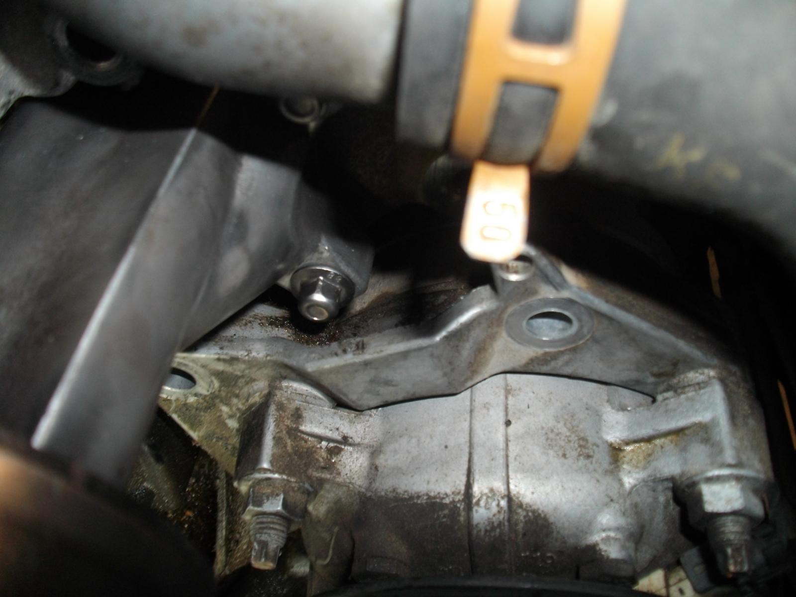

3800_LTZ Posted May 12, 2013 Author Report Posted May 12, 2013 the supercharger idler pulley mount does not fit properly on an L36, as in the third bolt cannot be installed with the A/C bracket attached. That is exactly the problem I had, I ended up rotating the AC forward just so I could get that 3rd bolt in. Then I put it back in place, until I had to move it again to get the plog in. I have tried to find the GM part number for the compressor bracket for the L36 vs the L67 but I haven't had much luck. I am going to try a salvage yard, but the l67's are rare there... not a lot of compressor brackets for the 3.8 on ebay either. here is one I found on ebay, looks the same as the one I took off though... http://www.ebay.com/itm/00-01-02-03-IMPALA-GRAND-PRIX-MONTE-CARLO-REGAL-AIR-COMPRESSOR-BRACKET-3-8L-ONLY-/281081684856?pt=Motors_Car_Truck_Parts_Accessories&fits=Model%3AIntrigue&hash=item4171c62378&vxp=mtr This is the 3rd bolt of the idler pulley, as you can see the AC compressor was moved to access it. Quote
3800_LTZ Posted May 13, 2013 Author Report Posted May 13, 2013 I did find an L67 at the salvage yard, took the front and rear brackets from the compressor. It is a different bracket, and once I installed it, the plog and the compressor both fit ok, though the clearance was tight Thanks for the input on this. Quote
