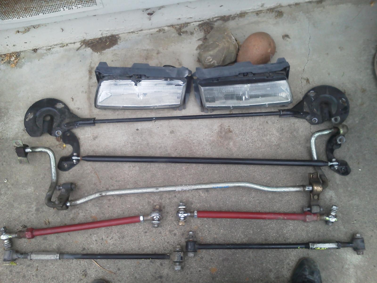

AliasCT Posted May 7, 2013 Author Report Posted May 7, 2013 (edited) As an update; whatever struts are there, after a lot of pain and suffering I decided not to pull them. They don't have a black knob on them (like I've seen in pictures of Koni's), just a small metal tab sticking out of the top of the strut. Since the car wasn't on the ground, the strut was out of alignment (sticking out and down from the top of the strut mount) which made it hard to get to the front lower strut cap. It also had a different hole pattern than I had a tool for; it had two holes, one right across from the other, and the tool I have has a 3 hole pattern and a 4 hole pattern. Didn't feel like hacking my tool just to get the strut, especially since I couldn't get to it right anyway. WHAT DID I GET THEN? THIS. Clear headlights, FSTB, RSTB, rear sway bar (I already have the 34mm front), front and rear lateral bars (I have both in that aftermarket red, but the rear set are bent from the tow truck. Just grabbed the 2nd gen rear lateral bars, since those can adjust down to 1g size). I also grabbed the cross drilled rotors from the car (not pictured). If anyone in the area really wants to go take a look at the struts, it's in the Rancho Cordova (CA) main yard. 1990 GP 4 door, grey. Edited May 7, 2013 by AliasCT Typos Quote
