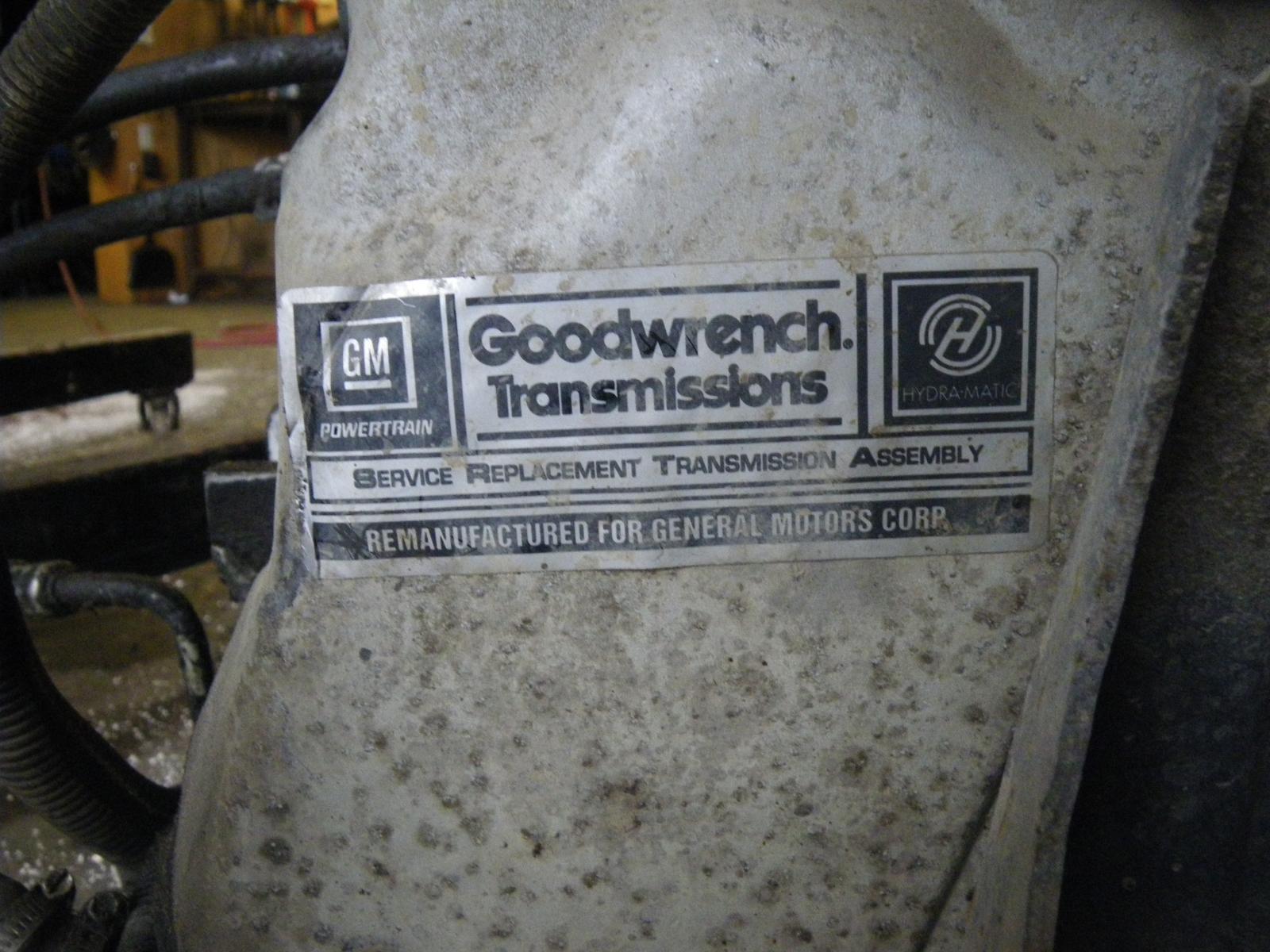

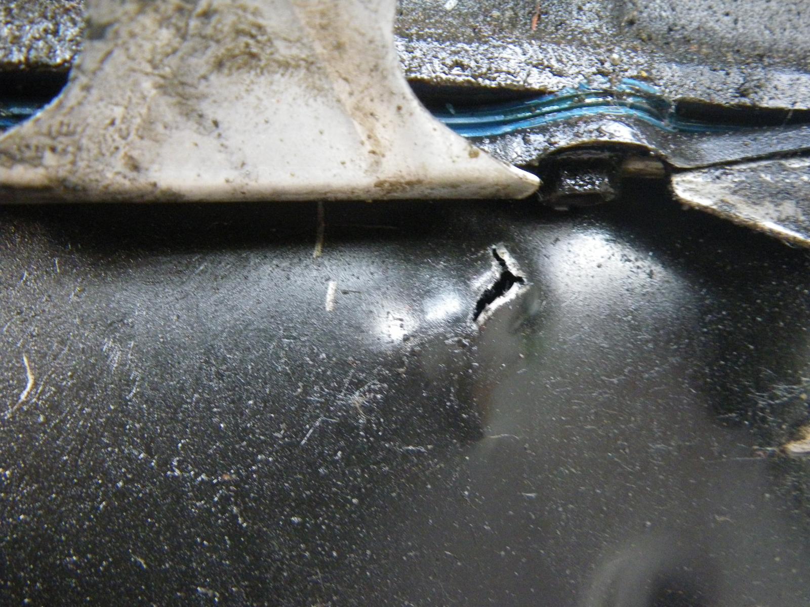

I did find a promising sticker when I took the other car apart. And check out the oil pan on the parts car engine after I blew the motor testing the tranny.
All together there are 4 spots that the pan is pushed out. Looks like the block isn't crack but I haven't pulled the pan, that will be interesting.

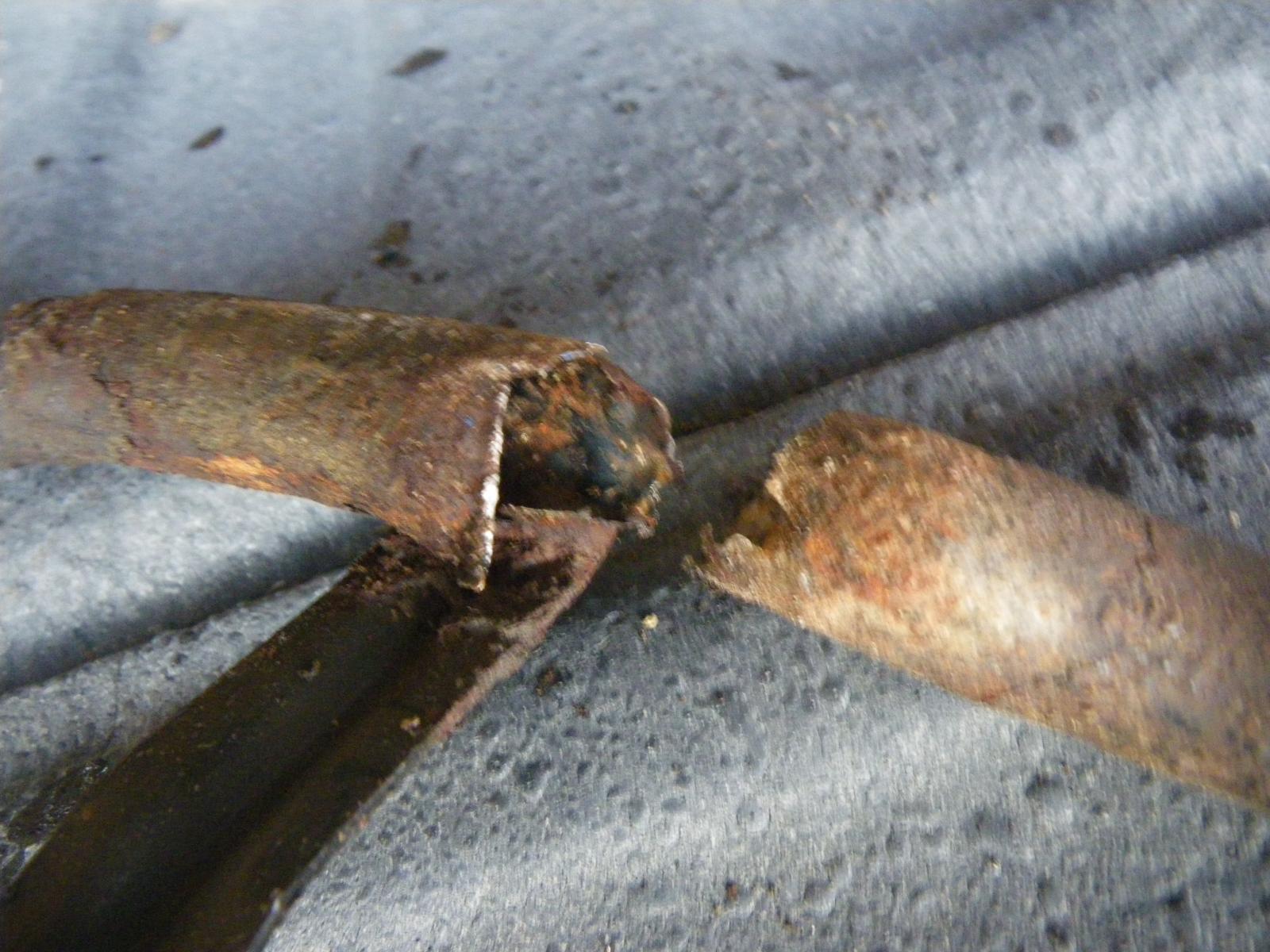

The hang up during the swap was the heater return tube along the pass side uni-body. We bit rusty and the parts car had been replaced with household 3/4" pipe? and chuncks of hose.
I cut the tube where the rust started about 3" away from the 90 at the firewall and ran 5/8" heater hose from there to the connection on the pump. I also replaced the high pressure powersteering hose while i was in there due to a pin hole leak.

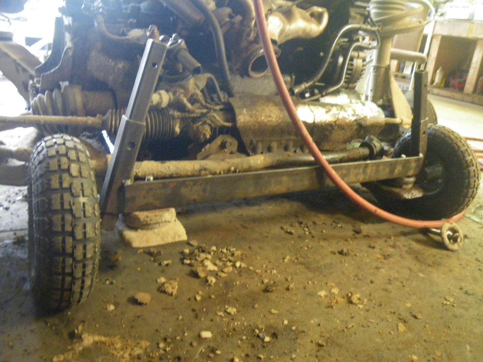

Also, here is the cradle I made to roll the subframes out from under the car. Just use a floor jack on the front and lift the car and you roll it out.
