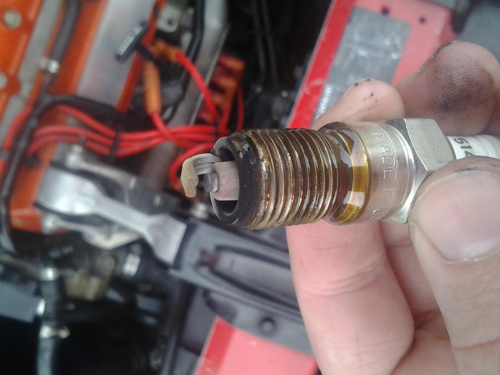

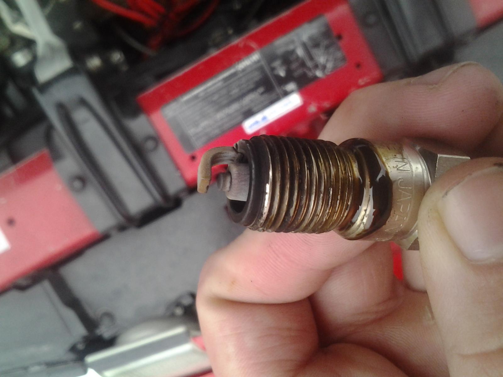

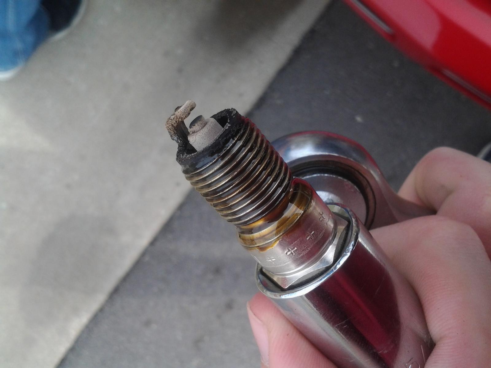

redgrandprix Posted April 6, 2013 Report Posted April 6, 2013 (edited) i checked my front 3 sparkplugs and i feel that that is a decent amount of oil on them, the last one looks a little burnt, they around 9 months old, so now i'm thinking change every 6 months and what the best plugs to use are, these are accel u grooves Edited April 6, 2013 by redgrandprix Quote
RobertISaar Posted April 6, 2013 Report Posted April 6, 2013 that last one came from the cylinder closest to the driver's side? Quote
19Cutlass94 Posted April 7, 2013 Report Posted April 7, 2013 Looks like they are started to get deposits on them. Are you using any additives or just 93 octane fuel? Sent from my iPhone in some random spot of Texas. Quote
redgrandprix Posted April 7, 2013 Author Report Posted April 7, 2013 that last one came from the cylinder closest to the driver's side? yes the last plug came from the side closest to the turbo or driver's side no additives in the fuel but i did put lucas oil treatment stuff in the oil and i run 91 octane, only other option around here is 92 octane or 92 octane with no ethanol (no ethanol burns quicker i think) Quote
RobertISaar Posted April 8, 2013 Report Posted April 8, 2013 cylinders 5 and 6 usually will look the worst... it's just how all 60V6s are. anyways, looks like ash buildup, not the greatest thing to see on a plug, but it isn't too bad. you're either sucking up a lot of oil(perhaps through the PCV) or your fuel is a problem. Quote
