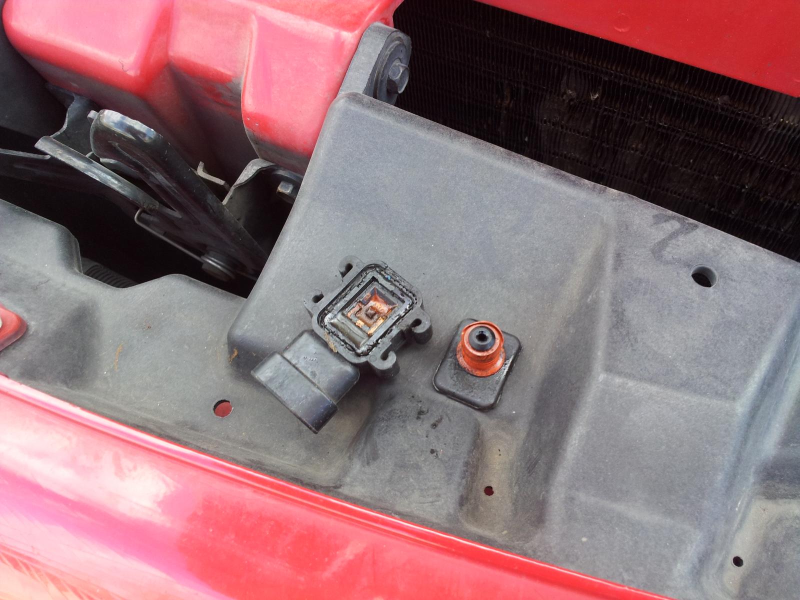

but yeah checked the map sensor it came off in 2 pieces... post-7290-143689126663_thumb.jpgDidn't use any force at all to get it off soon as I unclipped the top it came right apart..
and the maf wires were caked with oil.( no pic ) so I hit them with some throttlebody cleaner from a good distance away so as not to damage them. picked up a map from the local yard for 5 beans and she runs perfect now.
Knock on wood.. Im surprised My wife never mentioned that the car was a nutless bastard when it got warm out.
