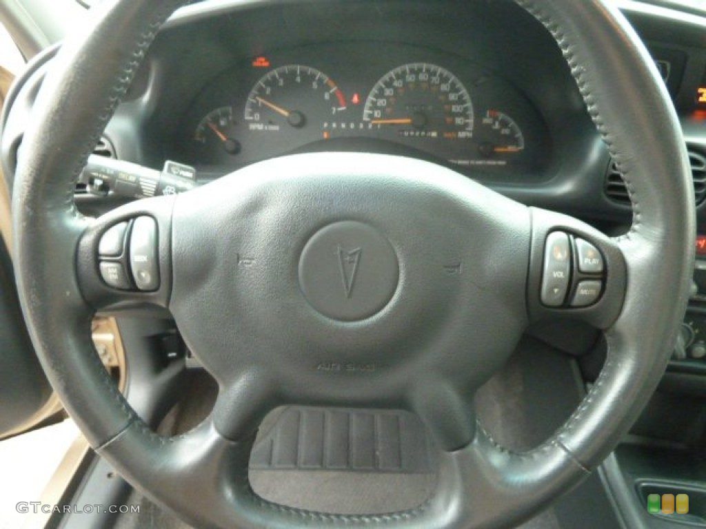

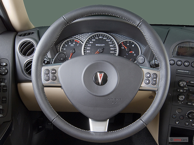

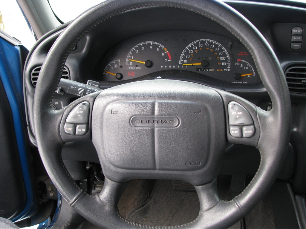

KAlsteen Posted March 27, 2013 Report Posted March 27, 2013 I pulled out my steering wheel radio controls to fix the lights on them and now they won't go all the way back in. So since I have to pull the steering wheel off to fix the cruise control wires I was thinking about just buying a different steering wheel so my buttons aren't popping out and annoying me. So that got me wondering if either of these other steering wheels work in my car and retain the radio controls and air bag functionality? Current Steering Wheel Steering Wheel 1 Steering Wheel 2 Quote
no1kicker Posted March 27, 2013 Report Posted March 27, 2013 I know that steering wheel # 2 will keep the radio control functions. # 3 probably will too but I'm not sure. Some on clubgp have said the 01+ steering wheels have different splines. I would grab the whole column just to be safe. Quote
ManicMechanic Posted March 28, 2013 Report Posted March 28, 2013 Neither the 2nd gen W GP column nor the 3rd gen W GP column will fit. I'm sure the wheel from the 2nd gen will fit the 1st gen. Quote

KAlsteen Posted March 28, 2013 Author Report Posted March 28, 2013 Yes, that is. I was lazy and instead of taking a picture of my steering wheel I just googled one that had the same steering wheel as mine. Quote
WhatTheFehl Posted March 28, 2013 Report Posted March 28, 2013 But that isn't the same wheel. Your wheel should look like this: At the very least you will want to grab buttons from a 2000 GP. They don't peal and they are LEDs so they don't burn out. You will need to break off a small clip to fit them in though. Quote

Crazy K Posted April 4, 2013 Report Posted April 4, 2013 My 96 GP has a 97 GP steering wheel and airbag, that is the way to go. Only 97 will interswap with 94-96 as it is fully compatible. 98+ airbags are two stage and are a no go. the first pic is actually of the 97-99 style airbag, and though they appear the same, they are different between 97 and 98-99. Quote
WhatTheFehl Posted April 4, 2013 Report Posted April 4, 2013 Am I the only weirdo who vastly prefers the looks of the 94-96 wheel? I just like the design better, especially having the Pontiac arrow head instead of the word Pontiac. Quote
RareGMFan Posted April 4, 2013 Report Posted April 4, 2013 Am I the only weirdo who vastly prefers the looks of the 94-96 wheel? I just like the design better, especially having the Pontiac arrow head instead of the word Pontiac. I prefer the cleaner/sleeker air bag containment of the newer style steering wheels, though I'd prefer no air bag at all and a steering wheel cluttered with radio controls if I had my choice. I like the '01 - '03 design (2nd pic) the most out of all the air bag equipped GP wheels. Keep forgetting to look into whether or not you can put the Bonneville GXP wheel on the GP. Quote
