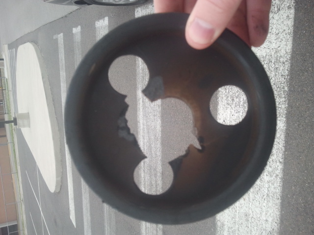

J.r. Patton Posted March 23, 2013 Report Posted March 23, 2013 have a 95 cutlass supreme 3.4 DOHC. The power steering pulley has broke off the pump. How difficult is to replace with a new one? Pulley its self is what broke. The center failed. Whats needed to do this and the step? Quote

J.r. Patton Posted March 23, 2013 Author Report Posted March 23, 2013 The pump itself is brand new! center broke out of the pulley Quote

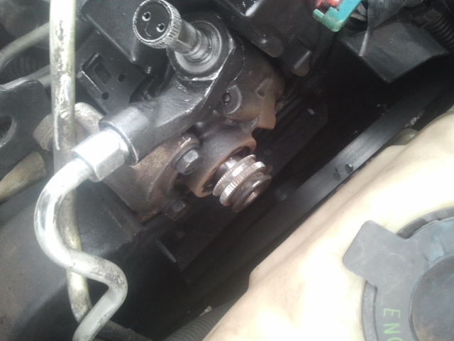

J.r. Patton Posted March 23, 2013 Author Report Posted March 23, 2013 I do believe getting whats left on the pump off maybe pose a bit of a hassle . Quote
J.r. Patton Posted March 23, 2013 Author Report Posted March 23, 2013 So do I have to removed the pump from the car? Or can it be done with it on the car? Quote
Schurkey Posted March 23, 2013 Report Posted March 23, 2013 [ATTACH=CONFIG]12194[/ATTACH][ATTACH=CONFIG]12195[/ATTACH] I do believe getting whats left on the pump off maybe pose a bit of a hassle . Makes me wonder what the screwup was the previous time the pulley was installed. (i.e., installed with a hammer???) Automatic belt tension, can't have failed from belt stress. I'd say that's an unusual failure. Inspect EVERYTHING when you repair it. Quote
J.r. Patton Posted March 23, 2013 Author Report Posted March 23, 2013 I do believe that the "mechanic" I used did something wrong which lead to the failure. Quote
95LQ1VERT Posted March 23, 2013 Report Posted March 23, 2013 If needed to you can take it out for better access its only a few bolts and a couple lines to disconnect. Quote
Galaxie500XL Posted March 24, 2013 Report Posted March 24, 2013 I have had one break before...the pulley itself is some sort of plastic. I remember it being a big pain to pull that little piece off, because it deformed when I used the tool on it, and the "ear" the puller grabs broke off. I ultimately ended up using a dremel with a cutoff wheel, and cutting a slot in the ring, then took a flat-bladed screwdriver to spread the gap I made, to get it off the shaft. Unfortunately, that meant I put a groove in the shaft where the cutoff wheel cut through, but the new pulley went on without any issues, and I've had no further trouble. Easy enough to pull the pump if you need more room, 3 bolts...on the LQ1, you sort of have to "rotate" the pump out, rolling the top of the pump toward the front of the car. Quote
Schurkey Posted March 24, 2013 Report Posted March 24, 2013 I ultimately ended up using a dremel with a cutoff wheel, and cutting a slot in the ring, then took a flat-bladed screwdriver to spread the gap I made, to get it off the shaft. Unfortunately, that meant I put a groove in the shaft where the cutoff wheel cut through Grind MOST of the way through the hub, then crack the remainder with a hammer and chisel. Best to support the other side of the hub, so you don't damage the pump shaft and bearings with the hammer impact(s). Quote
Galaxie500XL Posted March 24, 2013 Report Posted March 24, 2013 A much better method..unfortunately, all I had access to at the time was the Dremel. Grind MOST of the way through the hub, then crack the remainder with a hammer and chisel. Best to support the other side of the hub, so you don't damage the pump shaft and bearings with the hammer impact(s). Quote
