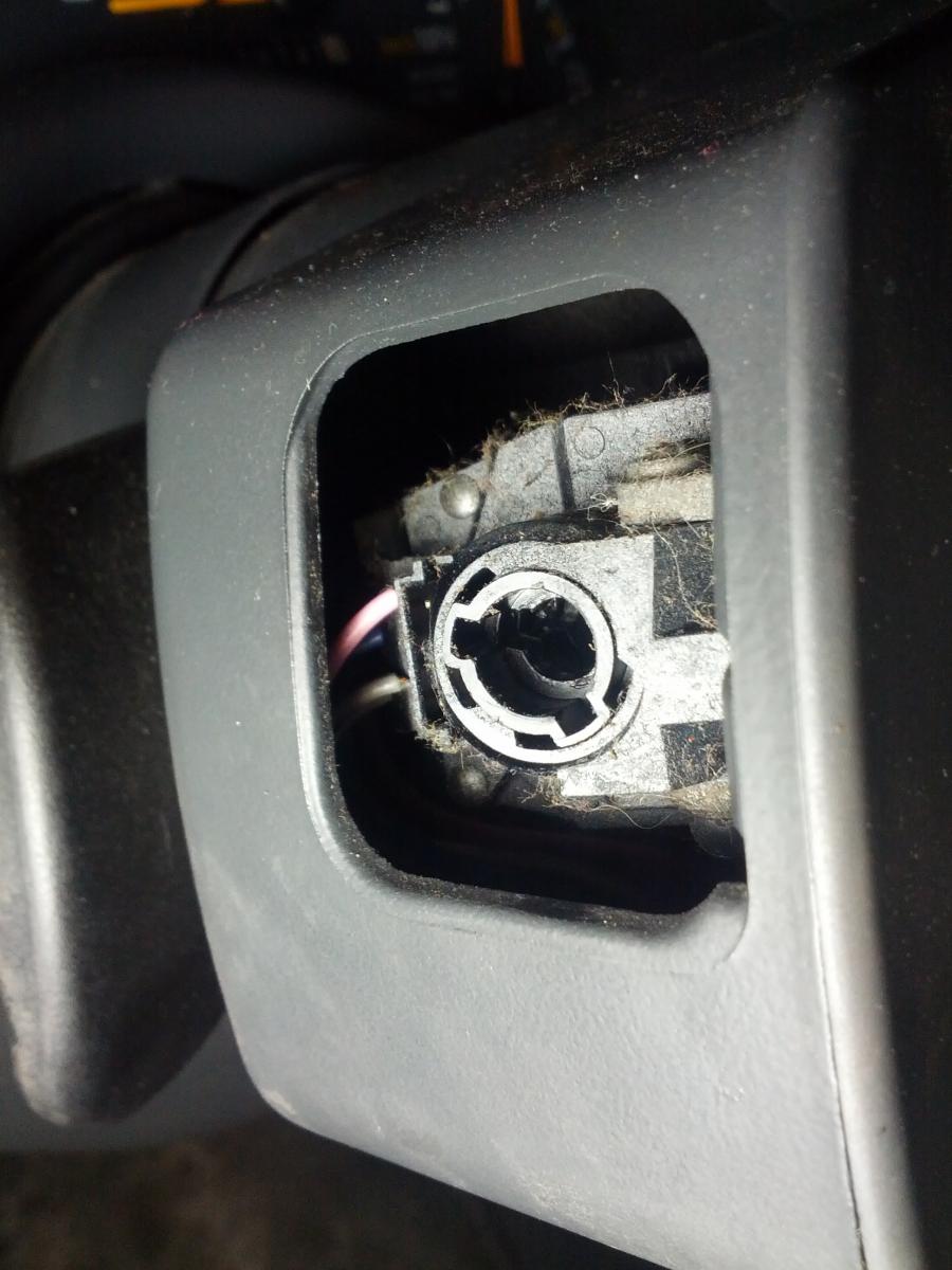

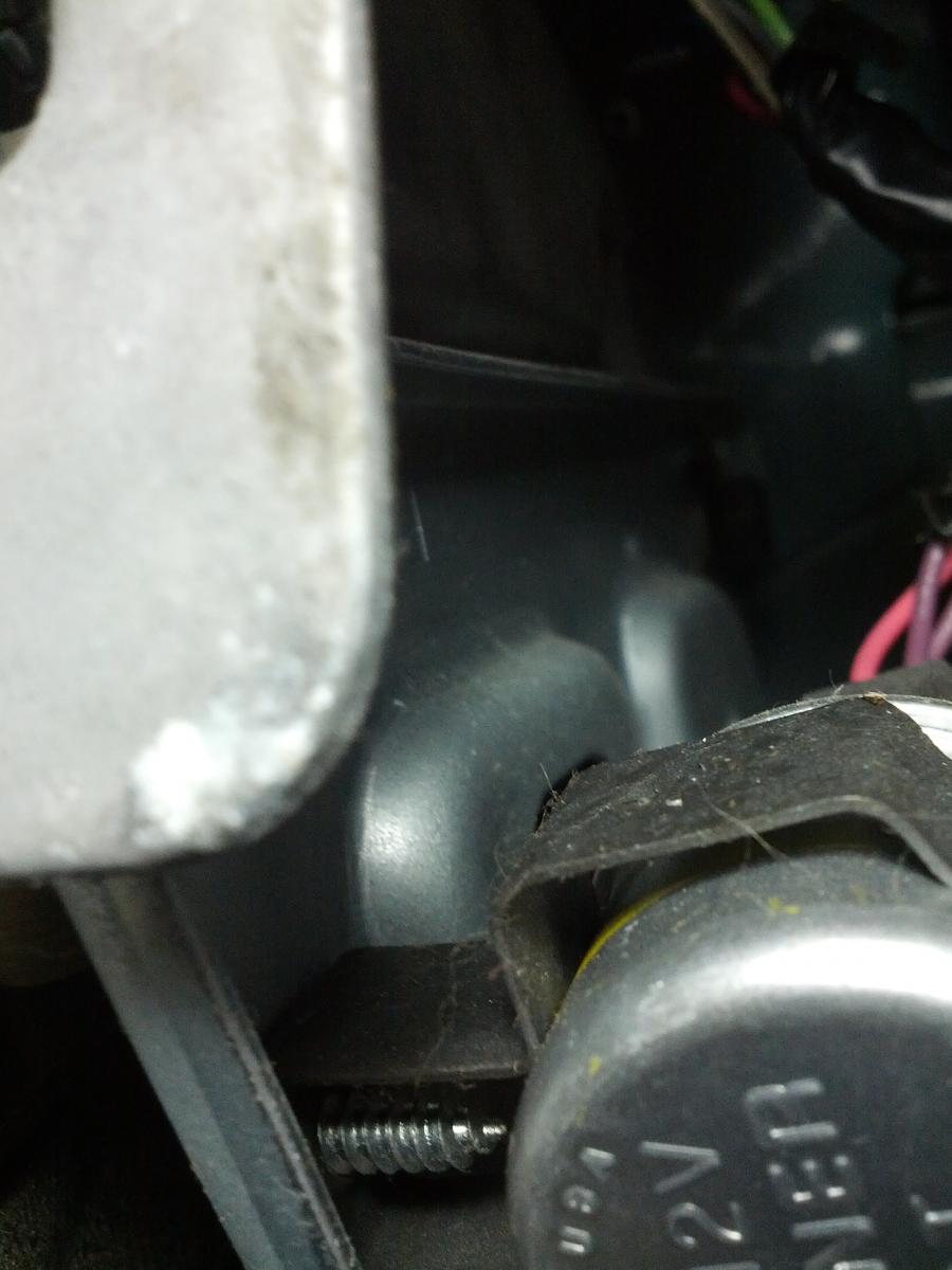

KAlsteen Posted March 15, 2013 Author Report Posted March 15, 2013 Ok, pulled the blinker out to see if the clip was loose, which it wasn't but there seems to be some wires that aren't connected to anything. Are these for the cruise? Is there directions somewhere on how to take the plastic off and repair the wires, or would it be easier to just get a new part from the junkyard? Quote
Schurkey Posted March 16, 2013 Report Posted March 16, 2013 [ATTACH=CONFIG]12139[/ATTACH] Ok, pulled the blinker out to see if the clip was loose, which it wasn't but there seems to be some wires that aren't connected to anything. Are these for the cruise? Is there directions somewhere on how to take the plastic off and repair the wires, or would it be easier to just get a new part from the junkyard? Did I miss the post where you told us WHAT CAR THIS IS? Every time the cruise control has failed me on my '92 and '93 Luminas, it has been due to defective vacuum hoses either in the brake/ABS area (next to the cruise control transducer) or a failed vacuum hose near the reservoir "ball" screwed to the underside of the fender area just under the battery. It's the same vacuum hose, but I've had multiple problems on the two vehicles where that hose assembly cracks or rubs-through; it kills the vacuum supply to the cruise module located near the brake master cylinder/ABS box. When there is no vacuum to the cruise transducer, it will not engage. Quote
cutlassdude96 Posted March 17, 2013 Report Posted March 17, 2013 Did I miss the post where you told us WHAT CAR THIS IS? Every time the cruise control has failed me on my '92 and '93 Luminas, it has been due to defective vacuum hoses either in the brake/ABS area (next to the cruise control transducer) or a failed vacuum hose near the reservoir "ball" screwed to the underside of the fender area just under the battery. It's the same vacuum hose, but I've had multiple problems on the two vehicles where that hose assembly cracks or rubs-through; it kills the vacuum supply to the cruise module located near the brake master cylinder/ABS box. When there is no vacuum to the cruise transducer, it will not engage. im pretty sure its the car he has listed in his fuelly sig which has the electronic cruise system Quote
ManicMechanic Posted March 17, 2013 Report Posted March 17, 2013 Yes, that is a small connector for the cruise control wiring. Its mate is on the cruise stalk. Quote
alec_b Posted March 26, 2013 Report Posted March 26, 2013 Just had a '96 Monte Carlo in the shop today with inop cruise, turns out the wires in the column are broken. It's actually sold as the "wiper switch", the cruise wiring is built into that. If you want I can tell you which wires to test at the cruise servo, it's the box mounted to your drivers strut town with a cable coming out of it. That will tell you for sure whether it's the cruise module or a wiring/switch issue. Quote
mhildebrand Posted March 26, 2013 Report Posted March 26, 2013 Ok, pulled the blinker out to see if the clip was loose, which it wasn't but there seems to be some wires that aren't connected to anything. Are these for the cruise? Is there directions somewhere on how to take the plastic off and repair the wires, or would it be easier to just get a new part from the junkyard? Yes those are the wires for the cruise control. This weekend I fixed the second broken wire from that plug. What I ended up doing was soldering a 3" piece of wire onto the stalk side wires after cutting the remaining 2 off the plug, then snipped the wires in the column off the other side of the plug and soldered it all together. So really I just eliminated the plug. If you want you can use crimp connectors or some Molex plugs so you still have plugs to make it easier when needing to open up the column. Quote
