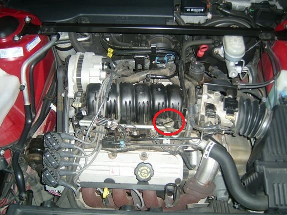

alec_b Posted March 10, 2013 Report Posted March 10, 2013 Were those your data points idling? Was it warmed up? Your LTFT shouldn't be anywhere close to -13%. I'd be looking more for +/- 5% tops. With it running at -13% means you're running way too rich. Possible causes: false MAF readings, stuck injector(s), too much fuel pressure. However, the only one really likely out of those is the MAF. Injectors rarely go bad in these cars. I didn't think to ask, have you pulled the vacuum line of the fuel pressure regulator? These are NOTORIOUS for going bad and can cause hard starts, sluggish running off idle, and basically all the issues you're having. Quote

alec_b Posted March 10, 2013 Report Posted March 10, 2013 Fuel trims come in two flavors: Short Term and Long Term. Think of the short term fuel trim (STFT) as being instant adjustments that the PCM makes to the fueling, whereas long term (LTFT) is a "running average" of sorts. If either trim is way positive, the computer is ADDING fuel, compensating for a lean condition (aka vacuum leak or weak fuel pressure). Negative trims mean the computer is REMOVING fuel. That's the reason I say check your fuel pressure regulator. It's much more difficult to have too much fuel than to have too much air. I circled the fuel pressure regulator in red. Pull off the vacuum line and see if there's fuel in the line. If there is, it's bad. Easily swapped with a snap ring pliers and about 5 minutes of your time. Quote

brycefishersprix Posted March 11, 2013 Author Report Posted March 11, 2013 This has been really helpful, now i understand my ft data! Lol now how do i go about checking the regulator? Thank god i have people who understand this car more than the gm dealer here. The sooner i get to mod my prix the better! Quote
alec_b Posted March 11, 2013 Report Posted March 11, 2013 I circled the fuel pressure regulator in red. Pull off the vacuum line and see if there's fuel in the line. If there is, it's bad. Easily swapped with a snap ring pliers and about 5 minutes of your time. There's your instructions Quote
brycefishersprix Posted March 11, 2013 Author Report Posted March 11, 2013 Thanks alec alot. I will post results either tomorrow on my day off or wednesday in the shop on our "shop night." Lol Quote
