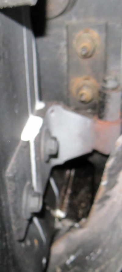

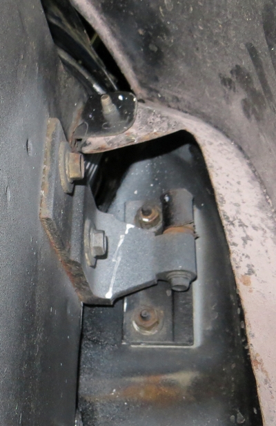

j_mezz Posted February 28, 2013 Author Report Posted February 28, 2013 Excellent info, thanks Ken! I had been contemplating the adjustments from the door bolts, really hadn't thought about tweaking the 'hidden' ones. The divers side wheel well panel was already off so I got a good look at them. I think the hinges are ok, didn't feel much play when I tried lifting the door. Did get a couple of pics from the wheel well... Top hinge Bottom hinge Quote
GnatGoSplat Posted March 6, 2013 Report Posted March 6, 2013 There was a TSB on this, where the solution was to install newer style hinges. The newer style are a bit beefier. However, adjusting the existing ones would be the easier way to go. You can tell if they are worn by seeing if you can lift up on the door when it's open. I had a helluva time adjusting them, but I put in new hinges so I had to adjust both height and depth. If I had to do that again, I'd probably pick up a door jack. Those doors are really heavy. Quote
