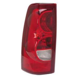

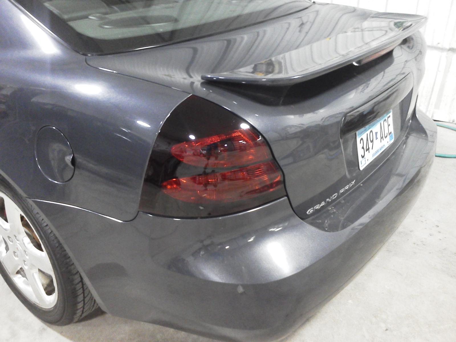

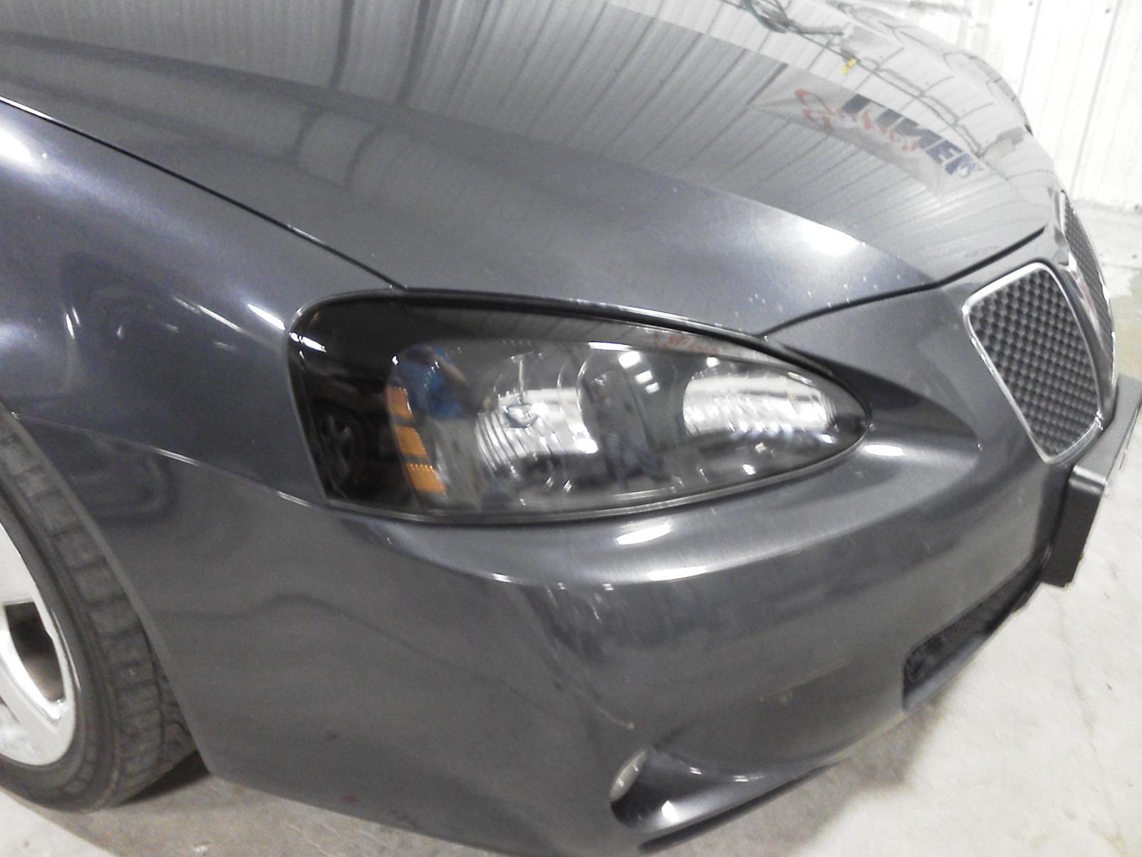

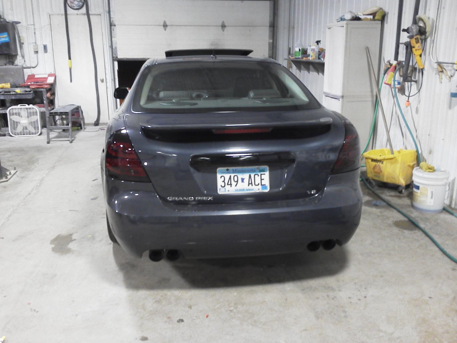

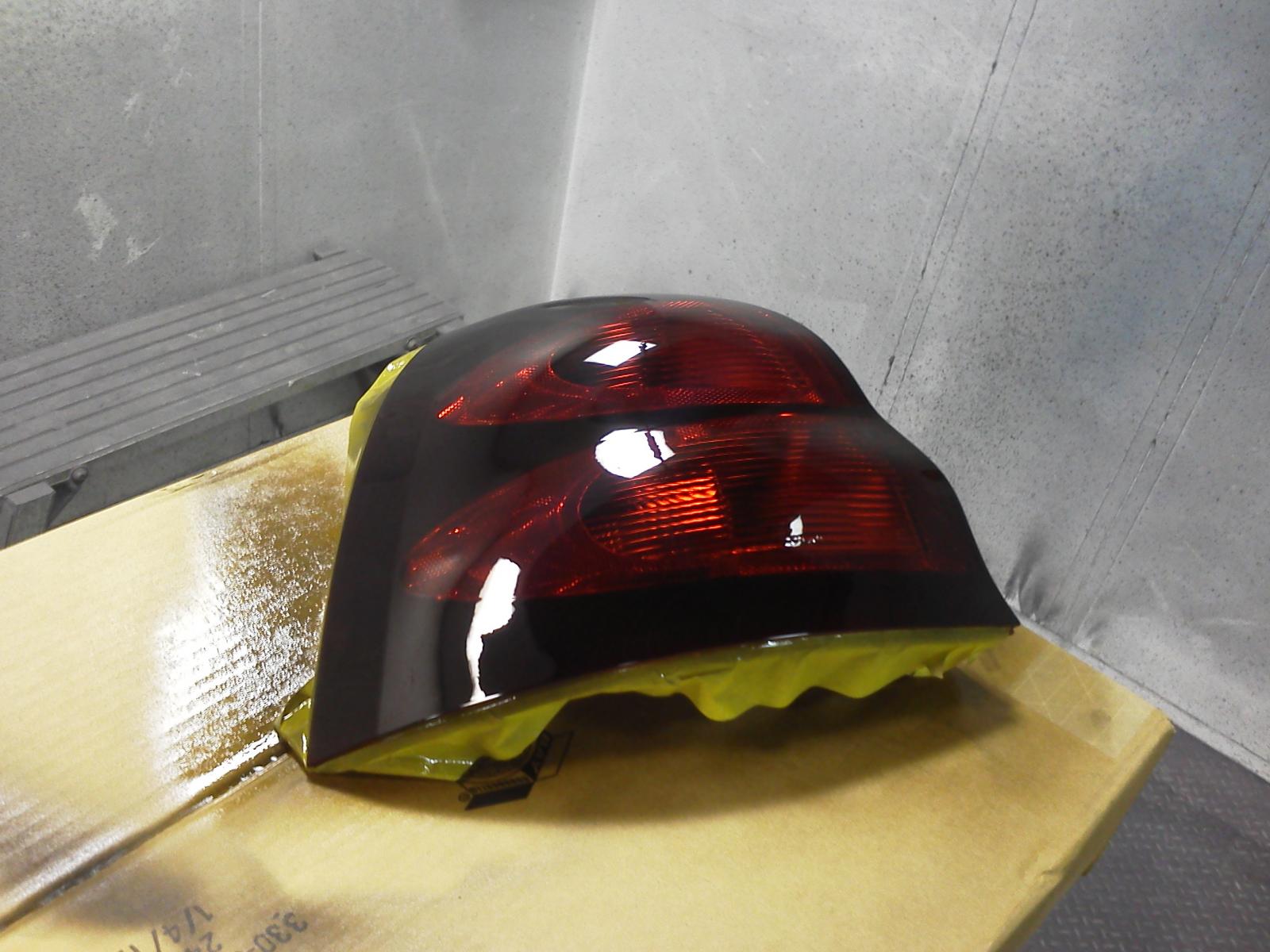

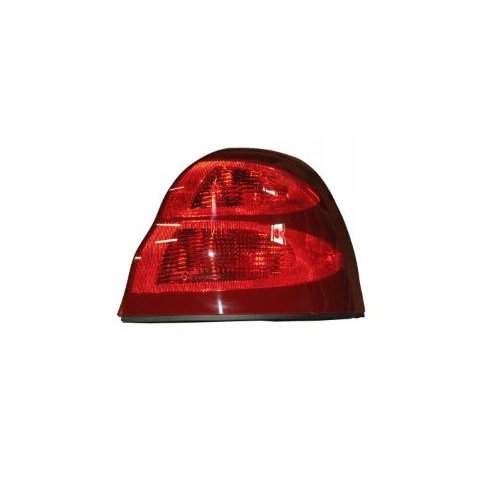

carkhz316 Posted February 20, 2013 Report Posted February 20, 2013 I did these to my brother's GXP last summer. He didn't want to do the typical nightshading effect that blacks it out. He just wanted it to be different. Same with the headlights. This is using PPG clear with a little bit of DCC single stage black mixed in to tint it. I followed this up with a straight clear to protect the tint and the rest of the light. (also a stock GP taillight for comparison) Quote

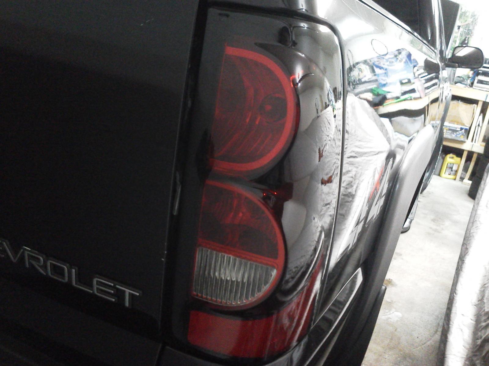

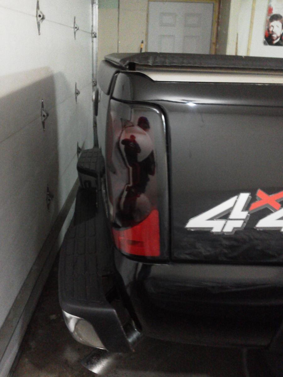

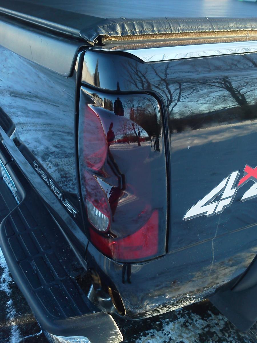

carkhz316 Posted February 20, 2013 Report Posted February 20, 2013 I did a similar idea to my truck as it being an '03, had the red border tails instead of the black like on the 04+. I initially wanted to do just the border, but figured while I was at it, that I would smoke the unlit portions as well: Quote

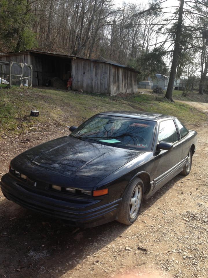

72cuttysupreme Posted February 20, 2013 Author Report Posted February 20, 2013 Pics or it didnt happen:lol: yeah really wanting to see it now. dont be stingy with the Wbody porn. Ive seen what you`re talking about but its custom. Mini-quads? the inside bulb can always be removed and upgraded without replacing the housing. Maybe an industrial place that makes plastic items might be worth a call. A packaging company might have what you`re looking for aswell. Saw a thread on here not long ago with a grey/silver CS with those, but i dont really care for the look. it seamed like swaping them out with a sedan header and lights and tinting them looks better, hey maybe you can use just the lense and tweak it to work:shrug: Here you go man Quote

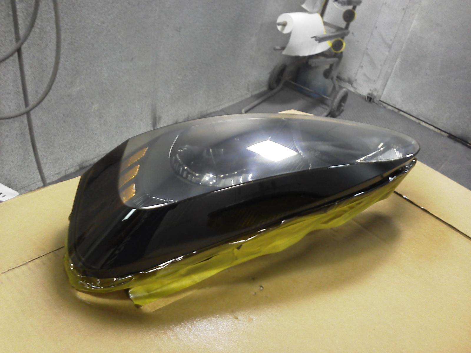

72cuttysupreme Posted February 20, 2013 Author Report Posted February 20, 2013 See my headlights? I'm wanting to put one solid piece of tinted plexi over each side, and cut them to fit. I may apoxy it to the existing bezel that goes around the three lights on each side. Quote
