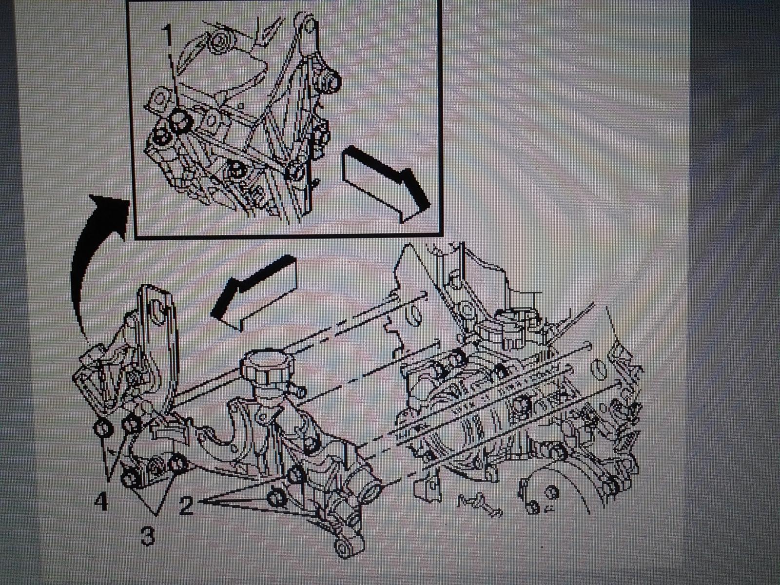

88red4cyl Posted February 18, 2013 Report Posted February 18, 2013 The Monte Carlo has started losing coolant and leaving spots on the ground. I highlighted the areas in red that had the most coolant on them. I tried to check out the weep hole on the water pump, but I can't find the weep hole on this car.. I know that the head gaskets and crossovers leak on this motor, but I'm not sure these areas would be wet with coolant if it were either of those. Possibly the crossover, but it'd have to be spraying coolant out to the side for it to be head gaskets and have the belt area be wet, right? Any ideas? Quote

Night Fury Posted February 19, 2013 Report Posted February 19, 2013 They're just two triangle shaped gaskets, one on the end of each head. The crossover takes the place of the coolant passages in the LIM in other W engines like 3100, 3.1, 2.8, 3.8, L67.... So it's leaking EXTERNALLY instead of into your oil! See, aren't you glad it's designed this way now? So it would be leaking from them, down the sides of the engine... It could be just one that's bad. I'd take the ps pump off, the belt obviously, the plastic stuff in the way(overflow tank over on that side? I don't remember), and the water pump pulley. Then I'm sure you can see what is actually leaking and you won't have wasted any work because pretty much all that will need to come off anyways wether its the crossover or the water pump. Quote
88red4cyl Posted February 19, 2013 Author Report Posted February 19, 2013 They're just two triangle shaped gaskets, one on the end of each head. The crossover takes the place of the coolant passages in the LIM in other W engines like 3100, 3.1, 2.8, 3.8, L67.... So it's leaking EXTERNALLY instead of into your oil! See, aren't you glad it's designed this way now? So it would be leaking from them, down the sides of the engine... It could be just one that's bad. I'd take the ps pump off, the belt obviously, the plastic stuff in the way(overflow tank over on that side? I don't remember), and the water pump pulley. Then I'm sure you can see what is actually leaking and you won't have wasted any work because pretty much all that will need to come off anyways wether its the crossover or the water pump. I'll have to take some pics as well, because I can't find any documented info on the crossover gasket job anywhere with pictures.. From what I've read on g6 forums, don't some of the exhaust manifold bolts need to be taken out to get the crossover off? My Haynes manual doesn't document how to remove it either... Quote
Night Fury Posted February 19, 2013 Report Posted February 19, 2013 I'll look it up, gimmie a bit. I've done it, however I did the headgaskets at that time so the exhaust manis had to come off anyways. Not that that's a huge deal. Anyways, gimmie a minute Quote
Night Fury Posted February 19, 2013 Report Posted February 19, 2013 (edited) Engine Coolant Crossover Pipe Replacement (RPOs LZE/LZ9) Removal Procedure Remove the intake manifold cover(plastic engine cover). Refer to Intake Manifold Cover Replacement or Intake Manifold Cover Replacement . Remove the generator(Alternator). Refer to Generator Replacement . Remove the drive belt idler pulleys(serp belt 'blank' pulleys). Refer to Drive Belt Idler Pulley Replacement or Drive Belt Idler Pulley Replacement . Remove the power steering pump. Refer to Power Steering Pump Replacement . Reposition the coolant recovery reservoir hose clamp at the fill tube fitting(overflow tube clamp). Remove the coolant recovery reservoir hose from the fill tube fitting. Position the hose out of the way.(overflow hose) Reposition the radiator inlet hose clamp at the crossover pipe (3.5L shown, 3.9L similar). (lower rad hose clamp) Remove the radiator inlet hose from the crossover pipe. (lower rad hose) Reposition the thermal bypass hose clamp at the crossover pipe. Remove the thermal bypass hose from the crossover pipe. (small, 6" long bypass hose) Remove the coolant crossover pipe bolts. Remove the coolant crossover pipe. Edited February 19, 2013 by Night Fury Quote

88red4cyl Posted February 19, 2013 Author Report Posted February 19, 2013 I think my Haynes manual covers the ps pump and alt.. Is the picture showing a bolt on the back side of the head? Quote
Night Fury Posted February 19, 2013 Report Posted February 19, 2013 Yeah bolt #1, IIRC it's not very long nor overly hard to get at Quote
